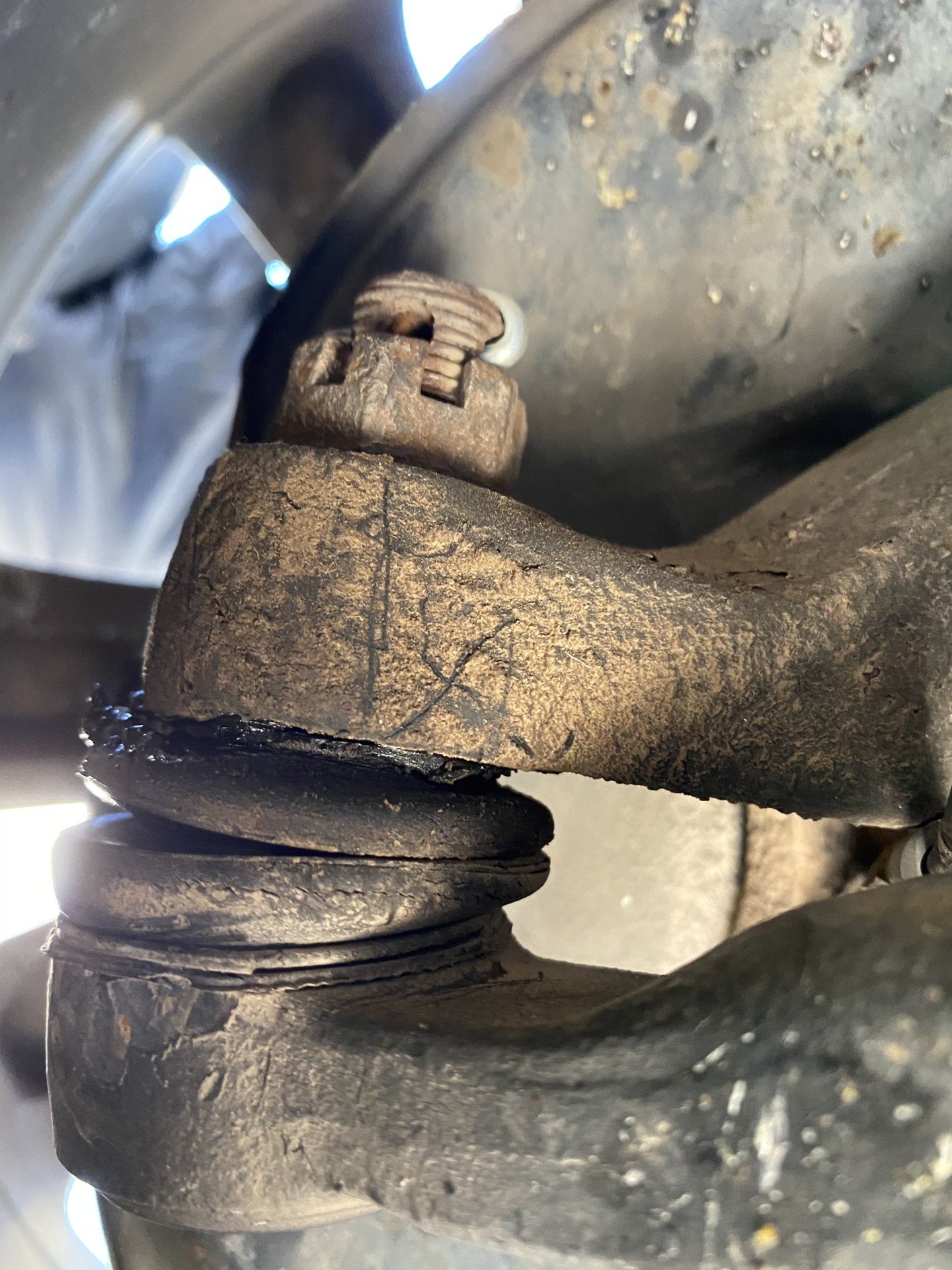

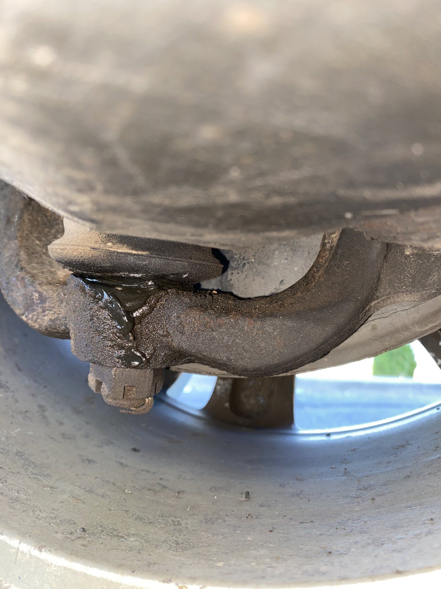

1) I noticed my passenger lower ball joint and tie rod end boots were leaking grease. So I injected grease and patched with silicone. Patches held up but grease leaking out again from top/bottom of boots.

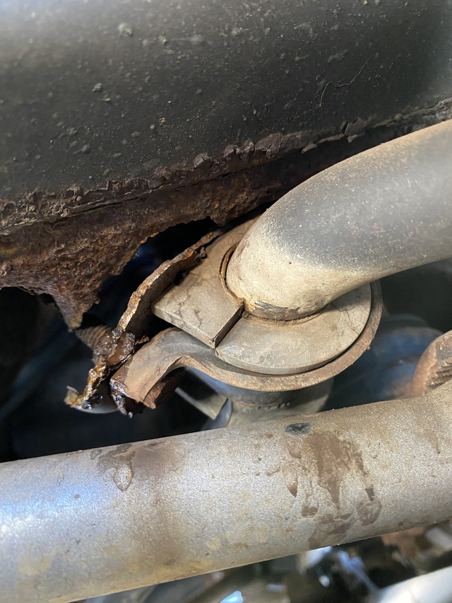

2) front passenger sway bar bracket sheared off the frame (I just had the sway bar links and bushings replaced)

So, I’m thinking I replace the lower balls and tie rod ends. Is it worth replacing the steering rack? I haven’t seen any leaks but I haven’t dropped the skid plates. I put Lucas leak stop in PS reservoir and after driving home about 1500 miles the 9/3 o’clock resistance seems gone but the steering might feel a little labored overall. I couldn’t see much play on lower balls with the tire wiggle test and with putting a pry bar under the tire. I’m assuming most of the noise is coming from my sheared sway bar bracket knocking against the frame and the torsion bar. Any reason to replace upper control arms or bushings??

I just did LBJ's, make sure you have a 2 and 1/8" sleeve to press in the new lbj's. Might as well add new diff bushings to your list of work. When they go bad they can contribute to clunks and thunks...Get new extended sway bar links if you're lifted..
Looks like you have corrosion also causing things to fail. I would inspect frame areas to see if there ar some potential failure points.
Not sure when you acquired your LX and your history with it, but at that mileage it sounds like the trip may have exposed the wear on the LBJs (perhaps UCAs as well) and tie rod ends (inners and outers) as you mentioned. Steering rack bushings may be a culprit as well. Check Cruiser outfitters for your needs and they'll hook you up. Good news is it brought you back home safe, sounds like quite the journey.:cheers:
