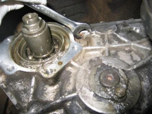

Has anybody here had a leak from the TFR housing or nose cone as I read it is commonly called? I originally thought the output shaft seal was the explanation for the gear oil flung all over everything but after replacing it I still have puddles every where I park. Chicago took a look (thanks) and suggested that my leak is coming from the TFR Ext housing. I am not finding a lot of info on resealing process or even what I will be getting into once I pull the bolts on the cover. Anyone been in there before???
To further clarify...
He's talking about advance adapter rear x member that bolts directly to the BACK of the cruiser t cass. It's the old style one where the outer cover bolts ON to the x member.
Not much under there it seems. Just the shaft and a bearing.
So that is the backside of the input shaft right?? I think I am gonna try and work on it tonight GF and the dog left for the bay so I will have some free time on my hands tonight might as well spend it in the garage. Im gonna hit summit on my way home and get the necessary items.
I THINK it's the idler shaft....
Just don't lay directly beneath it, or whatever gear oil is in there, you'll be drinking. ;)

I didn't drink any gear oil and did manage to pull the nose come clean it up and I hope get it sealed up tight changed put fresh oil in the transfer, tranny, and motor I guess we shall see! I ran it for a few minutes no leaks but it was parked so the real test will be when I get the drive shafts moving. I am hearing a strange clacking noise I believe coming from the transfer case after the vehicle warms that has me a bit concerned now??
