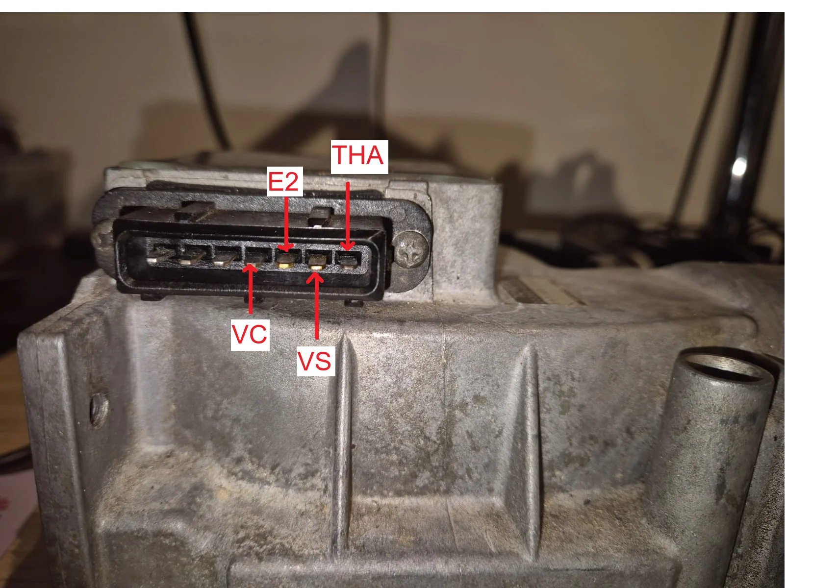

Hi all, I've got 4x VAF meters here, and I'm trying to test each of them to see if they are any good (all 2nd hand).
The problem is, I've found there are inconsistencies in the FSM with regards to which pins are what on the connector.
The first test I did, I believe tests the resistence and the IAT probe is functioning correctly. I'm doing this OFF THE VEHICLE. I understand that I still have to do some on the vehicle tests while manouvering the flap (measuring plate?). Are there any other tests I can do with this off the vehicle? The car will not start with this particular VAF fitted.
How can I definitevely test whether a VAF is good or bad?
My readings:
VS-E2
= 302.6KΩ
THA-E2 = 1.888KΩ at 27.3°C (and 1.3-1.7KΩ after hitting it with the hair dryer for a few seconds from about 10cm away, and temperature climbs slowly when sitting an icepack on the VAF). So can I safely assume the IAT is working correctly?
VC-E2 the readings are not super stable. During one test I got 285.7 to 286.2 and the second test I got 288.6 to 288.9.

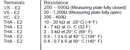

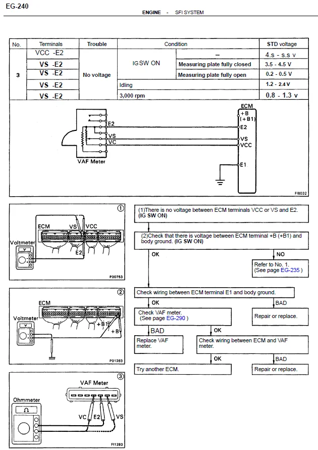

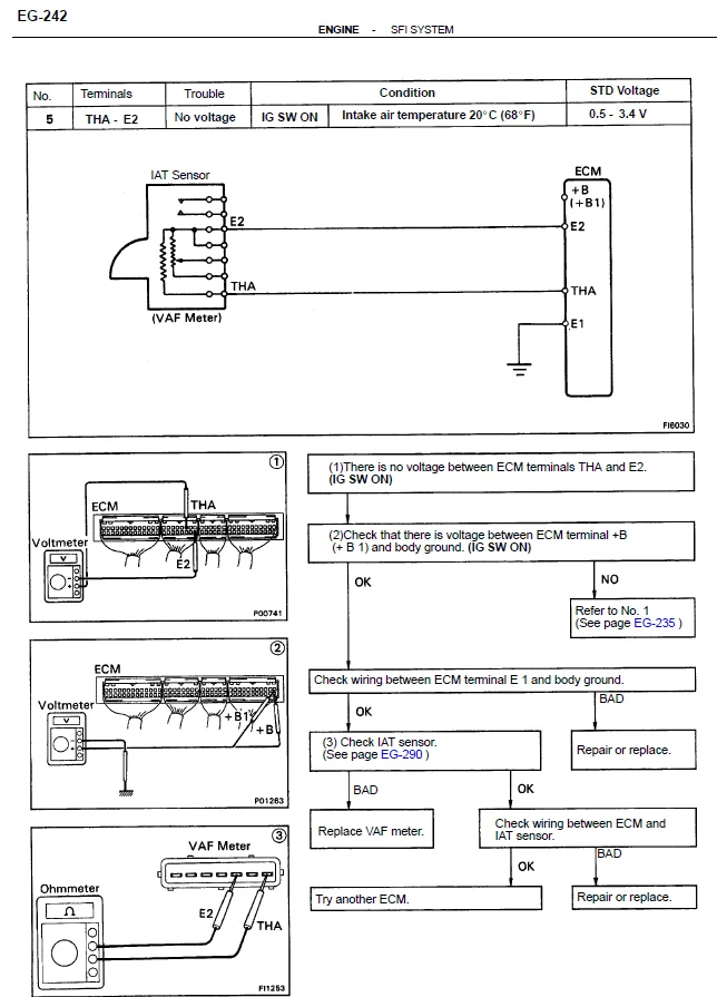

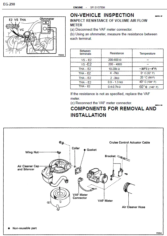

Here are all the different references from the 1994 FSM pertaining to the VAF tests. See how the reference to pins changes between sections?
Why on some of the diagrams do the pin IDs change?
Are these the correct pin IDs?

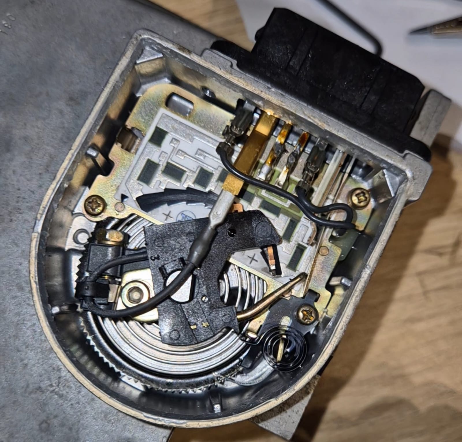

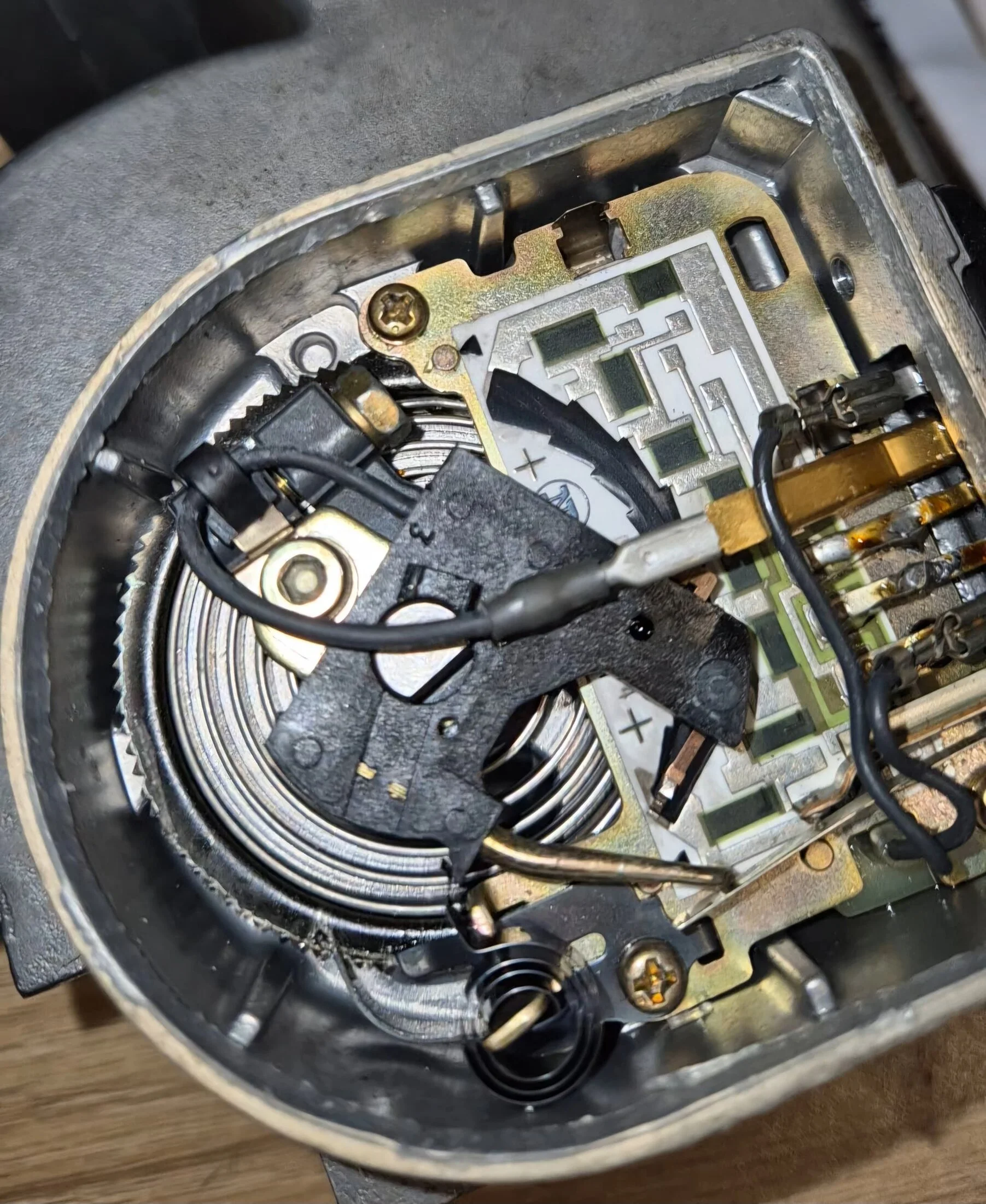

closeup photo of internals for those wondering..
Because electrical stuff sucks. No other reason.

Unfortunately I've already undone the allen key bolt and swapped over the pentionometers between 2 of my units. One of the units was broken from dad trying to undo the 2 screws on the plug and tugging.. and the other unit was apparently a "refurbished" one from 2016.
I quickly discovered that the contact now does not sit in the original position (I dont even know what the exact original position is), but have tried to fiddle around with holding the pentionometer where I think the arm should sit and then tightening at the same time to stop it moving. I've also noticed the little contact (which is a bunch of tiny metal bristles like a broom), are also separating in certain positions as the contact sweeps along the resistor strip.. so either the strip has some worn spots on it, or I've accidentally bent the contact arm down. I tried playing with that gently too. Since I have no idea whether I have done this correctly or stuffed up the original settings (likely), I will opt not to use that specific air flow meter on the vehicle. The one I'm currently testing at the moment has never been opened and is a second hand Denso unit.
The close up image of the unit above is not actually mine, it was one I found online. These are photos of one of mine open:

Were you able to confirm through your testing that these are the correct pins?
yes, pins are correct. My meters are passing the off-vehicle tests. Have not tested on the vehicle though.
My meter is passing off vehicle test except I have open loops and resistance drops when sweeping. I'll need to get a multimeter that supports manual range selection to see if it's the multimeter giving false readings. If the meter checks out, I'll proceed to on vehicle testing. Definitely curious to see your results. Dealing with CEL 24, 25, 26 and running very rich. Local yota shop believes it lies with IAT reading somewhere between VAF, harness, and ECM.
VS - E2 2.63kΩ
VC - E2 278Ω
THA - E2 2.64kΩ

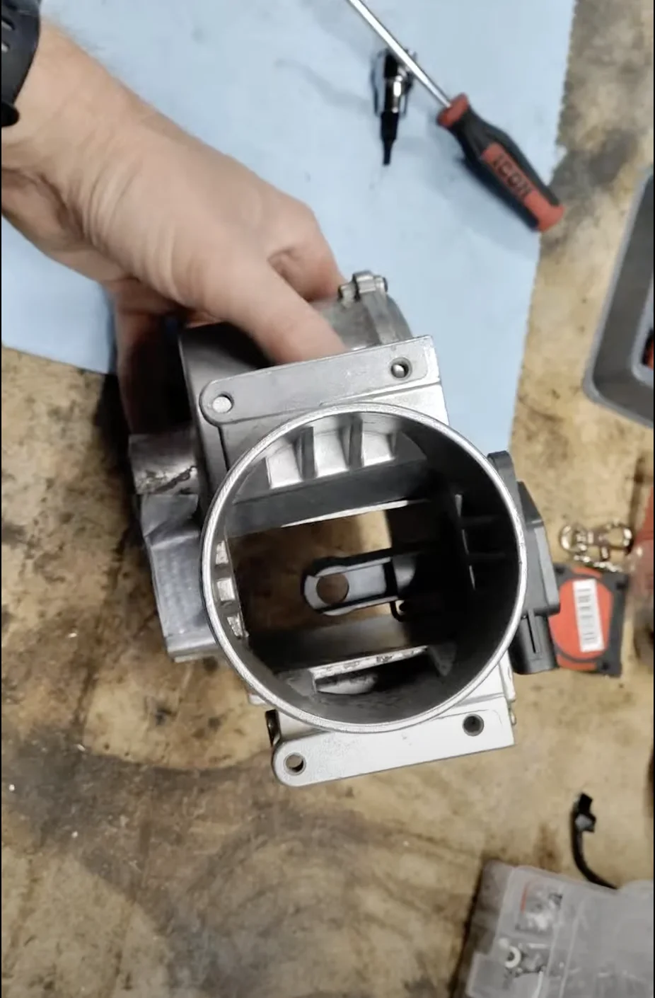

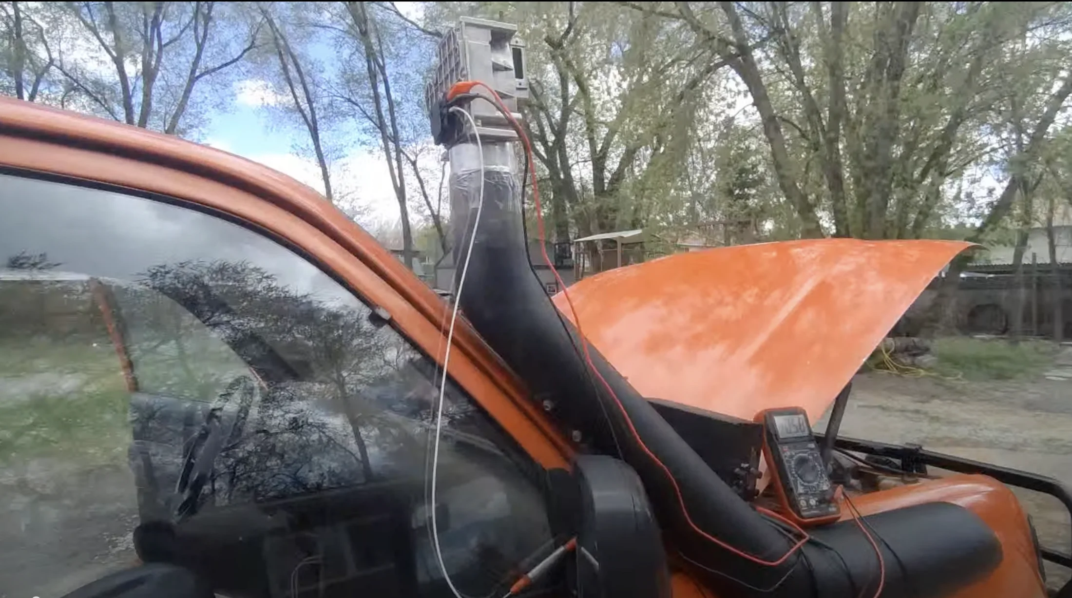

I spent a lot of time trying to fix the VAF in my rig as well. I had two examples of the China knock off version, and never could get the engine run completely right with it across the whole rpm and load range. There was always something that was either too rich or too lean.
Eventually I decided - screw that old junk! I ordered a very common MAF for 2000s Toyotas (Corollas etc, was able to get an aftermarket MAF for $20), and mounted it in the VAF housing. I glued the flap into the fully open positon to not have it interfer.
I know - questionable mounting position for the MAF sensor given these need a undisturbed airflow to work well - but given how crappy the currently remaining VAF options are, I had little to lose.

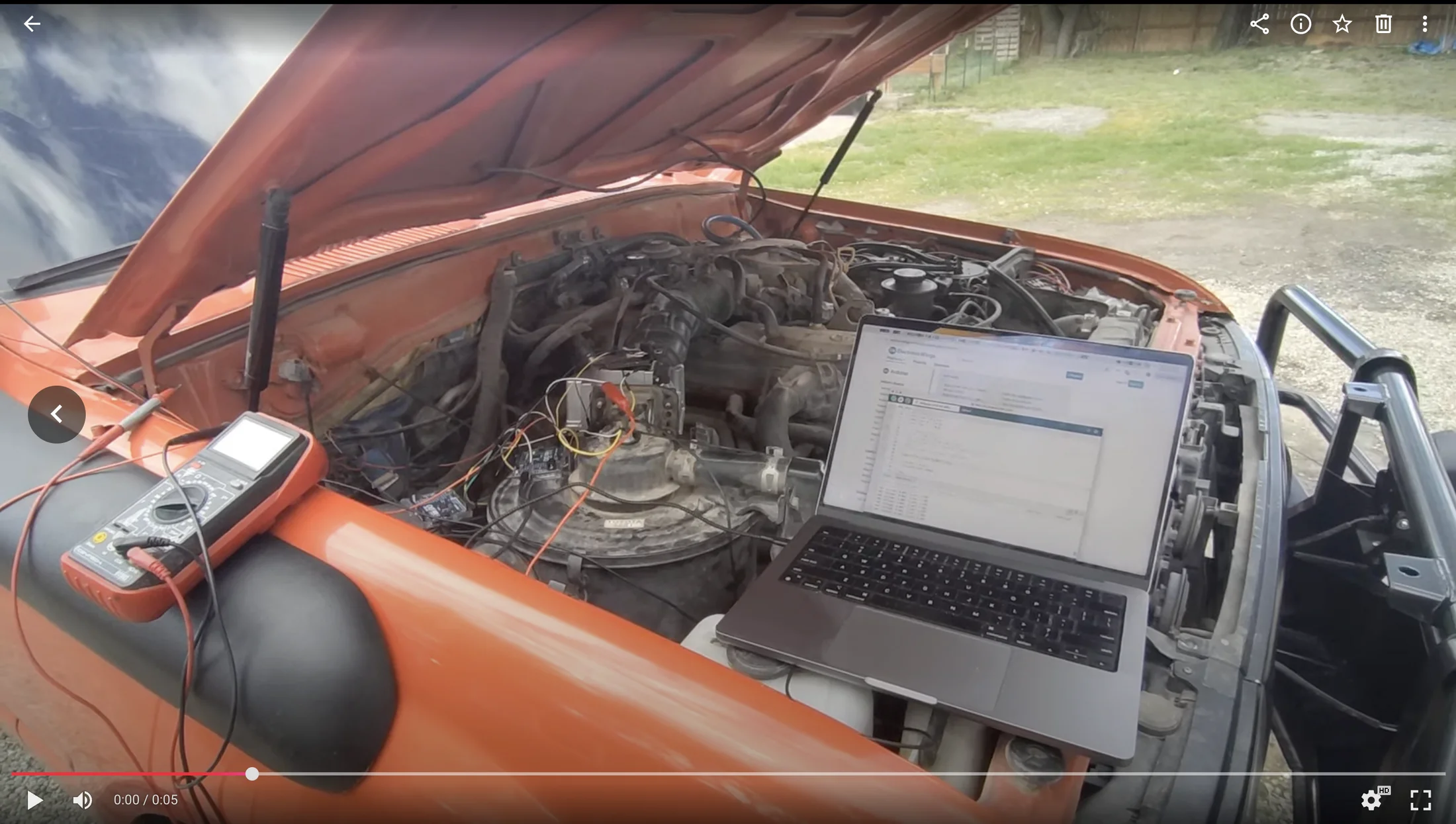

I then hooked an Arduino microcontroller to it and started tuning the voltage conversion.
I got the initial values by hooking the MAF-fi-fied-VAF in series with the existing VAF, and measured a few points. After that I spent a few hours driving around and tuning the conversion formula and signal smoothing function. At idle, the MAF signal fluctuates quite a bit. I don't know if that is normal or caused by the suboptimal mounting position in the VAF housing. However I was able to get that under control with some signal post processing magic.
I have driven it about a 1000 miles now under different conditions - everything from city traffic, 80mph interstate, to Golden Spike in Moab. For the first time since I own this rig, the engine is actually running right under all conditions! Such a joy to drive it now, being able to rev all the way up to 5k and having smooth power without stumbles :D:cool:
Can share more details if people are interested. I plan to clean up the wiring in the next few weeks once I'm 100% confident it's all working correctly. I hope I can make it look basically stock - the microcontroller should fit into the upper part of the VAF housing, and the MAF sitting on the bottom of the VAF housing is not very visible.
