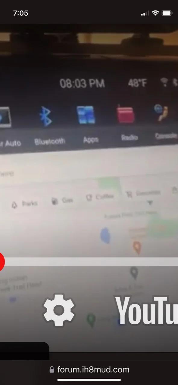

Success on the OBD2 front. I bought an OBDLinkSX USB dongle. It connected easily with the PX6 unit and now I have always available OBDFusion dashboards. Here’s a video of how it connects.
In the video I didn’t hit connect in OBDFusion before I opened the dashboard. That’s why the gauges are reading zero. Pretty happy with how this works.
