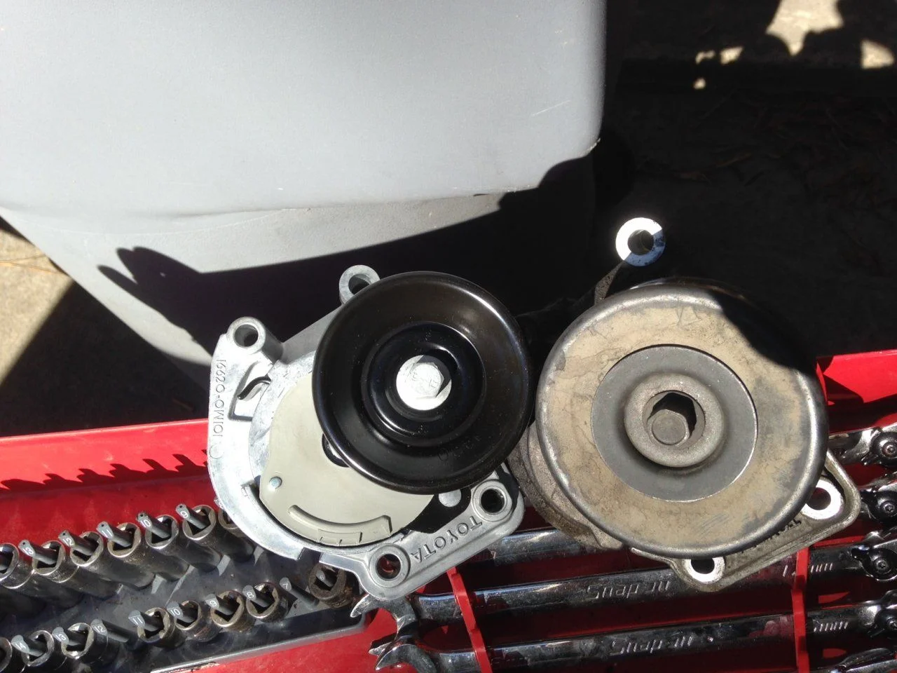

I stole this pic from another user, and believe thats new style tensioner on left and old on right. Your new tensioner will look like one on left. If your truck currently has the tensioner like the one on the right, the new tensioner pulley wont fit on it. There's stuff underneath the pulley that gets in the way.
If you have the new style tensioner, and its just the bearing that's bad, I would absolutely consider just swapping pulleys and being lazy and done with it.

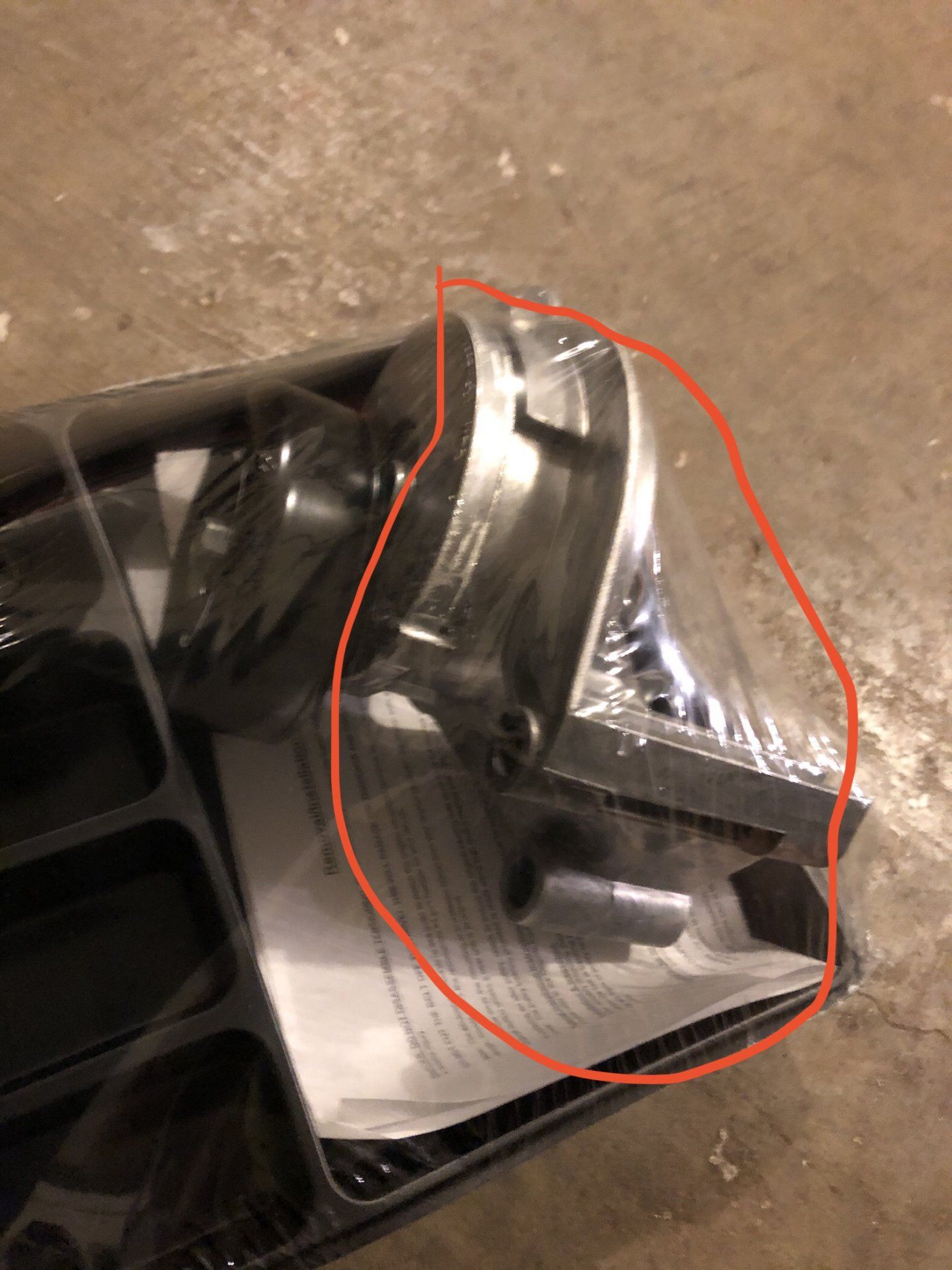

Yeah my question is do I need to install the circled part or can I just install the pulley? See pic
If the actual tensioner part is still in good condition, ie still applying pressure to the belt, then you can definitely just replace the pulley without removing the tensioner. I did this on mine right after I bought it, and did the second ribbed side idler at the same time. Are you sure that pulley is tone making noise? I'd recommend removing the belt and checking both idler pulleys for play and smoothness, as well as checking the fan pulley. When my fan pulley started making noise I couldn't feel any play in it until I removed the belt.

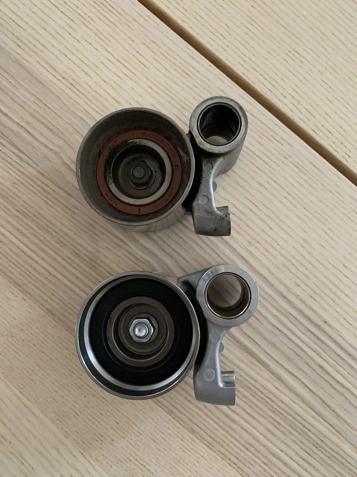

So do i need to install the circled part of this image or can I just use the pulley?
If its the timing belt tensioner pulley that needs to be replaced, its this part:
