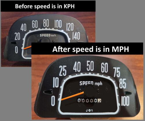

If you go with a Kilometers setup, I have overlays for the speedometer to convert the kilos markings to their MPH values. I also have these in +5 and +10 mph versions.
Do you have these listed somewhere? Ours normally have both kph and mph, but this could make my life easier while in the UK
Here is a link to the eBay listing. If you want to pay me directly I can give you free shipping and cut eBay out.
