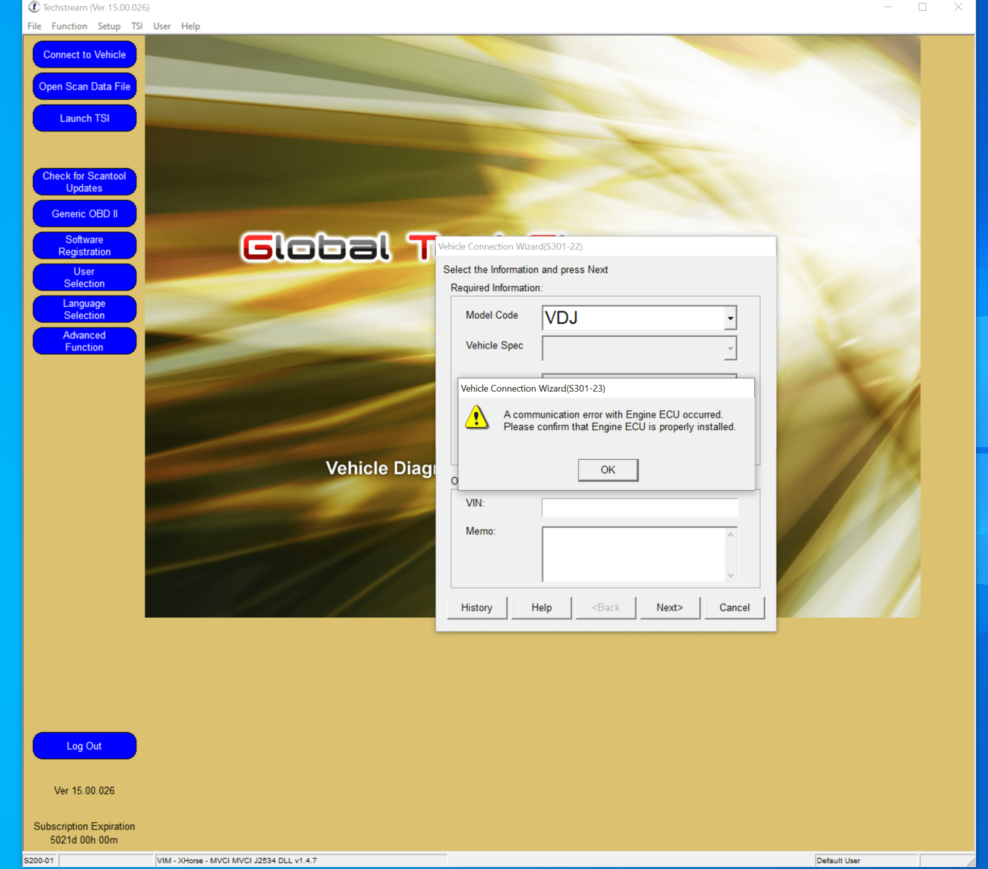

OK, your suggestion seemed to work until I selected VDJ.
I get the following error which does not make sense.
When I select OK, it returns to the beginning. I'm sure that my ECU is fine as it has not been touched and the truck is brand new.

Thank you for posting your screen shots. In your "setup" tab, there should be a "VIM" selection. That VIM is the OTC module you show, or a drewtech techstream lite dongle, in Japan there is a denso VIM. You need that for GTS to talk to the car. A generic USB to OBD(DLC3) connector will not work. You need GTS to see that module. Based on your error or no communication, I would guess that there is an issue with the device you are using between your computer and the vehicle.
I'm using a generic one so I guess that is the problem. I'll see if I can find a Denso. Thanks for all the help.
