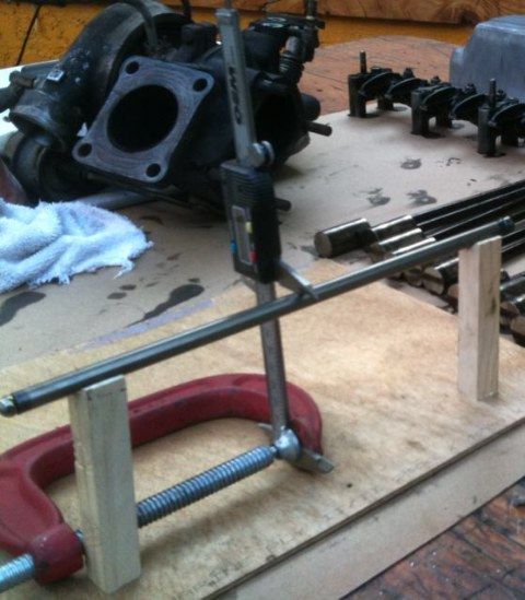

i already pulled it apart and check the rocker arm, lifters, push rods all are in perfect condition showing no wear measured everything with a caliper (pix below). i also pulled the oil pan cover off to clean it out and also take a peak at the camshaft. i saw no wear on the camshaft. it was also very clean, not a lot of carbon deposit on the engine block and the pan was clean no oil gunk. in fact it made me think maybe this engine has been taken apart before.

For rocker arm wear, best measured with a micrometer, but in my opinion (maybe not shared by others) if it looks ok and the ridge is very minor, I would lightly rub it down with 1200 wet and dry and be done with it. be sure to install the shaft the right direction around - the oil flow entry hole is only at one end.
