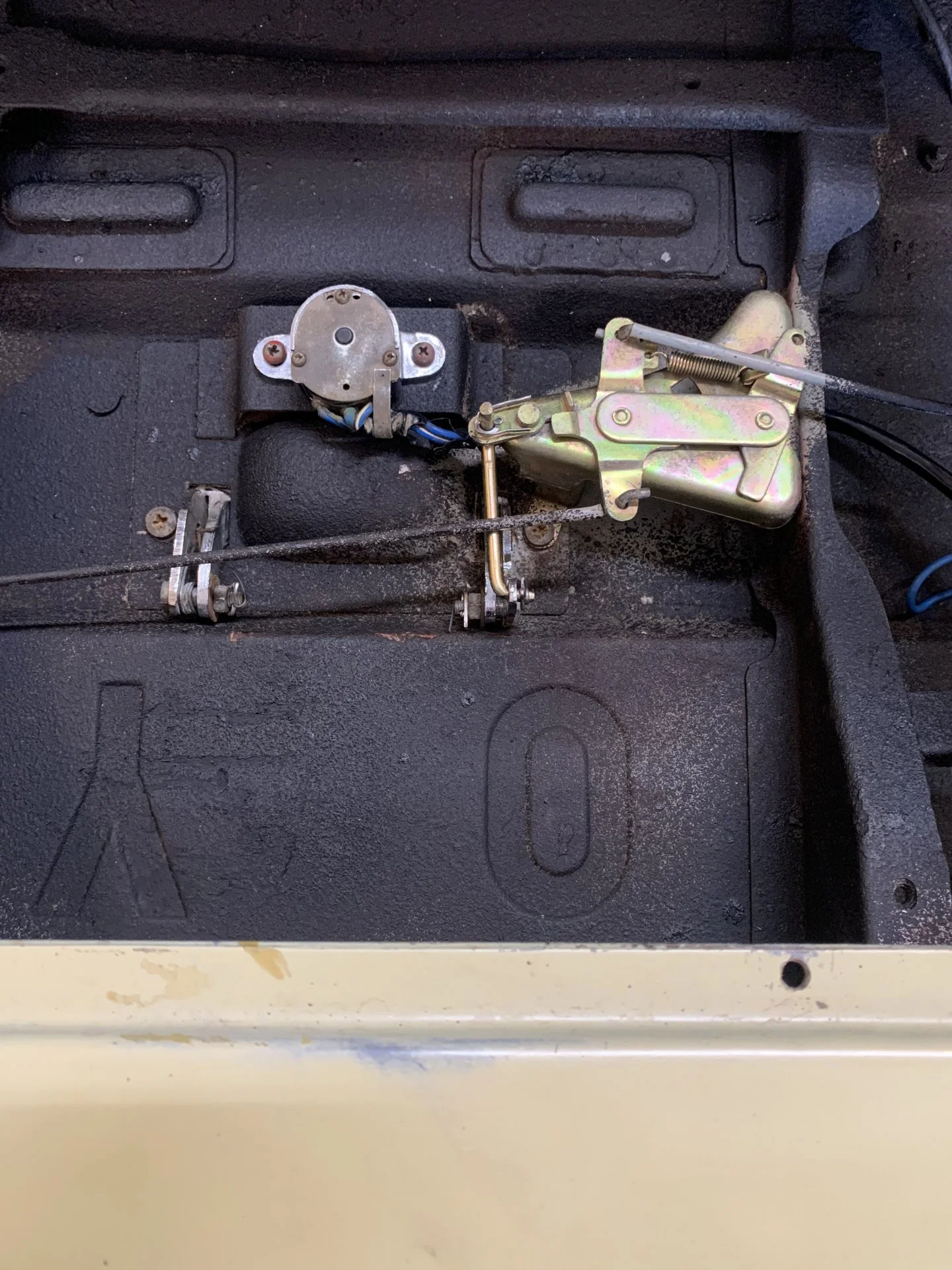

My tailgate was not opening when I purchased my 55’. The key switch didn’t work and the seals were all wasted. Some folks live with mediocre assembly of their vehicles and that’s fine but I need things to work and operate like they should.
first thing that I did was to diagnose the key switch. Well, that was easy! The internals were missing that made the contact inside and I purchased one from a user and it was nice!
The best part was I have my original keys so I swapped my cylinder into the new to me housing which was slightly nicer and made it operate as it’s supposed to.

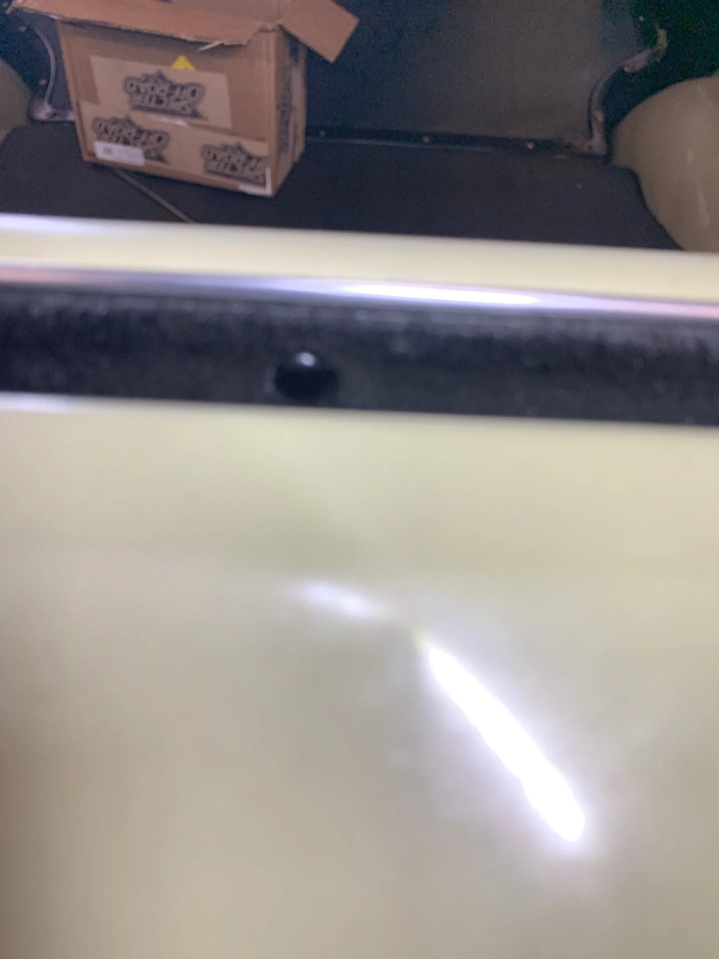

While the regulator was out I took a minute and cleaned the inside and applied some 3m undercoating. It’s a little nicer and thicker. Installed a new tailgate handle seal, new lower tailgate seal, new upper seal for the glass and have the outer seal (scraper) but at the moment I’m missing the the two metal strips the sandwich that seal and waiting to obtain those two. The inner felt trim that the glass rides on is also new. That’s not as easy to install as one would think. But I got it first try with all the hole drilling. You just have to measure three times.
