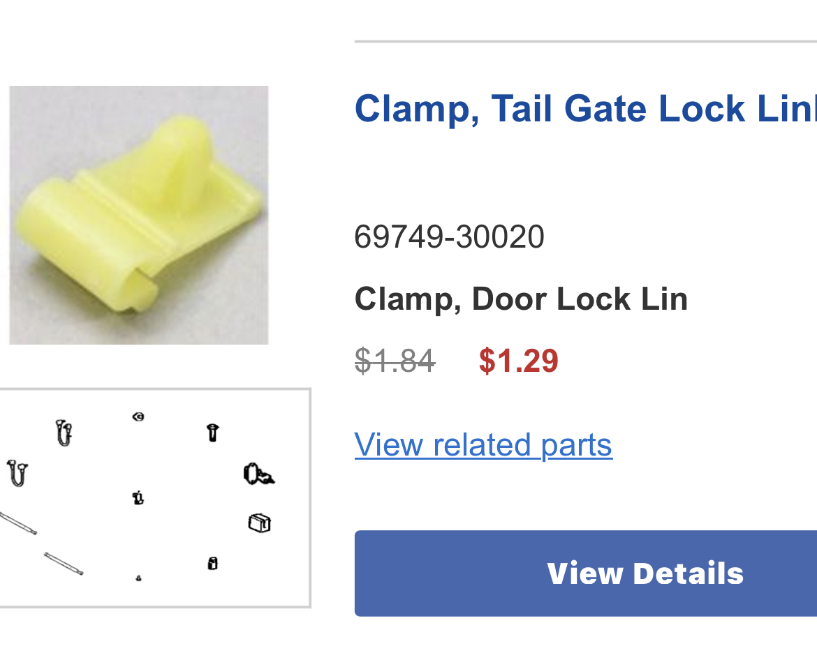

The tailgate door lock rod clip snapped after 34 years. Very impressive the clip lasted 34 years with the tailgate opening and closing thousands of times . Did not see replacement clips at “clips and fasteners”website and did the usual search through the land cruiser supply websites however could not find a decent picture or anything that resembled the tailgate lock rod clip.
Anyone have a part # or link to what I need? Anyone do something different than the plastic clip as a fix to the lock rod so the tailgate will open?

Ck out Bean build...think thats the clip u search

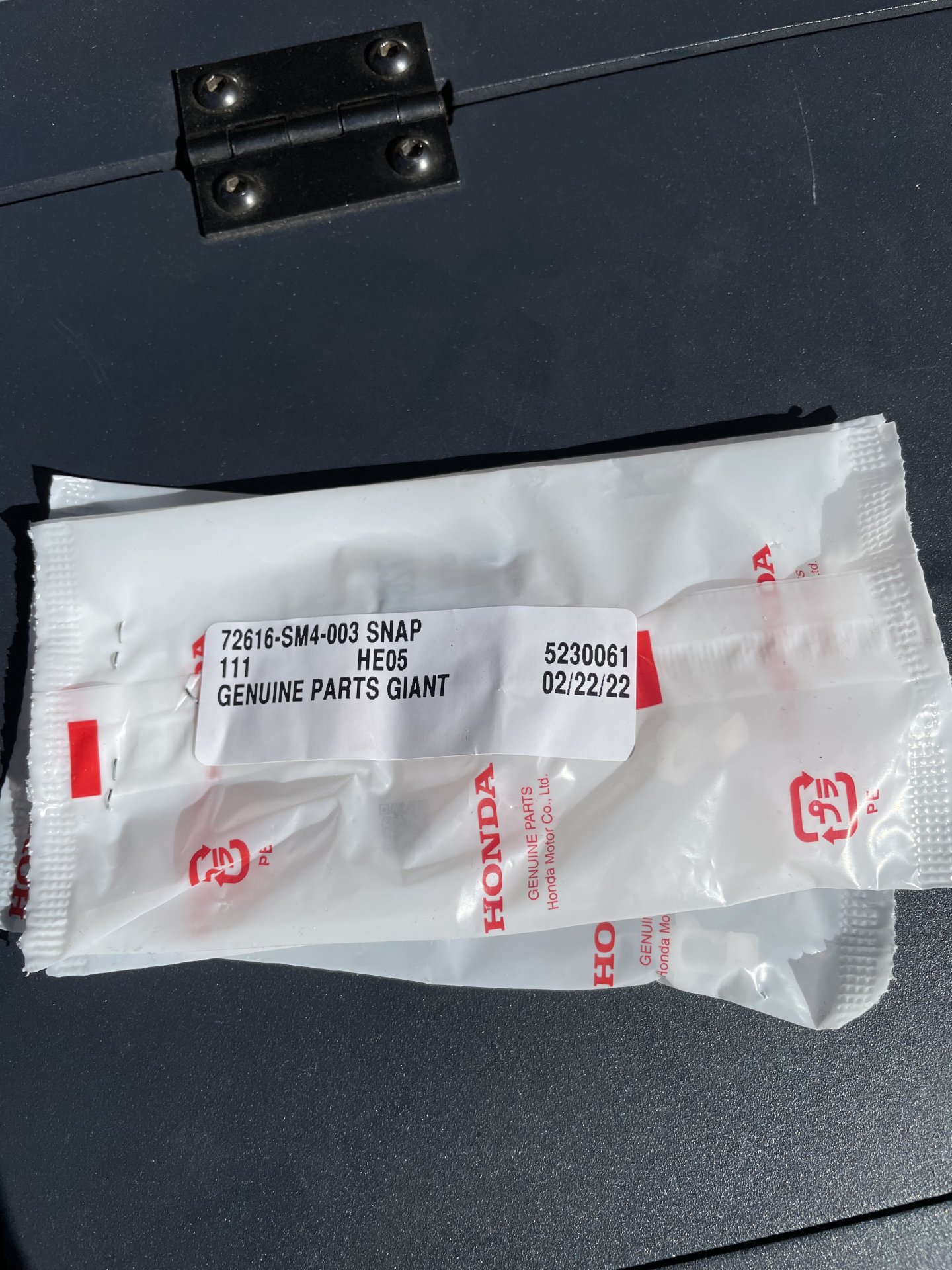

I think they are NLA...Bnzi user Honda clips i posted
