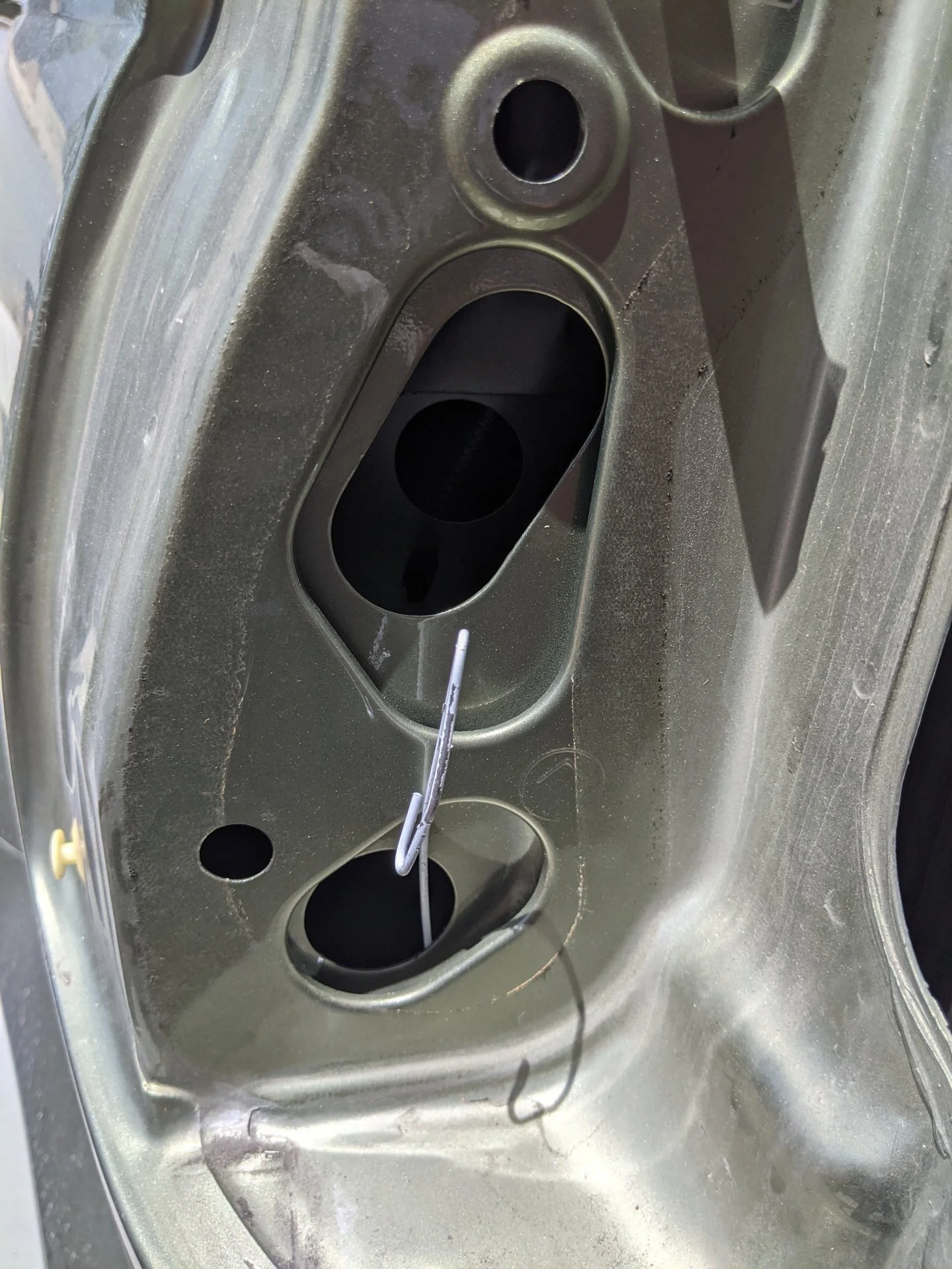

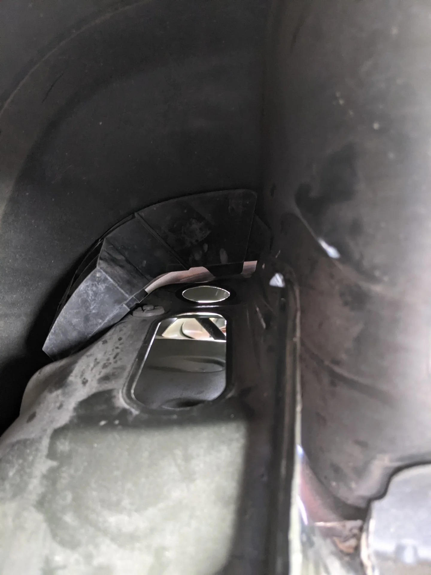

I haven't seen many write ups on the installation through the tail light. I chose the driver side tail light. examining under the car, there is a circular port with a rubber grommet that houses the air bag pump breather. right under that is an oblong circular opening that has a hard plastic cover. I removed both of these and the tail light, to be able to see the hose path I desired.

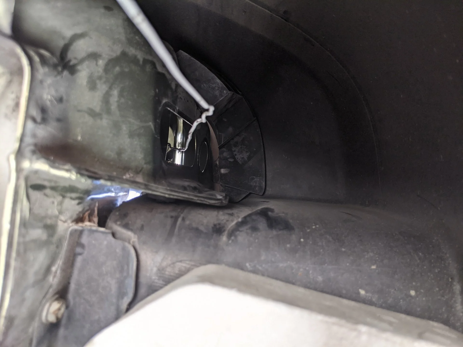

after identifying the hose path desired, I routed a clothes hanger from the bottom up. the end of the clothes hanger came out here.

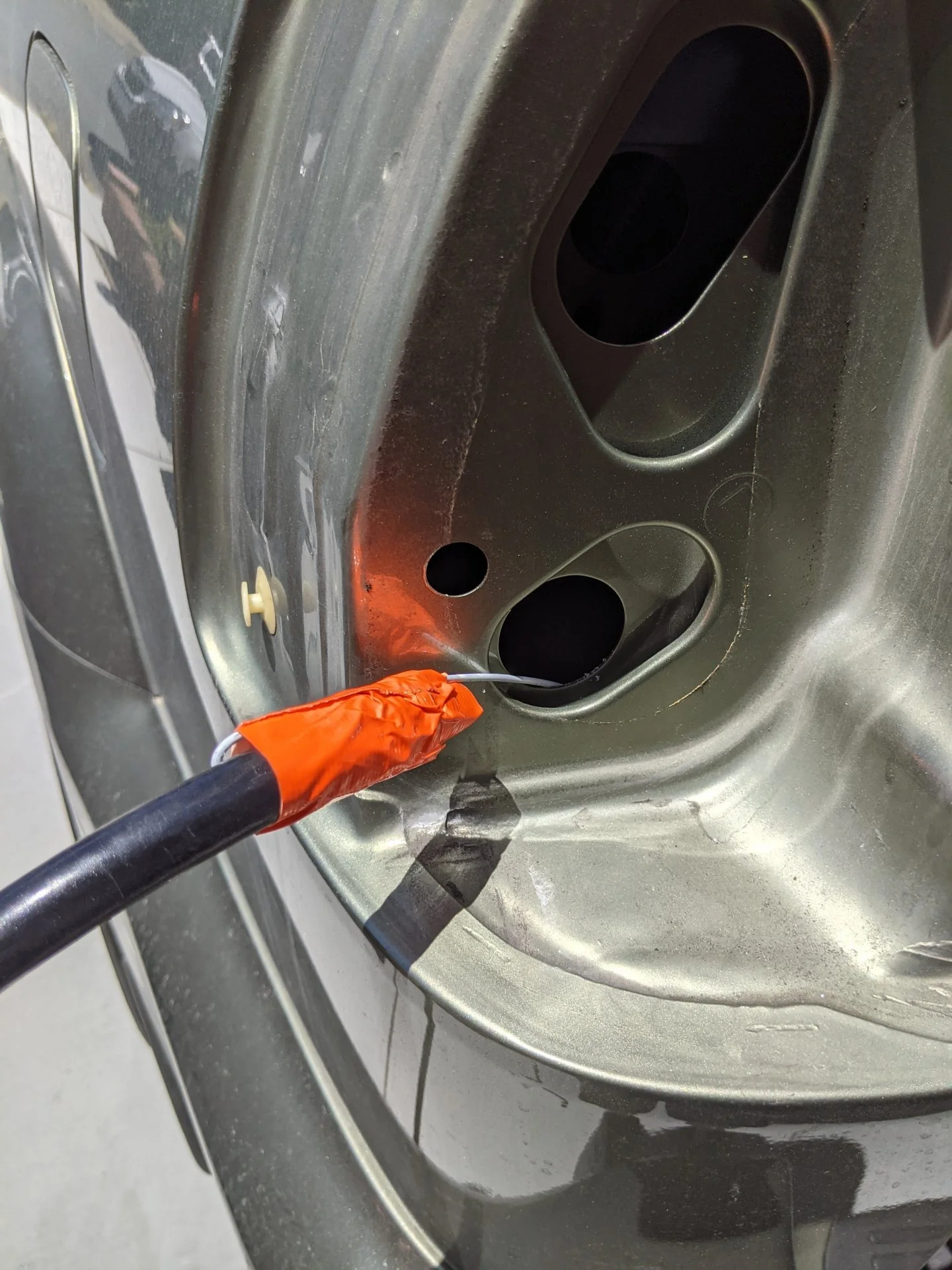

from here I taped the hose to the clothes hanger and pulled the clothes hanger down.
my intention was to reuse the circular port that housed the air pump breather.

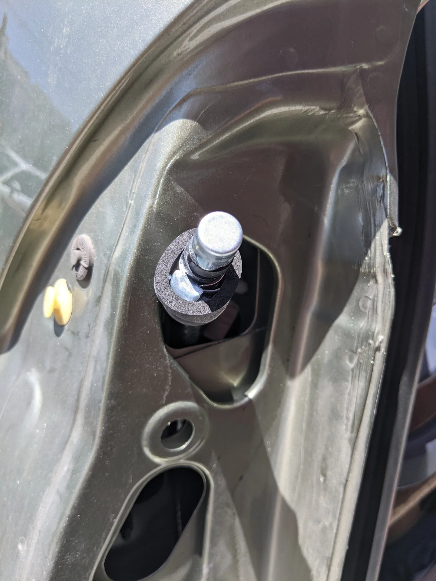

here's the cannibalized grommet reinstalled on the new diff breather hose.
also decided to cannibalize the foam sleeve from around the air pump breather tube and installed it at the top of the diff breather, so there's no clattering inside the body panels.
