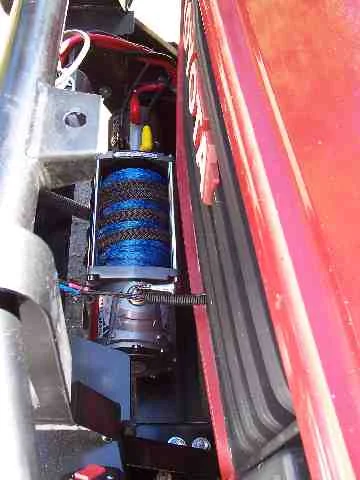

winchline by viking offroad WINCHLINE.COM
Thanks hatman, I've had a look through your thread that was running a little while back. Have you noticed any issues with the roller fairlead?
