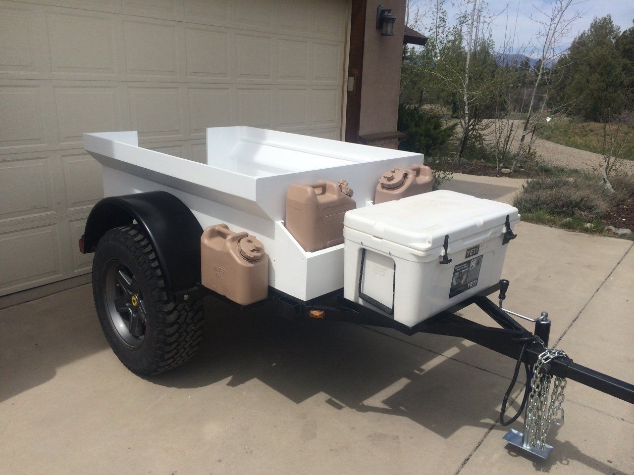

I have a great home build trailer (pic below, without its top) that I pulled behind my Jeep, I ordered the rear axle with 5 x 5 bolt pattern to match the JK hub and used spacers to mount AEV wheels. Well now I have sold the JK and switched to a GX470, but I am not getting rid of the trailer.
So the problem comes to the hub of the trailer, it is a dexter axle with a hub that uses a dexter hub with inner bearing (L68149) and race, outer bearing (L44649) and race. Now I can get a 6 x 5.5 or 6 x 139.7mm hub that uses the same bearings, but the studs are 1/2 x 20 thread and I need 12 x 1.5mm thread studs. I am using 2015 4Runner SR5 wheels (pic below) and they use a mag wheel nut (pic below). the wheels have a .725 nut opening and I can only find a .685 or .740 mag nut for a 1/2 x 20 thread.
So does anyone know of a fix, could I replace the wheel studs on the hub? is there a toyota hub of some type that might fit? is there a spacer to go from 5 x 5 to 6 x 5.5 and 12 x 139.7mm studs?
