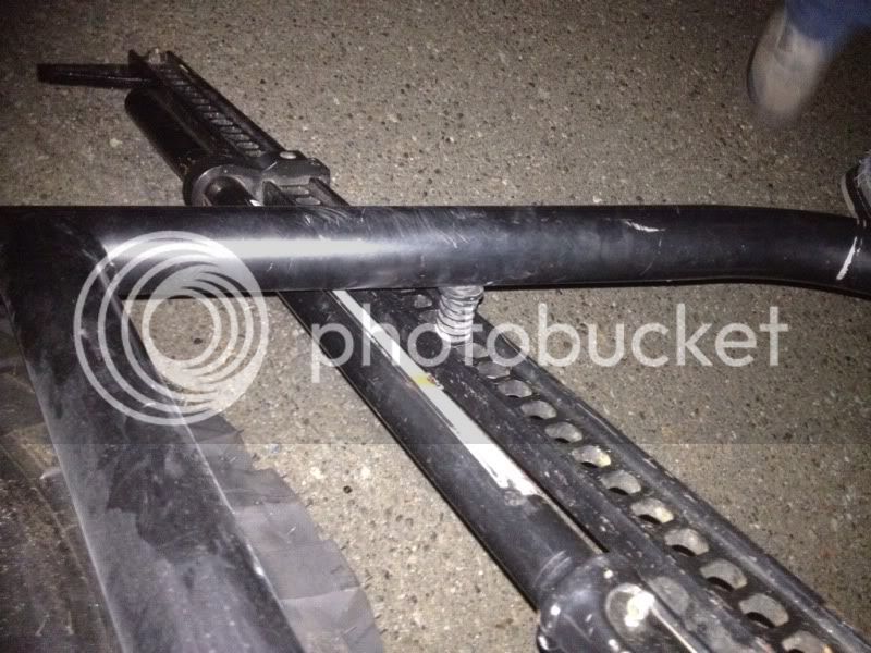

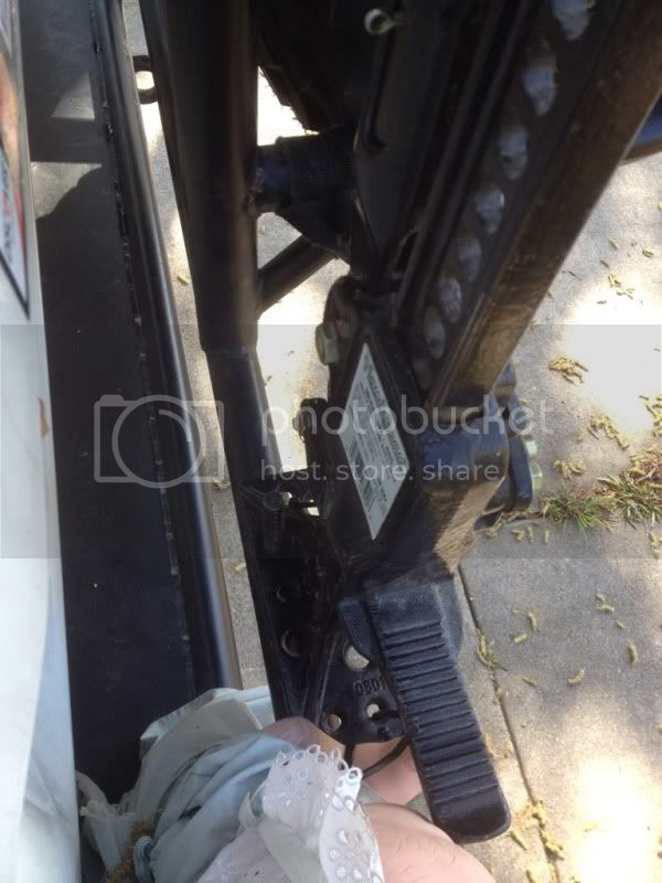

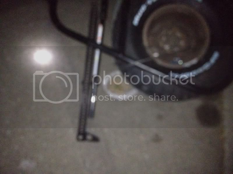

you don't have the whole assembly weight on the tip of your Hilift, though, right?
No sir there's a bracket on the bottom to hold the base in place. I'll post a pic later for ya.
Thanks
Hahaha dumbass me. I see what you mean now. The tire hits the ground at the same point as the hi lift does.
