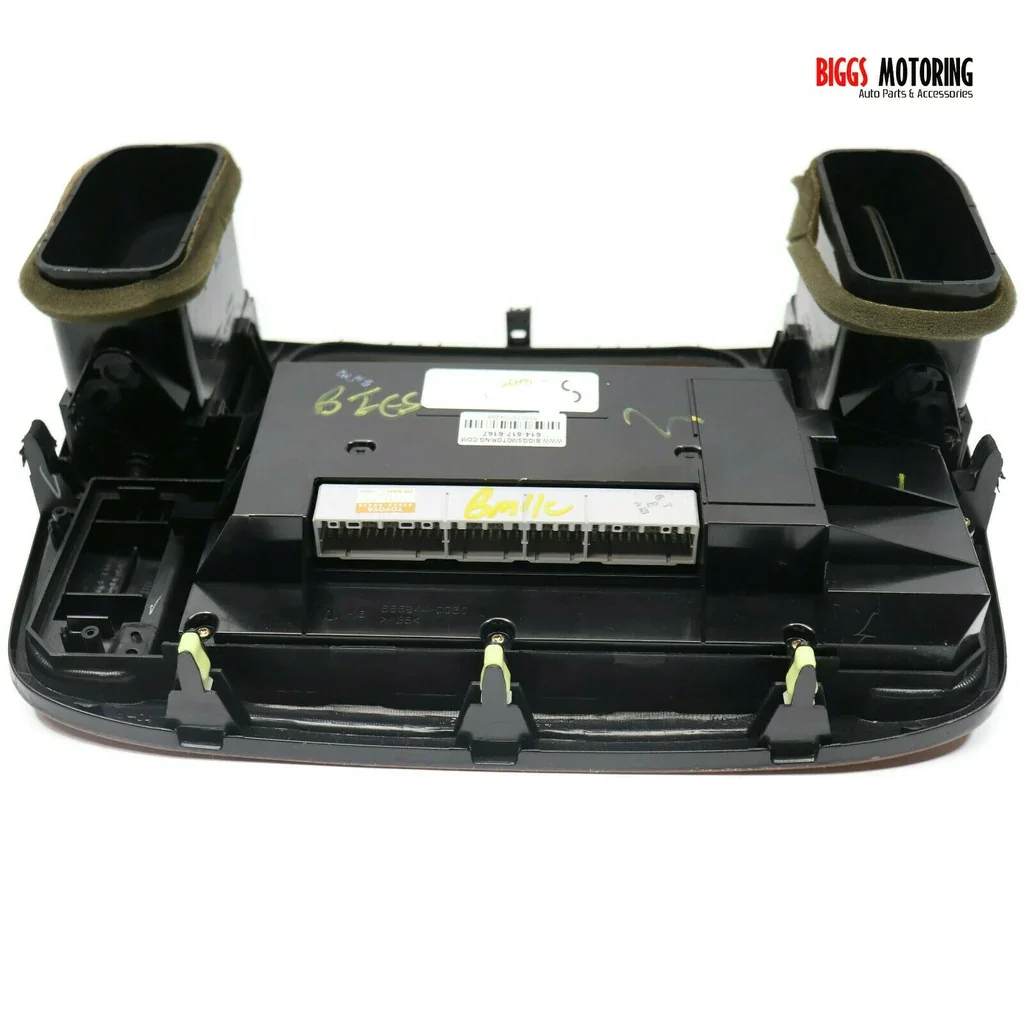

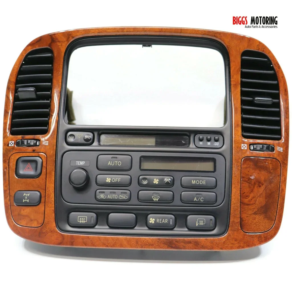

Is it possible to swap 1998 LX470 gcc spec climate control from non-navigate(1) to navigate(2)?
(1)
(2)
I know the plugs are different, but should I replace the whole Climate Control wire harness or just modify it?

Physically it will swap in - no problem. If you do switch to navigation type bezel - you will need to source the OEM navigation unit as well since climate controls are integrated in to the nav screen.
Most ppl here are not a fan of the ancient nav screen and would love to switch their nav screen with your non-nav unit, so at least it will be easy to source. Non-nav setups allow you to upgrade your stereo headunit to a modern double din with all the tech you can think of.
I am curious why are you interested in this swap?

I’ve spent time in the post 03 nav delete, you’re going the opposite way you’ll need to change wiring harness connectors, or make adapters. Your hvac plugs straight into those switches, it now would have to be wired into your stereo/nav system and communicate with it. Not saying it’s not possible but like classy stated above, most delete the nav not install one.

If you go with OEM Nav or aftermarket NAV the replacement head unit has to control the HVAC. So it’s all touch screen, if for some reason the touch screen breaks, you can’t control your HVAC. If you can’t get the head unit to work with your HVAC you will have issues as well. Look up the Tesla type(Tyes?) units and see what problems they run into. You’d also have to rewire the HVAC plugs (the plugs in photo 1, need to be in the head unit)
The non-nav version your HVAC controller is completely separate from the head unit. That lets you install any type of head unit you want.
Sounds like you just need to fix the issue with your HVAC controls and then install any type of head unit you’d like.
You’d have to dig through the pre-03 nav delete and do it backwards if that’s really what you want to do.

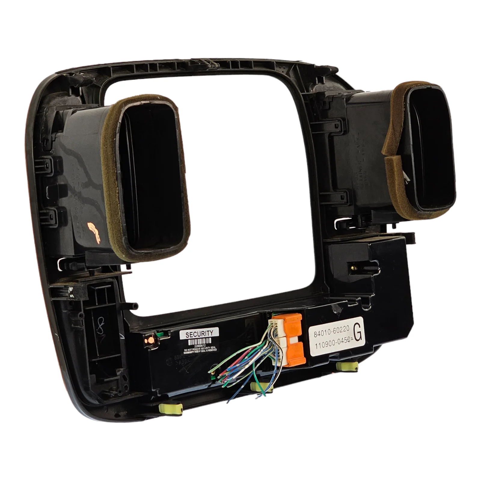

How do yall got your non-nav controls? I'm looking for a non-nav for my LX... I'm in no rush but I started looking and the only ones I have found are ~600$ in google, which don't even include the wiring pigtails. I'm not sure how to find a decent priced on one
Isn't his 03+? If so, I did see it... Which brings me to another question: Controls from RHD car can be used in a LHD? Or that applies only to 2003+
You’re correct that the kit I’ve got is 03+
The 03-07 RHD controls are mostly plug and play except for the ac compressor circuit and clock wiring.
The 98-02 RHD controls are 100% plug and play for anyone interested/curious. I’ve actually been using a set of RHD Land Cruiser controls in my 1999 LX470
The RHD controls are much cheaper on ebay than LHD FWIW
Great to know! Thanks!
Seller said they don’t have pigtails though. Not sure if it’s worth it still
