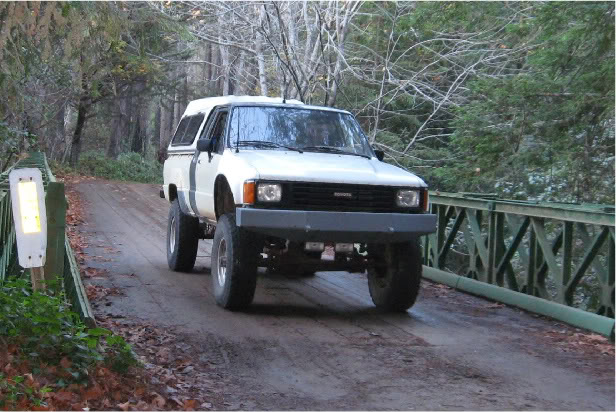

'84 Xcab, 33-10.50's, 4.88's, Grizzly/Lock-rite, Bils, GM63's/OMEs, WFO rear shackles, OEM fronts; Overlanding Desert Race Chaser.

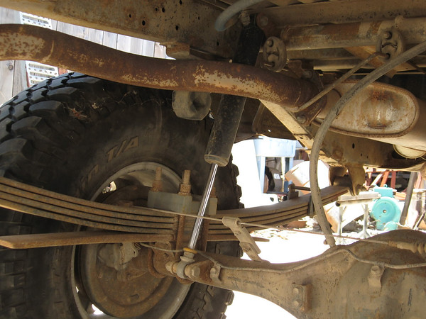

Shot of rear suspension:
Not completely, but reasonably sure that those are the GM o/l's since they don't have the keeper/traction strap that the yota parts do. *Might* be some Mazda parts though.
Notice that it curves down.
