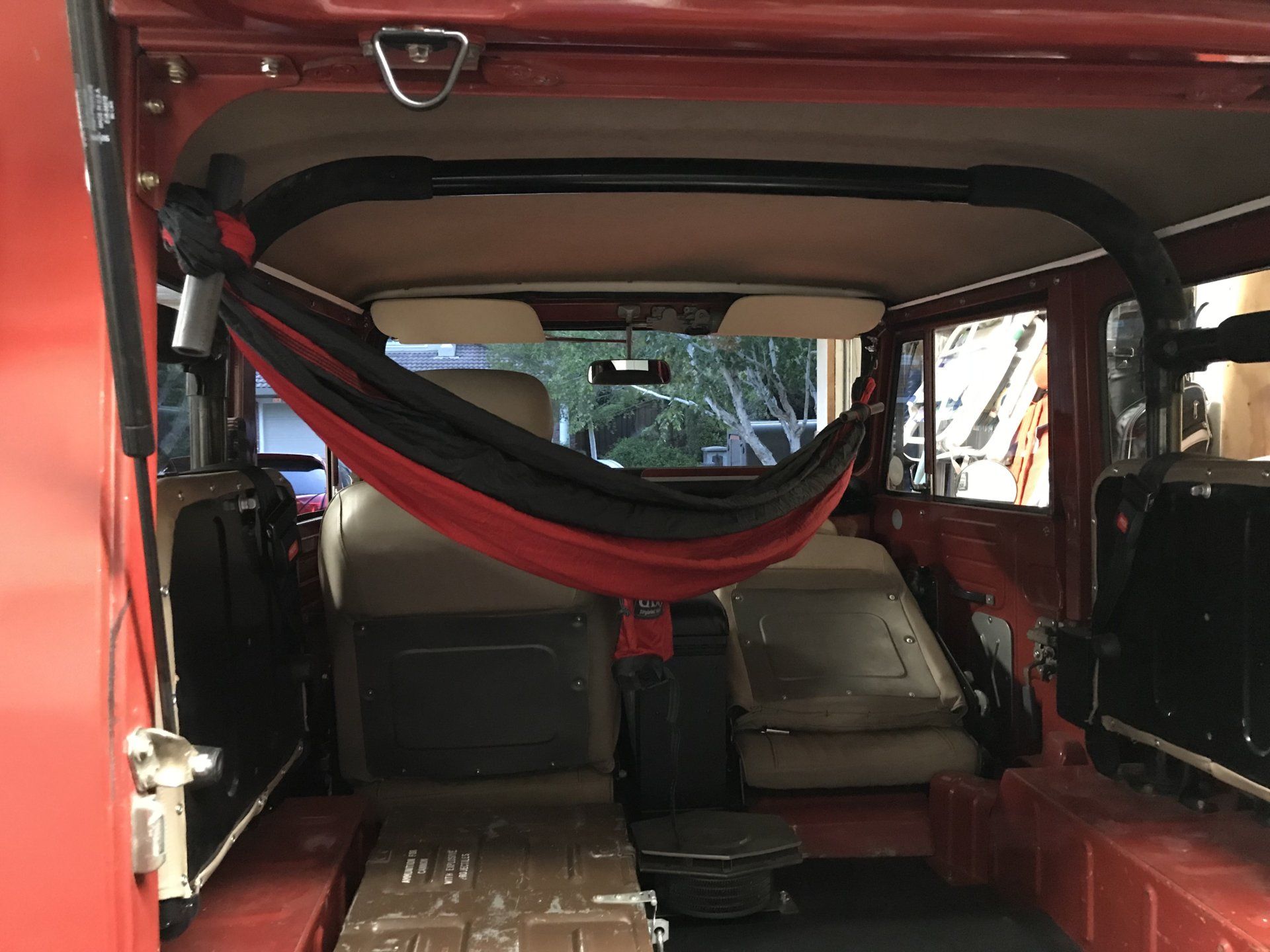

I recently went camping with a friend and decided to try to do a hammock inside my 40. I read some other threads that guys shared involving hammocks. I ran my ENO hammock from corner to corner (front passenger A pillar to driver side C pillar? The back corner.) I had to shorten up my hammock and while it did work, it was really difficult to get into a sleeping bag inside a hammock. And it was a cold night so a sleeping bag was a must! The Tuffy console did create a slight obstruction when the hammock sagged. Not awful but noticeable.

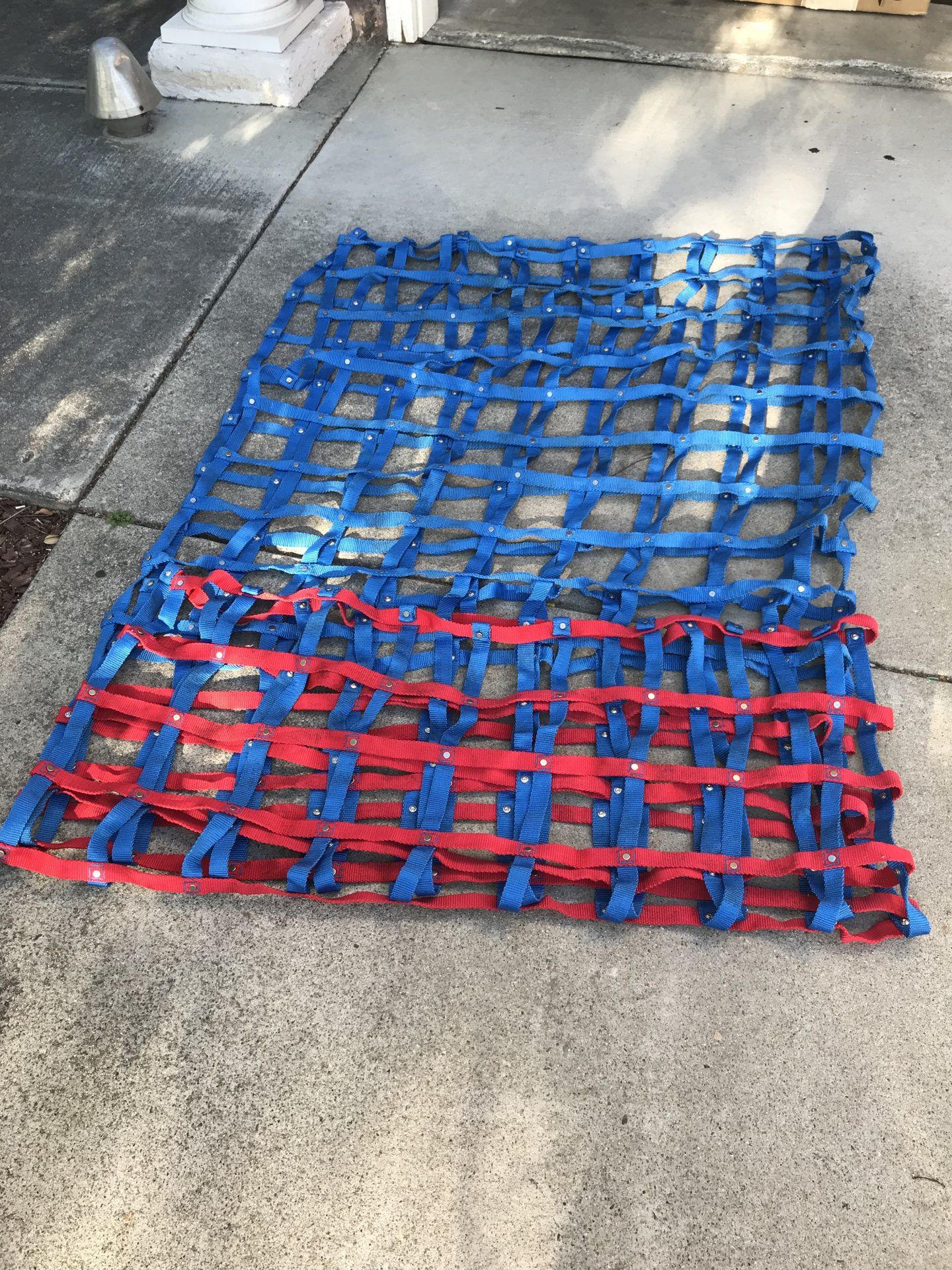

In my search I stumbled across a climbing web mat from a school supply store. It was huge at 8' x 9' and had a rating of 1,100#. I couldn't beat the price at $42, on sale normally $269 (unfortunately all sold out now
). I added a box of sharpie markers to reach $49 to get free shipping (can you ever have too many sharpie markers?). This is it pictured below folded in half in the width direction and then about 2' folded on the length direction. So about 4.5' x 6'.

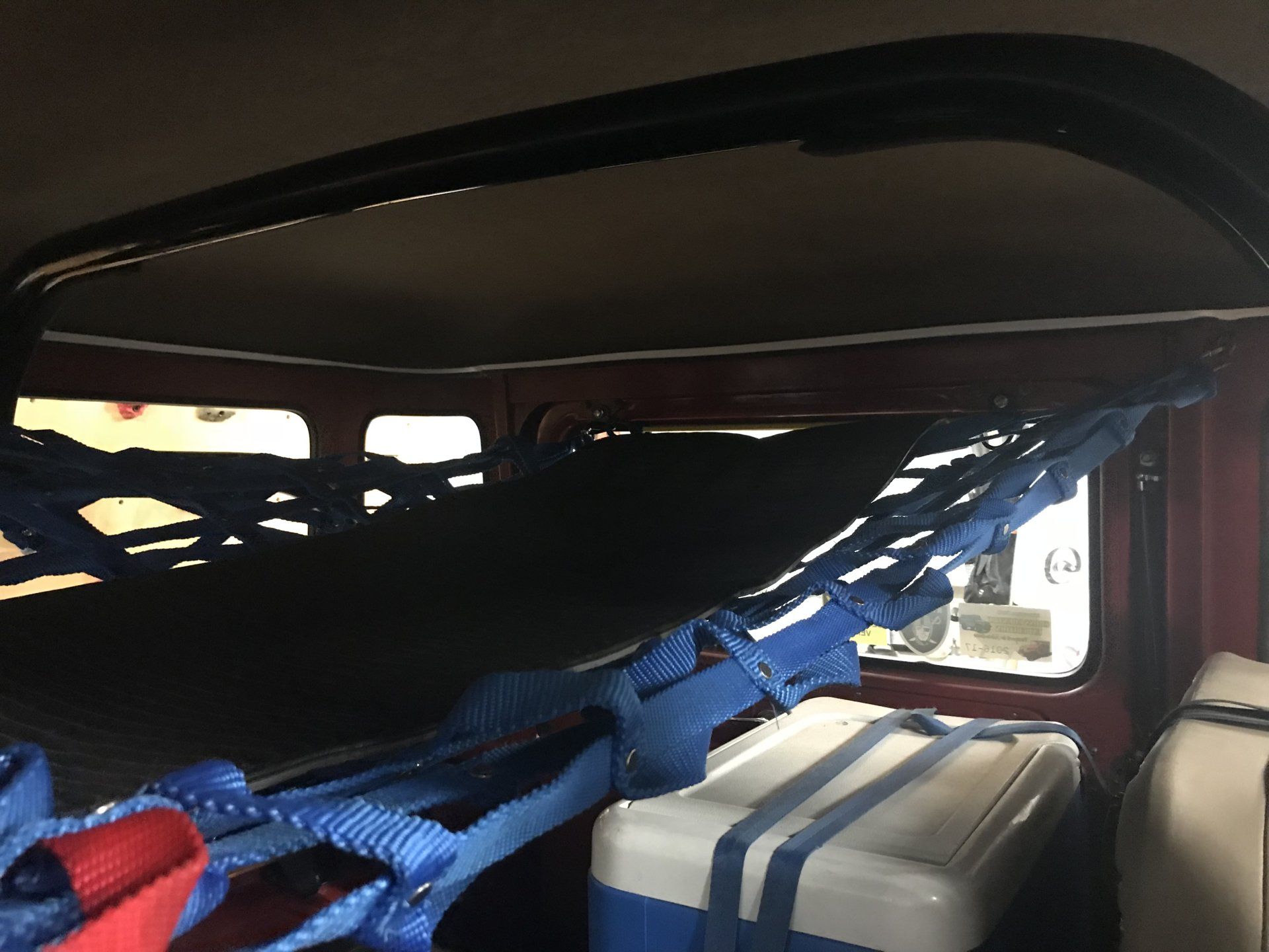

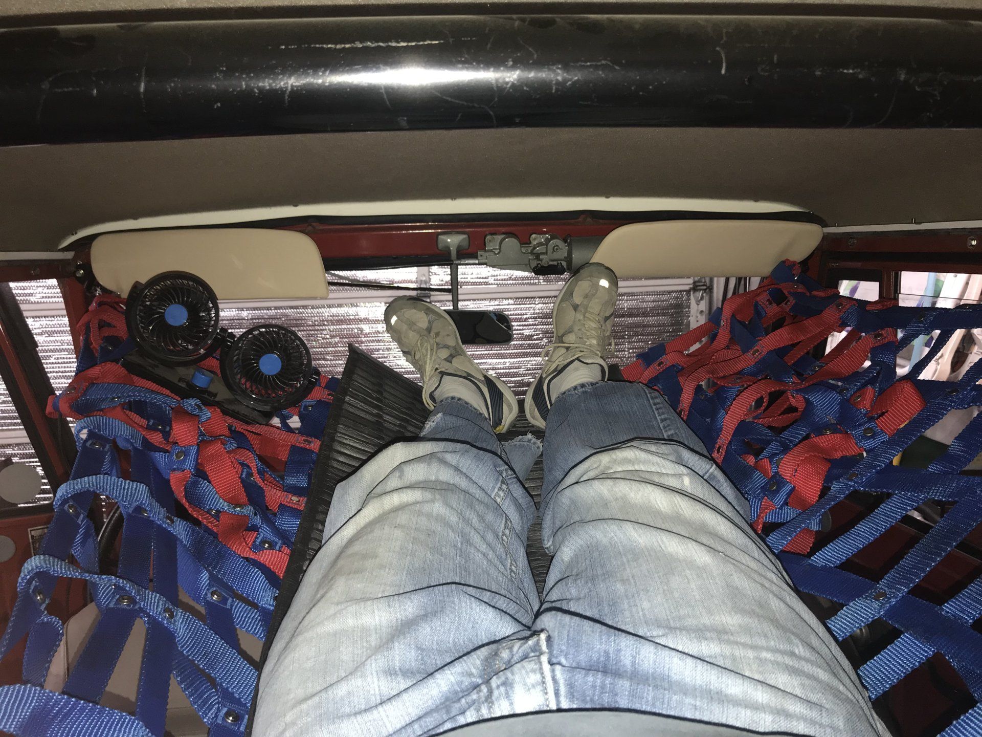

Super comfy! And rock solid! No creaking of any kind when I climbed on top of the webbing. I put down an old foam sleeping pad to disperse the load so the webbing didn't create pressure points - a slightly wider one would be nice but not necessary. With a sleeping bag and pillow it will be really nice. The dual fan setup in the photo is a 12V battery powered model that I was using during my testing because it was pretty warm. I had it plugged into my big portable car charger/starter. I'm sure I'll bring that along but I wouldn't have it on the webbing. Probably on the rear bed just to circulate some air.
So if you're looking for a way to sleep in your 40 without taking out a seat to build a platform, this works really well. All in about $60-$65. I may end up cutting the web mat in half to reduce its size/weight so that would definitely reduce the cost per unit. If you installed another anchor at the driver side B pillar, you could disconnect the A pillar anchors and roll the web back. Then you could use it as storage during the drive to your campsite - it will obstruct some of your rear view however. But another option for the limited storage in our beloved 40's.
