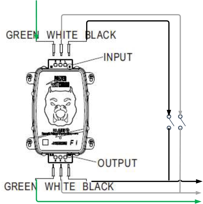

We have recently bought a new travel trailer and would like to install a hard-wired power surge protector. The brand we've settled on is a 30A Hughes Power Watchdog.
(30 Amp Bluetooth Surge Protector with Auto Shutoff - Hardwired - Hughes Autoformers - https://hughesautoformers.com/product/pwd30-epo-h/)
The Hughes unit does not come with a built-in bypass capability.
Has anyone made or does anyone know the best way to make a bypass capability?
I was thinking a simple bypass circuit as shown below. One half of a Leviton #1288 DPDT center off 30A switch would do it. The switch thrown would be bypass, center off would engage the surge unit. This switch is meant to switch two hot legs and I'm switching a neutral and a hot in this circuit.
Perhaps there's a better way?

I don't know anything about that surge protector, but electrically it seems that a bypass like that would work ( although I might think about upscaling the switch a bit for peace of mind if you think that an actual 30A pull is likely when switching on or off).
Why are you thinking about bypassing your expensive protection? Are those too limiting or likely to fail unexpectedly?
I would shut power off before doing anything (I sure HOPE I'd remember to do that). The switch advertises it's 30A however I could also use a double pole 30 or 50A breaker instead of the switch I suppose.
So why do this? Well they do fail occasionally and are designed to sacrifice themselves when there's a big enough power surge. You can get replacement "internals" and I could have one in "stock". However I wanted a very quick way to bypass and restore power if I had to. I could get a portable unit that would solve this problem by simply removing/unplugging it but thieves have discovered they also can do this.

An alternative schematic is this - it fully utilizes the same DPDT switch by having power going to the center contacts. It more fully isolates the surge unit but I'm not sure it accomplishes anything more:

Well, if there was such a surge that the protection trips and fries the sacrificial bit, I would be very hesitant to bypass the protection at that point given the likelihood that the next surge might then take my expensive electronics in the RV. In fact, I would even be hesitant to put in a spare sacrificial bit unless I know that it's very unlikely there would be another surge, or it's a cheap enough spare. If I have batteries and/or a solar system and there is no critical need, I'd just forget the hook up at that point rather than take a chance.
But if I really needed to be able to bypass the protector, I'd consider using quick disconnects like Anderson SBs and just remove the protector and replace with a bit of wiring. That way, there is no chance of accidentally leaving a switch in the bypass position. And cheaper than a high current switch, probably.

Seriously, I 'm concerned about what that Hughes device will do if it sees bypassed power with power at input & output as in schematic 1 or on output only as in schematic 2. Will it explode?
The green ground also worries me. Is it a pass-through or possibly connected when it has power?
I dunno exactly how these things work.
I'd just FAFO but it costs almost $300 so blowing one up would hurt.
If it's a good disconnect, I can't see that either layout would cause the protector to experience any serious problem afterward (outside of some unlikely weird situation with very high voltages or some other odd issue, possibly). Of the 2, the second is perhaps a bit safer (wrt shorts, body contact etc) if it is no longer connected on one side after bypass but that does not seem very significant.
In either case, though, yes, you'd want to make sure you still have ground/green going through after disconnect. That would depend on the construction of the thing and how it is disconnecting things. If not sure, I'd bypass the green/ground wiring as well.

So IOW you want to replace your expensive "electronic fuse" by a simpler "electrical fuse" after an incident? Yes, that would be safer than a straight bypass by wire if you want to stay connected.
Seems a bit duplicative to me, though, but, eh, sounds like fun if you would enjoy building that.
However, I would pay attention to the reaction time of the passive fuse. If not a very fast one, you may still zap your RV bits. I would hope the electronic protection would be faster, but I have no idea if that is true. And I would definitely stick with high-quality well-documented specced serious fuses, not some unknown generic chinese fuse.

my mistake. I thought you wanted to use real fuses. Should have read more carefully, sorry. But IMO why not use fuses anyway then if they fit the block as is and you're dealing with a potentially damaging situation? Yes, a bit of scrap aluminum is cheaper, but if we're only talking a few bucks for fuses, may be worth it.
TBH, though, I get how that is all fun to design, but it also seems so much more complicated than Anderson Quick Disconnects (or screw terminals or even Wagos if current allows) for your Hughes protector and some bypass wires... The construction of that Protection module would take some time to make it fit the fuse block, well for me at least. Or did I misunderstand yet again this whole thing?

With the Hughes unit I would only run bypassed if the unit was fried and I was 100% confident of shore power (highly unlikely if the shore power caused the unit to be fried) or I was running on generator.
Seems simple to me. Make the RV plug into the protector via a 125V 30A plug and socket. Make the protector plug into the source via the same. Blow the protector then unplug it and plug the RV into the (hopefully) new source. Only slightly slower than a breaker and uses all COTS parts.
