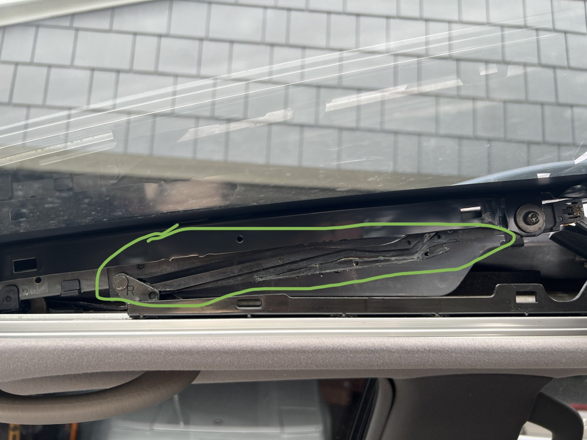

The rattle comes from the plastic guide/lift mechanisms on the sunroof. Whether or not the guide is actually worn? Or if it’s just like that from factory? Who knows… I did not pull the whole sunroof down yet.
To see this movement, move your sunroof to tilt/closed and in several positions in between with black trim pieces removed, and watch this part while you push up at every position. Mine is very obviously coming from the plastic guide.
Adjusting your seal or replacing may give it enough friction to reduce up/down movement but I do not think that is an actual fix. If the seal were causing a rattle the glass would be moving side to side or fore/aft, not up/down. If you have a leak, clean your drains. The seal isn’t there to keep 100% of water out.
