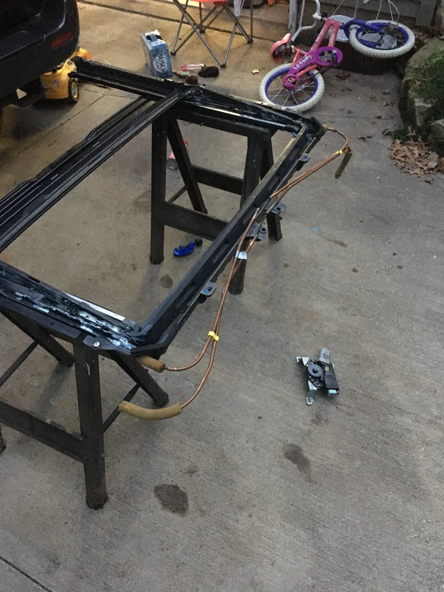

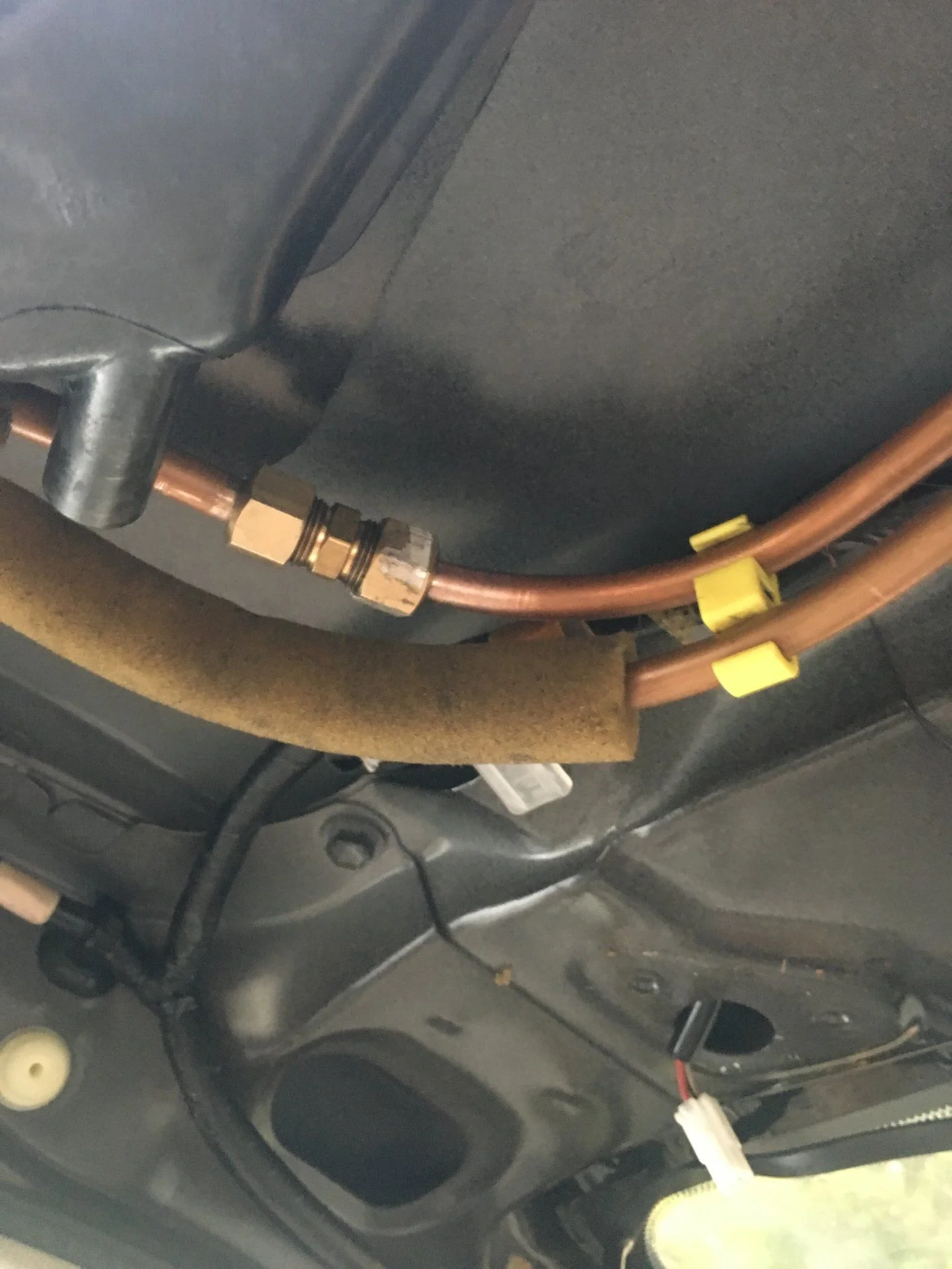

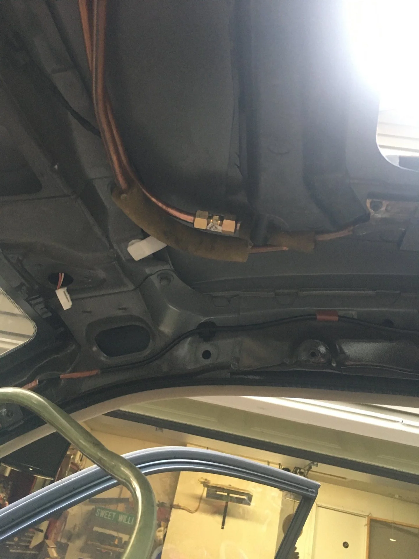

Well got it back in pretty easy. Initially I tried to use some fuel line and hose clamps to hold the copper tubing together which was a massive failure with all the grease. Quick trip to the store and 8$ later I settled on some compression unions to bring it all together. Its kind of noisy but gets the job done. Beats 600$ in new cables and guides
nice fix... thanks for sharing.

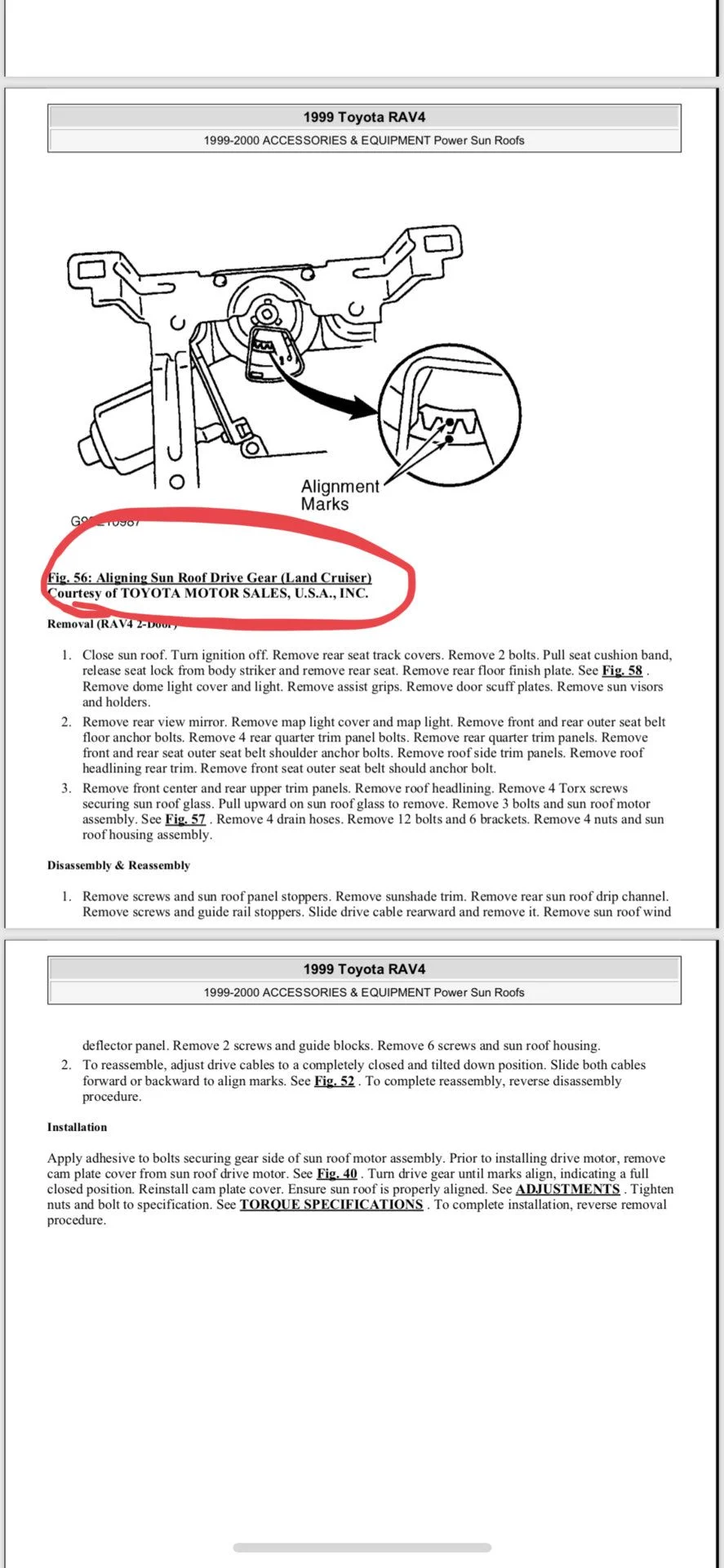

Nice work! When I worked on my sunroof few years ago, I ended up just buying a new assembly system. Too much gunk in the track system. So, nice work to save some $$$! Little too late for you but back when I was working on mine, I found some doc regarding sunroof disassembly and assembly for Toyota cars including LC. I think page 72-75 for LCs. Attaching excerpts Pic as well.
