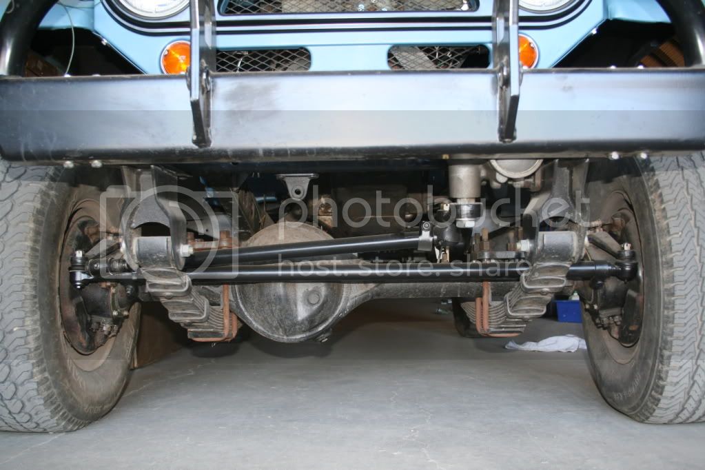

with 4" lift. I like running this setup. FJ60 tie rod ends, with lower FJ60 relay rod end and GM 1 ton high angle relay rod end at the pitman arm. Pitman arm is early wagoneer reamed to fit the GM. This is a 4~5 inch lift

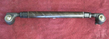

Looks beefy! What tie rod is that? FJ60? Sorry for the hijack!

Thanks for the info and the pic. I think the sag box on mine sits higher than the one you show but it seems like there's lots of spread on my setup. I'm not really sure why??

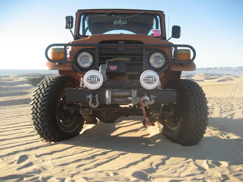

Here's a pic of how close the high steer setup was to the frame when installed. (it's all I've got on my phone).
