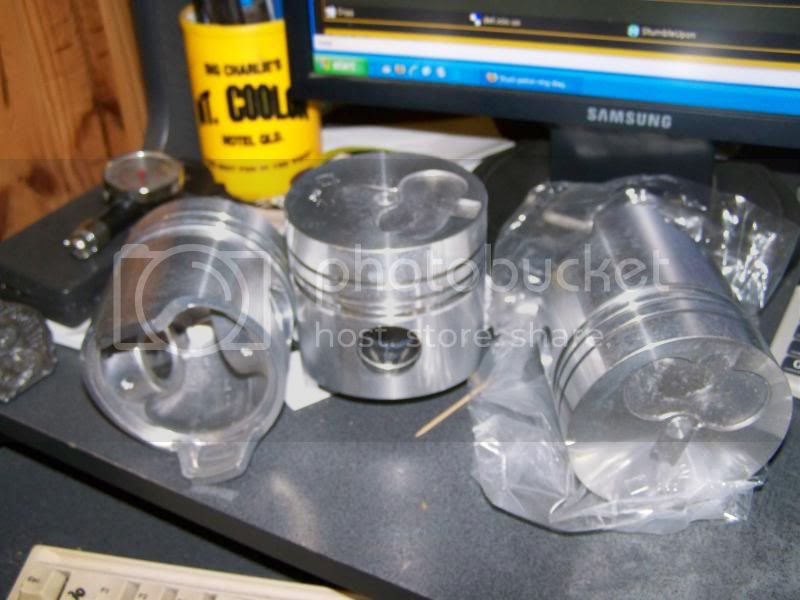

Cheers, these are a set of over sized pistons for a 2H with the steel insert that you have mentioned. pic is a bit shiny but you can see the insert at the bottom of the middle ring gland. These are Hypatec Pistons in the pic. If you take your piston in to an engineering shop so they can measure it up for dia and height also need the rod connection size and rod connection position location in the piston then they can get you a forged piston that will be better quality than the Toyota piston. cheers gazza

Here a set of Hypatec pistons and rings for the H motor are AU $729.00 but they are only available as oversize 20 and 40 thou for the H. What ever you buy make sure they have the steel " Alfin Insert" :cool: in the north we call them turbo pistons ;):hillbilly: [don't confuse with 12HT pistons,different again]. cheers gazza

Yes mate, you missed the point we all know there was never a turbo version of the engine. quote,, In the north we call them turbo pistons... that is Oz slang or common useage for non technical version of "pistons with Steel Alfin inserts" Probably more correct would be local slang.
Further Precision Industries make a standard size in their "Hypatic Piston" that has the steel Alfin insert. As in the PM I said this single piston and a full set of rings is $660.00 here. Expensive as not many are made.
