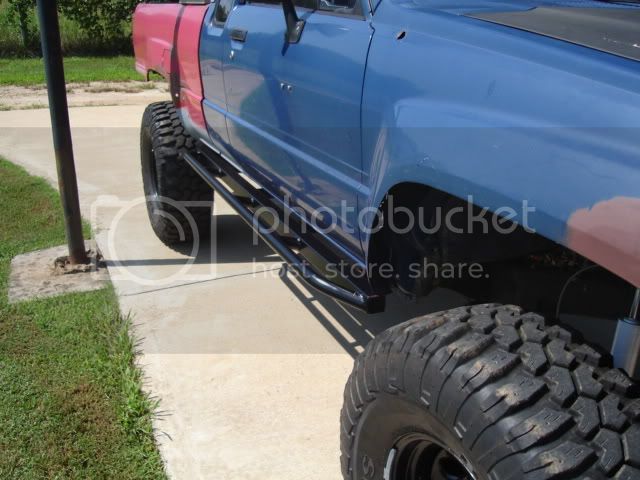

I've gotta set of the square/round type on an 85 ext truck. I had him change it a little for me... beautiful welds, shipped on time, great service. Did have one small issue with one of the legs landing on the curve of the frame but Stubbs took care of it. First class guy! Made it right and I'd buy again from him, no question. Beefy, 1st class stuff!!

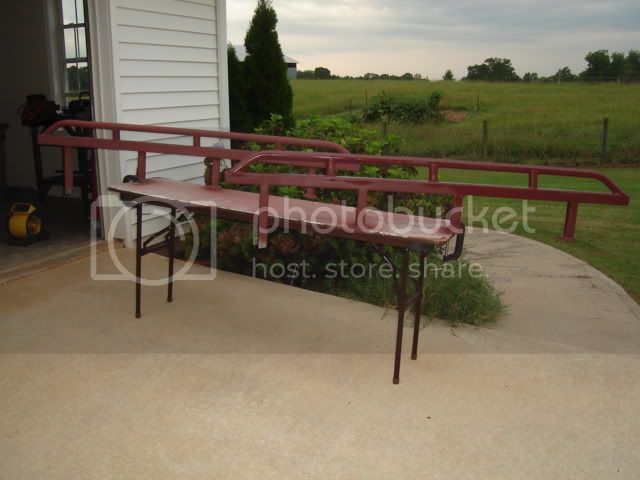

I am planning on slitting the tubes and welding in a large vertical section of plate. then welding 90 degree brackets onto the frame on both sides of said plate and then bolting through them on in a giant sandwich style mount.
this will load the bolts in shear instead of tension. (1 grade 8 half inch bolt in single shear is good to about 15000 pounds. i plan on using a few per leg)
so it should be good.
this will allow me to remove them if they get bent or just need a paint job. or when i get around to painting my truck they can come off.
also, if i sell the truck the new owner has the option of removing them all together if they dont like them. (thats a little bit of a stretch though as i dont plan on selling it):)
