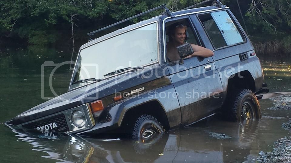

A few weeks ago they went crazy as well, came on for no reason. Also my edic was freaking out. However that probably had something to do with the nitnat river coming up to my passenger seat and the entire r/h front corner of the truck getting a nice wash:bang:
Sounds like a pretty serious water crossing...pics? :hmm:
Wasn't so much of a crossing, I was trying to skirt the edge of the river where it was shallow to avoid some low hanging branches. But the bank was softer than I (rather optimistically) thought.
