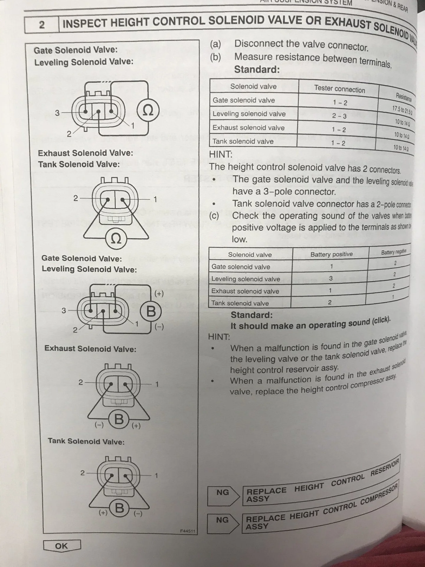

Finally I noticed the tank solenoid would repeatedly go on and off while dropping down very very slowly, in starts and fits. I finally decided to take my own advice after I found an old thread where I helped a guy by telling him to reset his ecu. It seemed to fix the solenoid popping on and off. But I still have a code 44 which is the tank solenoid. The symptom is a very slow lowering. It was like that from the day I purchased it. I might try to blow out the lines and do a quick check with the dvm.
I think I’ll be on the lookout for a good used height control reservoir assembly if anyone has one laying around. The entire thing needs to be replaced if the solenoid is going out.
