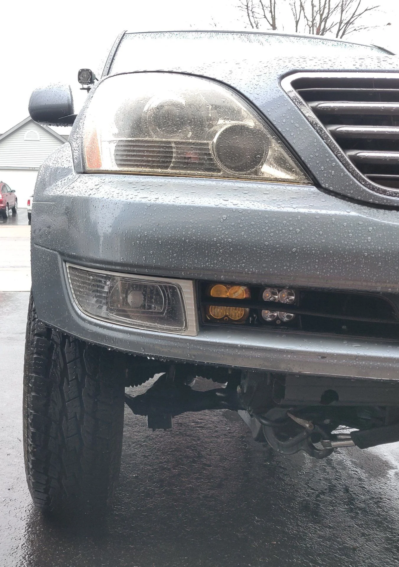

On the front there are metal "tabs" that hang down and if you want a clean look you will need to take an angle grinder to them.

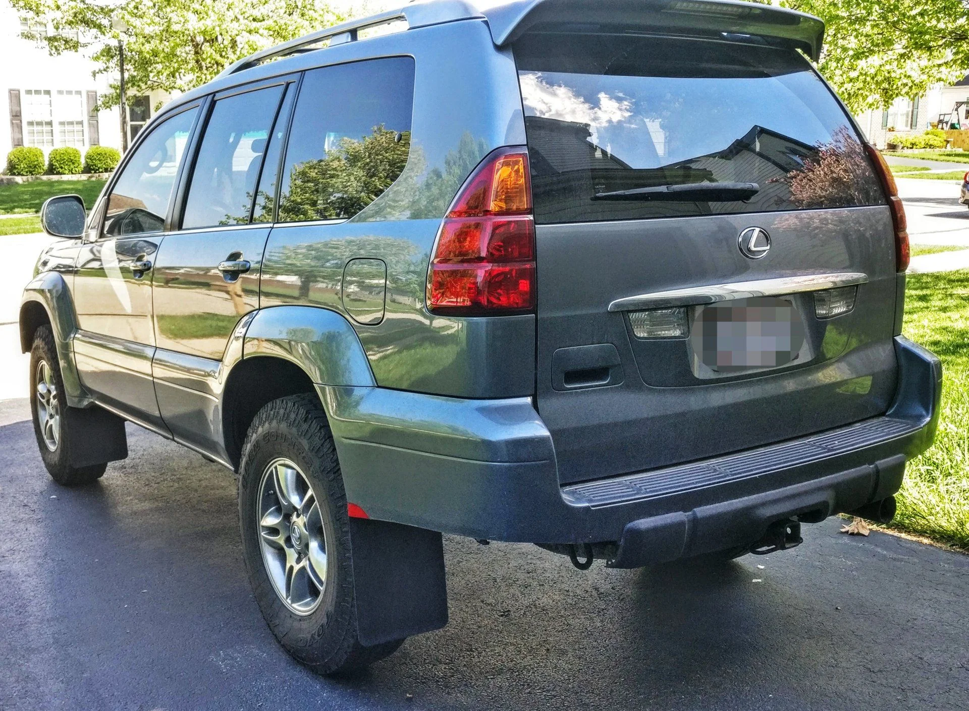

I did cut it as high as possible. The crash hang a bit lower and intended to work as a slide over obstacles.

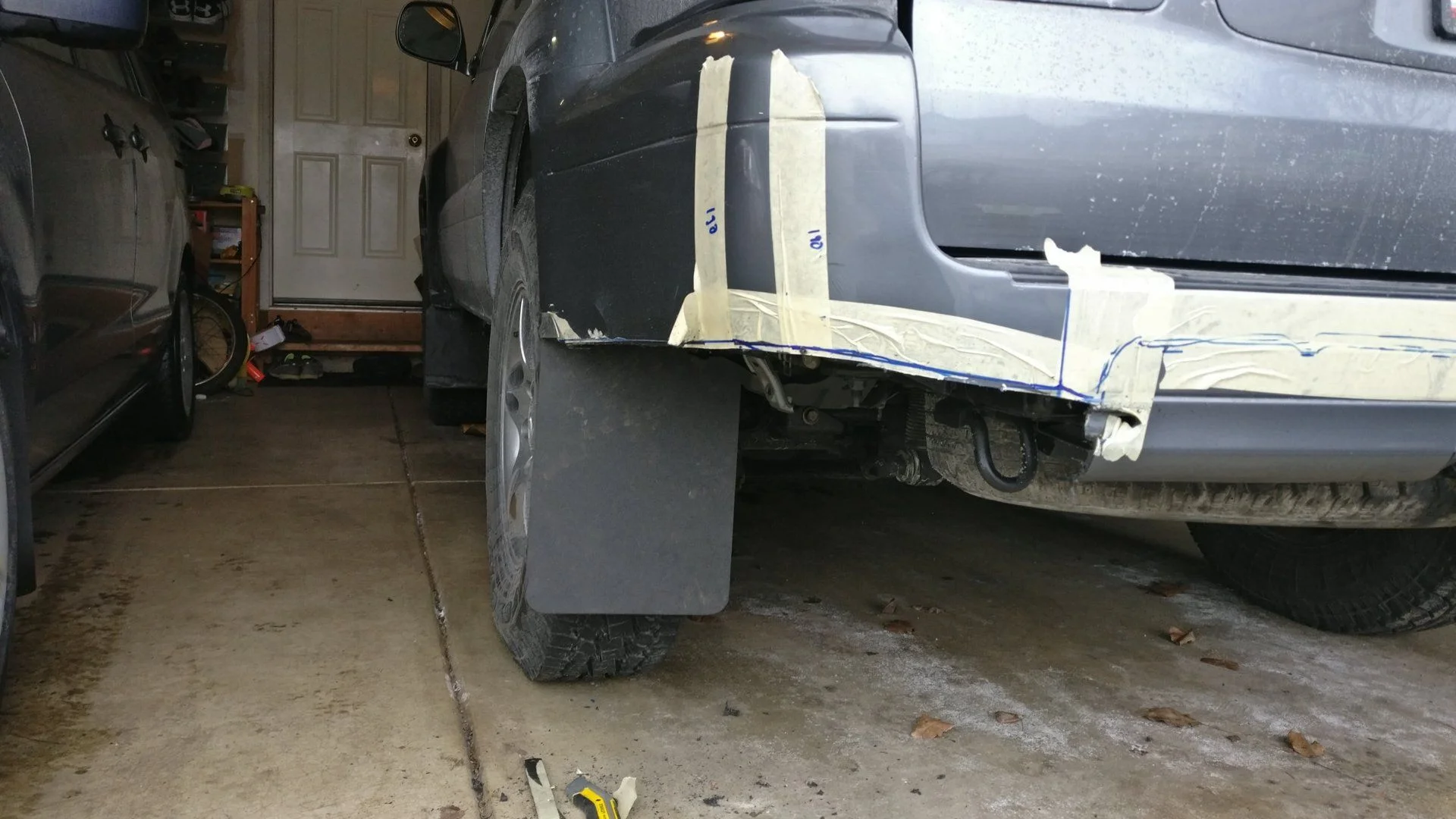

My mockup. The vertical line is measuring distance from more distinctive body lines.
The OEM mudflap cut was filled using thin aluminum strip that also function as new truck style mudflap hanging bracket. It takes too much effort to match paint color so I just use reflector tape to cover it.
