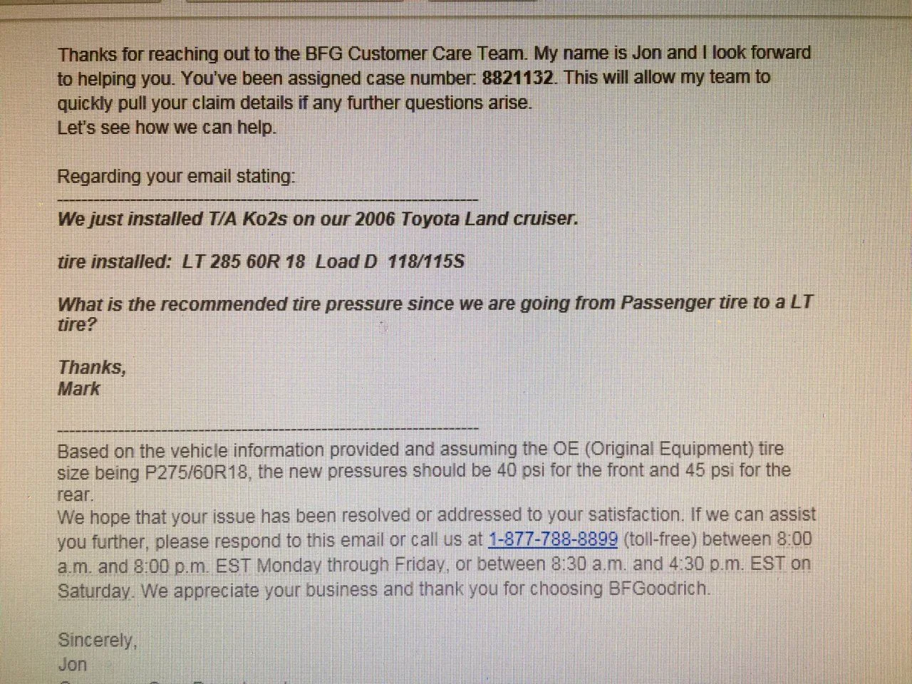

New 200 owner but also have a 2006 Land Cruiser (all stock). Not exactly related to the 200 but we just put KO2s on our 06 and went up a size from 275/60R18 to LT 285/60R18. When I saw all this traffic related to psi on LT tires, I sent BFG an email on proper psi. Below is the response: 40 Front and 45 Rear. OEM with Passenger tire is 29 front and 32 rear for reference.
I get 39psi Front / 42psi Rear for the LT285/60-18 tires as more exact equivalants to the OEM P275/60-18 pressures. Since the industry standard references only cite Load Limits in 5psi increments, and they are not strictly linear, it is totally understandable why BFG rounded 39psi up to 40psi and 42psi up to 45psi. All basically the same, and I agree with BFG's numbers.
