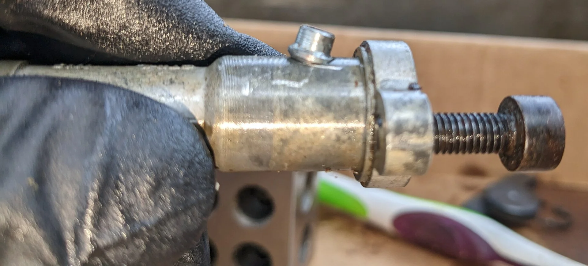

I really appreciate this thread. Been trying to get my grandfather's o41 working...and it was leaking oil out the front. Regarding this picture below, what are the the little metal nipple's called? (edit: bushings). They look a bit like mushrooms. Which way should they point? Actually, are they even necessary? Because when I try to put that boot on, regardless of which way those 2 nipples are pointing, the boot protrudes way too far out.
I've tried both ways, and the boot just doesn't lie flush.

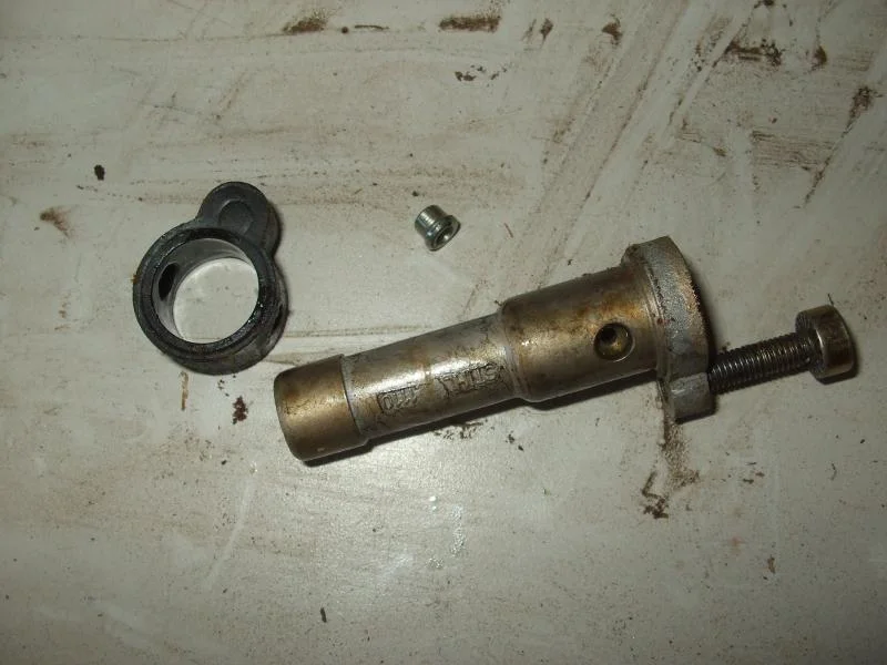

I think the picture without the boot is how they came out.
According to this parts diagram, (you have to register to access it---i added it below) it only lists 1 bushing...and it appears the larger diameter seats up against the pitson housing...(mushroom cap points towards the oil piston)....actually...are these supposed to be on the OUTSIDE of the boot ? that parts diagram has one bushing but one could conclude it's on the outside of the boot.
Did someone add an unnecessary 2nd one? I've got 2 holes on either side.

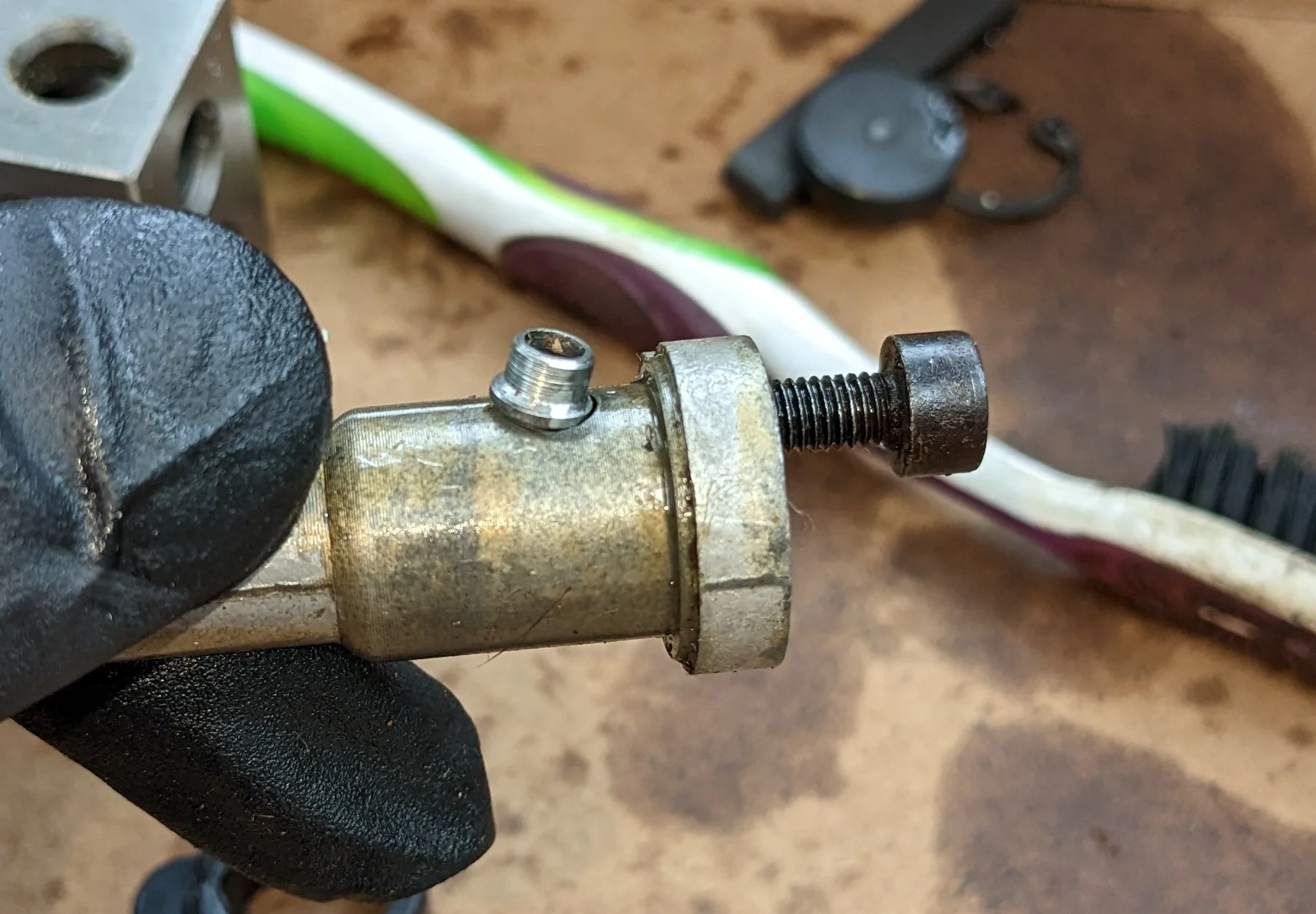

Yes, the bulge is what led me to ask for help.
I tried them both ways, and at that point instead of forcing something I thought I'd ask for help.
For the record, the bushing goes under the boot?
And the larger diameter goes into the oiler?
Thank you for your help.

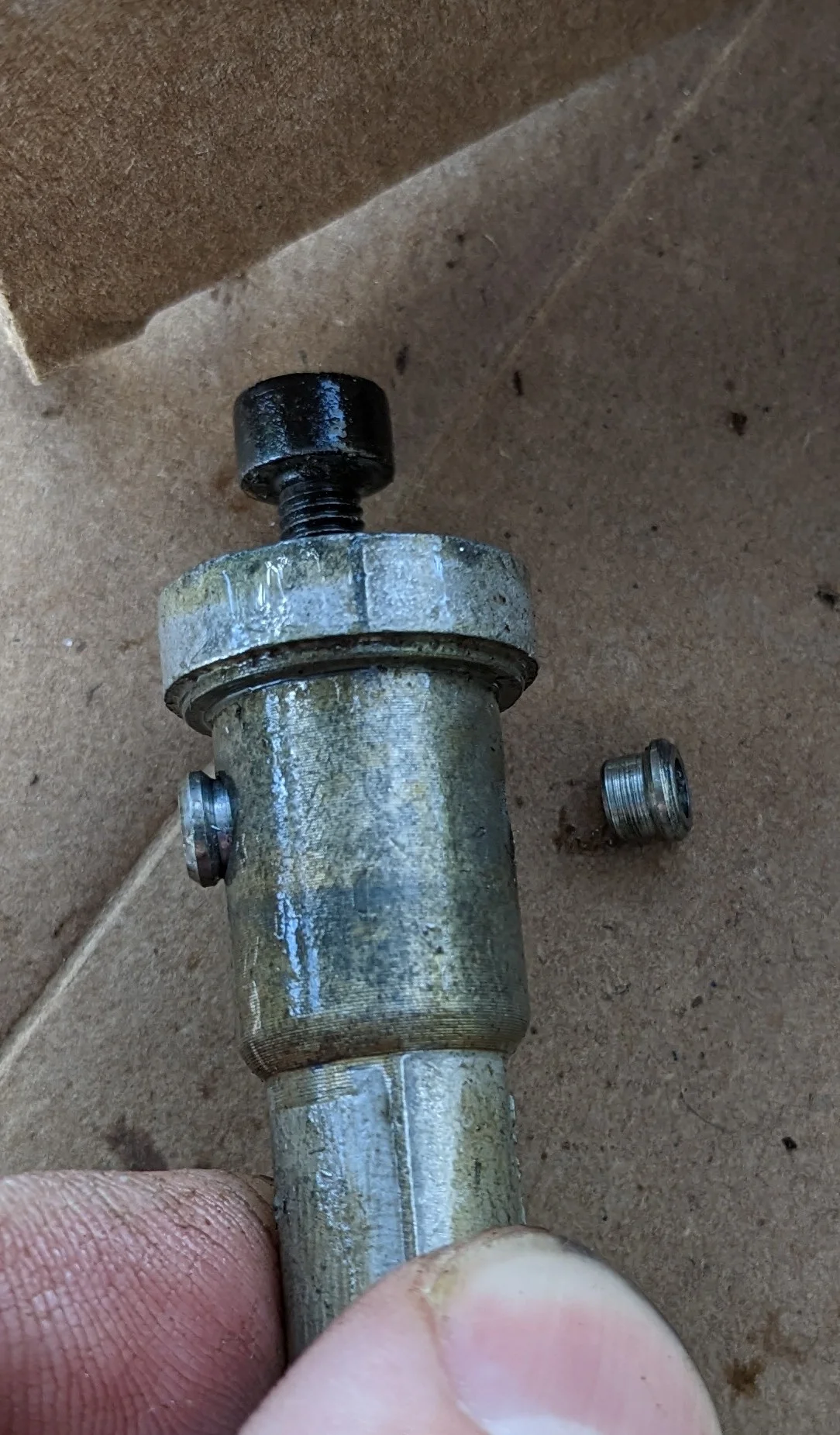

I am beginning to think that whoever put this together last not only put the bushings in the wrong orientation, the large part of the bushings was not in the housing, I think they put in the wrong bushings.
Setting the bushings in the correct orientation does not seat deep enough to clear the end of the oiler housing.
The length of the bushing is exactly 4 mm, but shouldn't it be in standard US?
The large outside diameter is just a shade above 5 mm, or a bit over .22 in
If I'm right that these are the wrong bushings, what do you think I should do? There's a part of me that wants to just take him to the belt sander and make them fit.
