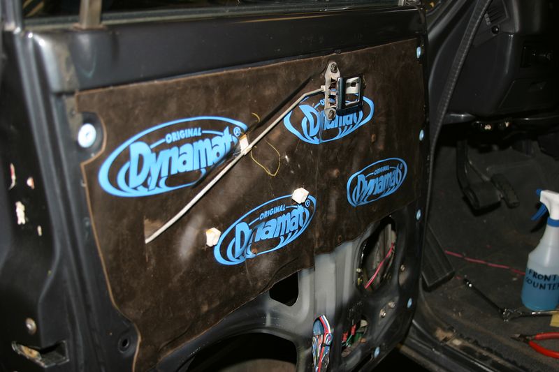

I also had just a few photos from my old FJ62 install...so what types of systems is everyone else doing? My only advice is that I love to mount the tweeters in the kick panels facing up at a angle up, so it gives a good front imaging and the sound stage is from the front.

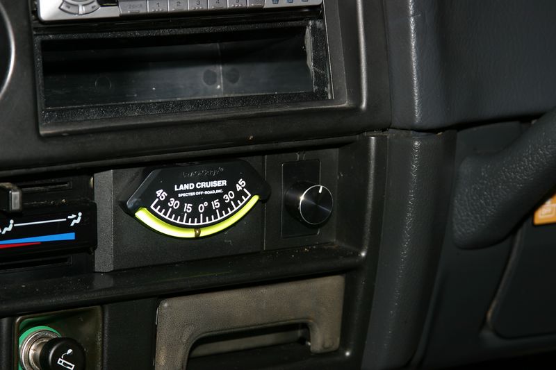

I also use dynomat on the doors, IMO it makes a big difference. I always try and add a knob so I can adjust the Bass on the fly. It basically controls the gain to the amp running the sub. I usually run a sealed box with a 12 inch sub.

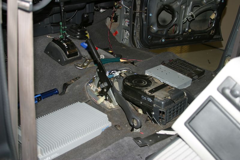

A/D/S – PH15 Six channel Amp 6 x 50 watts
A/D/S 642CSi – Active Cross with Remote Bass control

Sub control and box:
Amps and cross overs under seats:
Dynomat:
