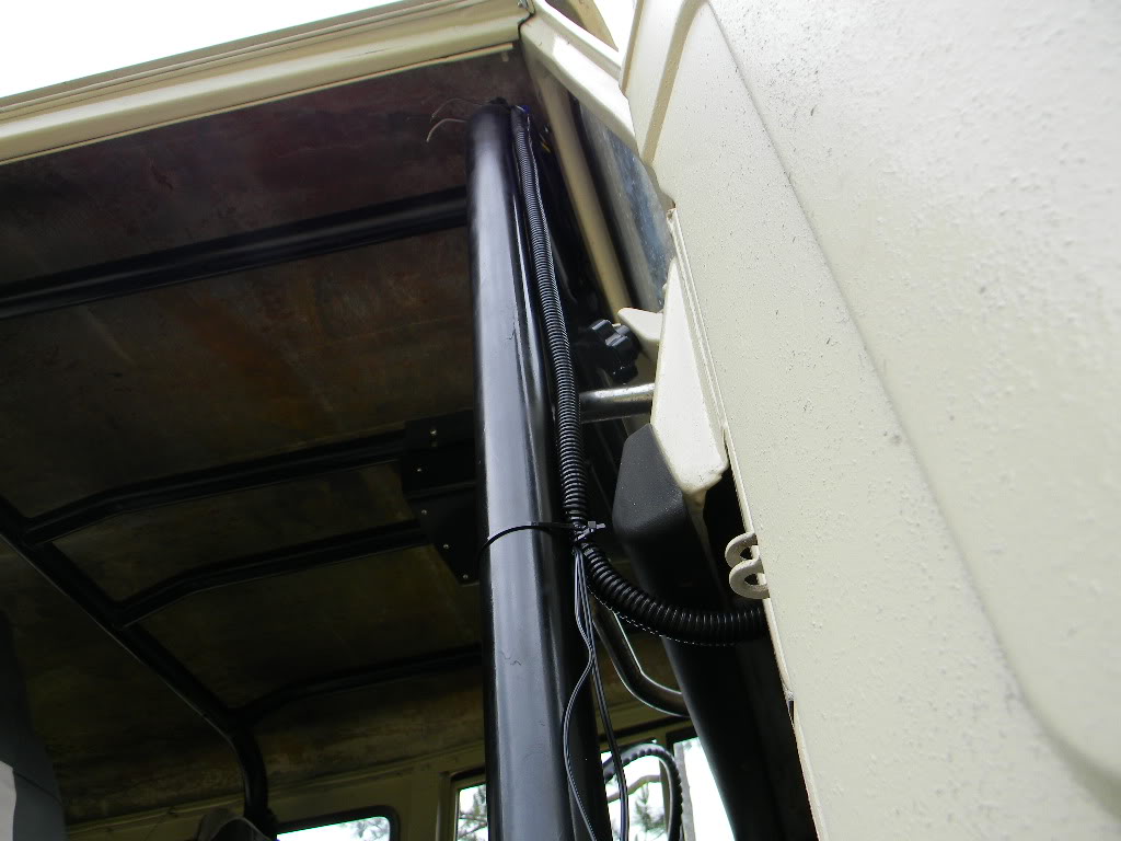

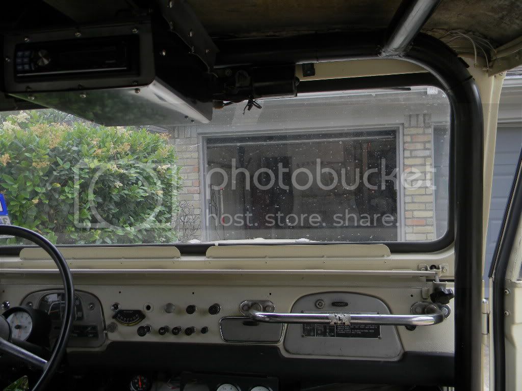

Where are the wires?
Tucked nicely in front of the cage with some split loom and zip ties

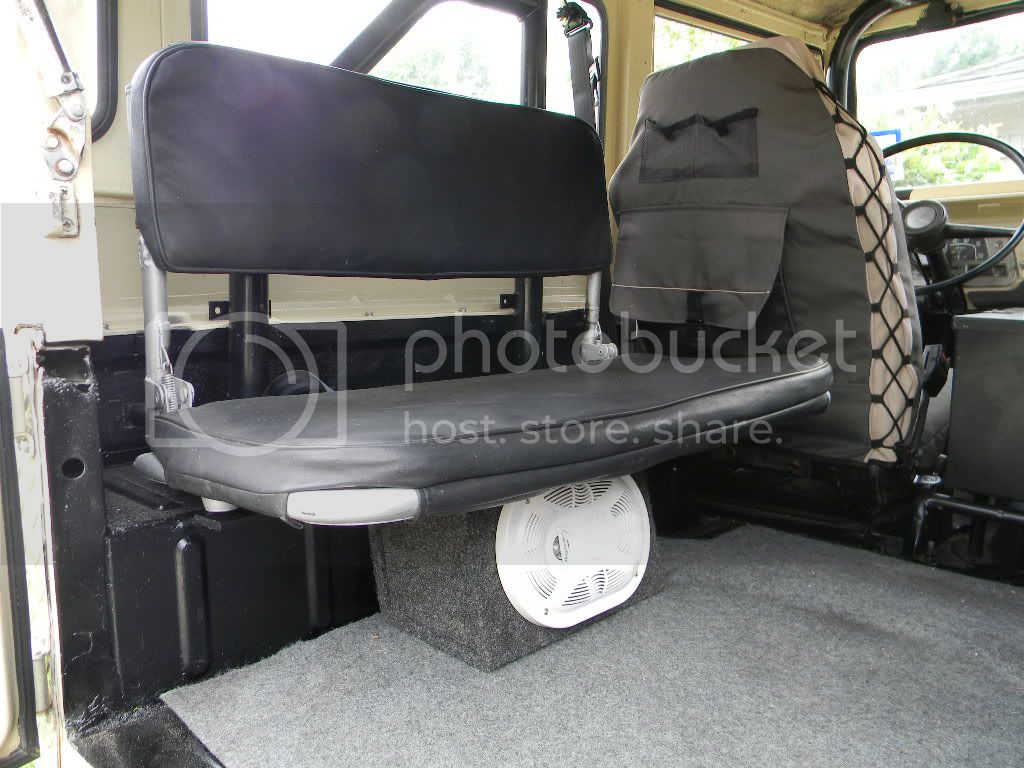

Rear speakers mounted
They barely clear the lowered jump seat. I might paint them black or tan to match the truck better.

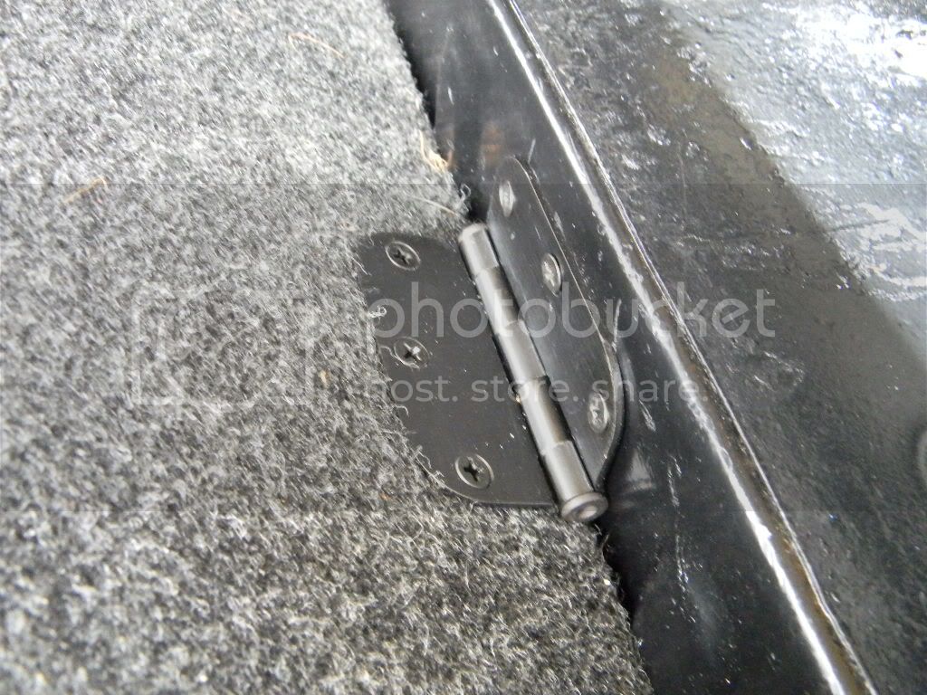

I have them hinged on the top in case I need to lift them for cleaning the tub or hauling something larger when I need the room. They're screwed through the tub on the bottom.

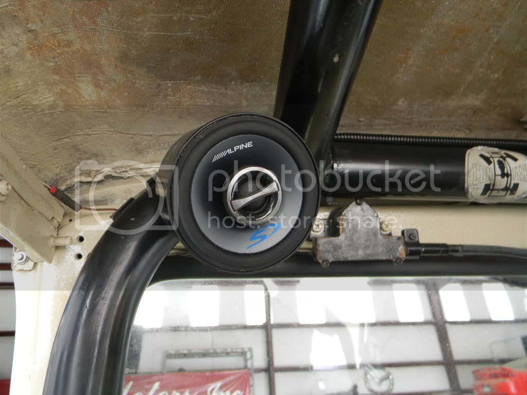

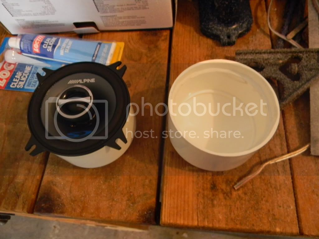

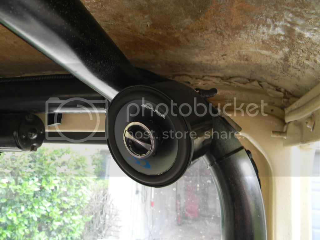

For the front speakers, I found some sweet Alpine 3" coax units that fit perfectly in a 3" PVC pipe cap. I did have to grind out about half of the PVC thickness at the opening, so I used my handy Dremel tool.

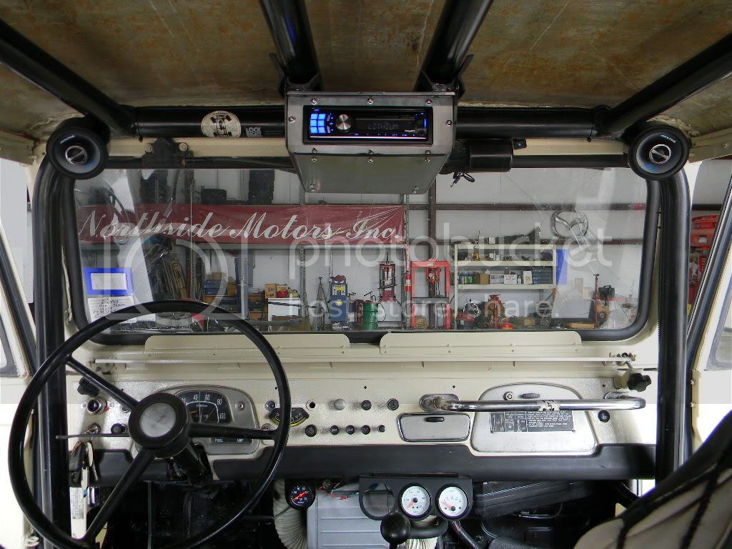

Front Speaker Pods

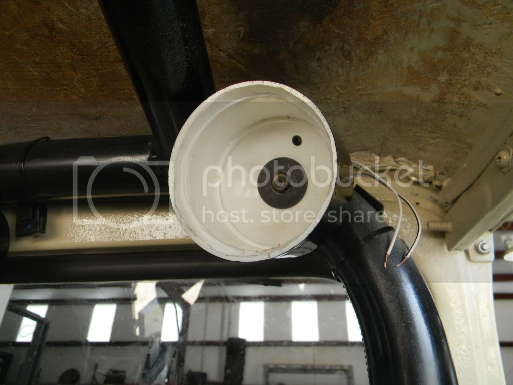

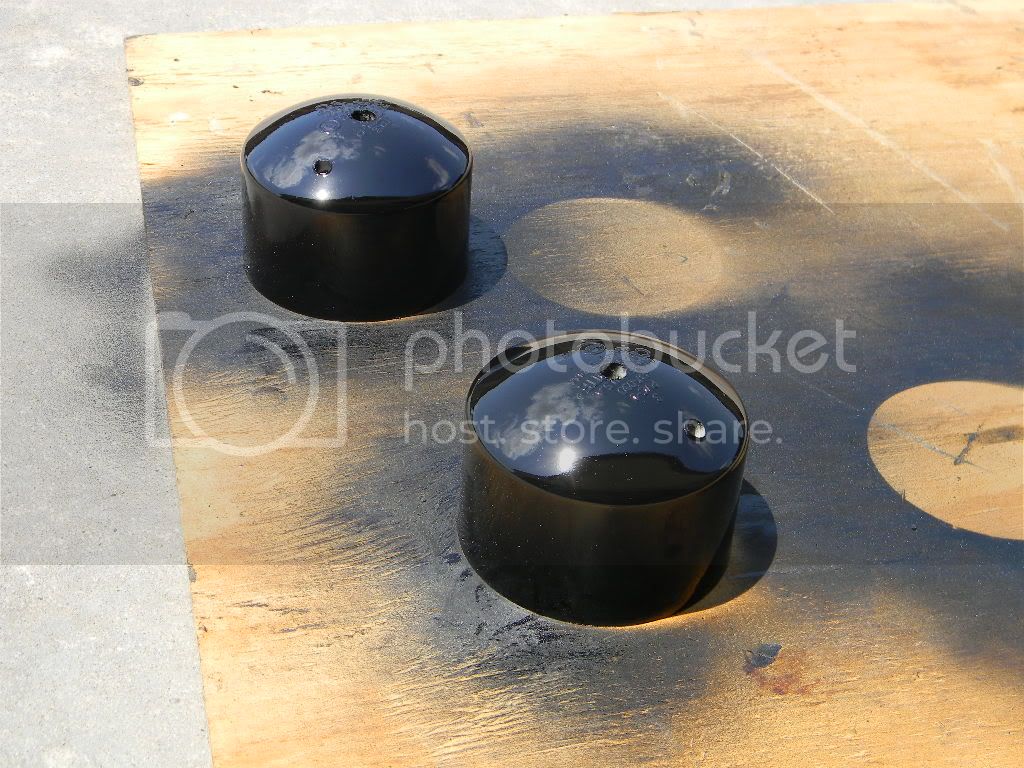

The PVC pods drilled for mounting bolt and wire feed-through, and painted black like everything else.

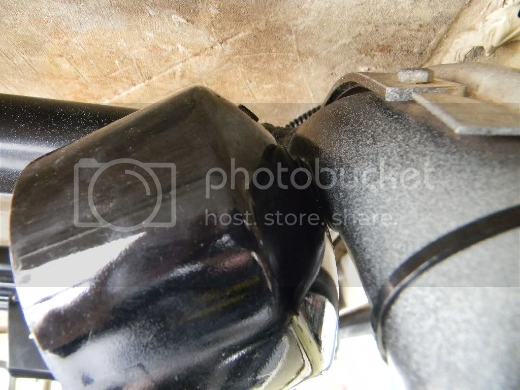

I drilled and tapped holes in the bar for mounting. The pods are light and strong, so I have them bolted in with a single bolt and fender washer to help keep them centered and distribute the vibration loads.
There is also a grommet on the backside for the same purpose.

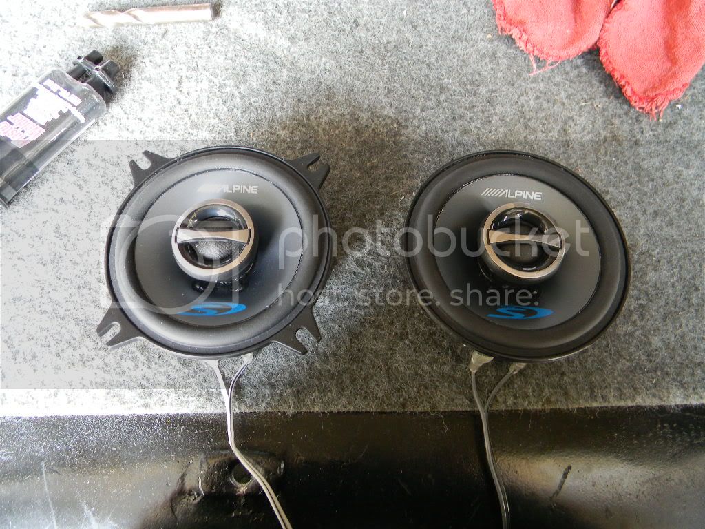

I cut off the little ears on the speakers because I don't need them and they look funny.

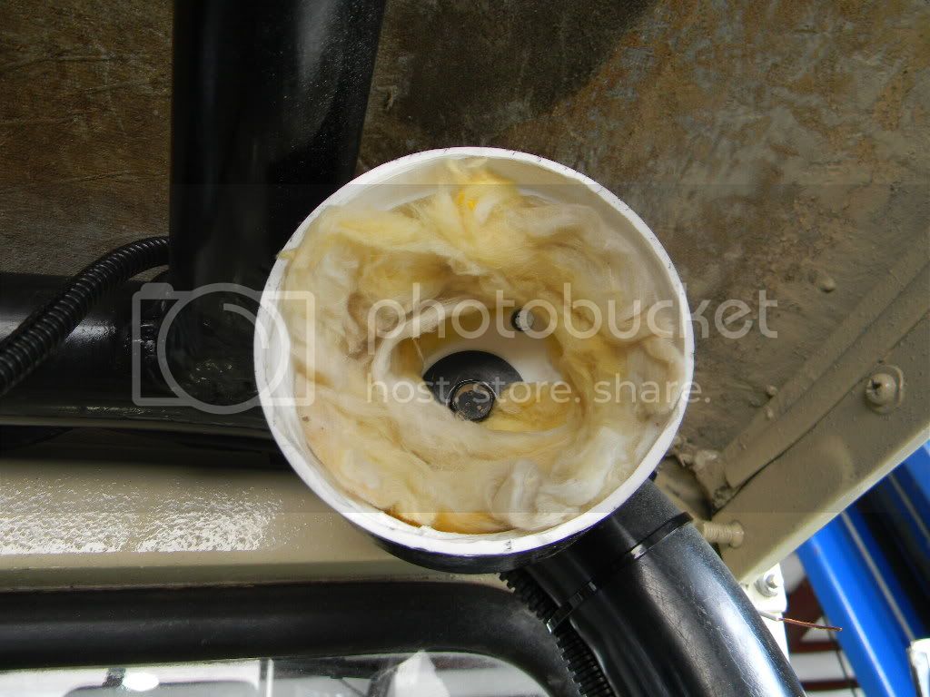

Filled the pods with insulation to help augment what little bass they will produce.
Used some Plastic Welder epoxy around the front edge of the pods and put the speakers in permanently. More split-loom and zip ties, and she's good to go.
Total cost for front speakers and install was less than $100. :cool:
