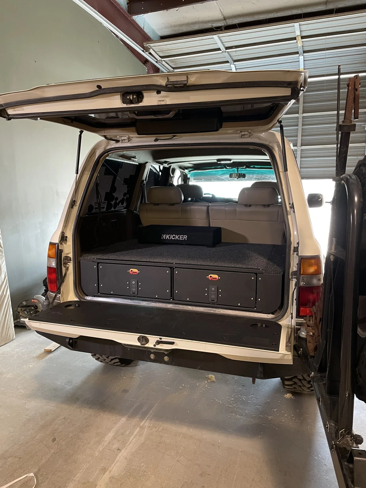

Sounds a bit complicated. But everyone has there way of looking at things. Last year I did the upgrade. Dash speakers had been previously disconnected as had console subwoofer (LX450). Factory speaker covers long gone. New JVC double din has very nice screen (Pioneers were not available) and I think in the 25-50W range per channel. It’s nothing special. New 6.5” Focal speakers in the 4 doors with good sound deadening throughout with the install. The real money was including the Kicker subwoofer and amp. This box (pick below) is very stable as long as 3 out of 4 wheels are touching the ground. It’s been well tested off road. I am extremely happy with the setup, on road and off. Interestingly, new wire was not run with the install which was a mistake. I have had some shorts. That’s being taken care of now.
