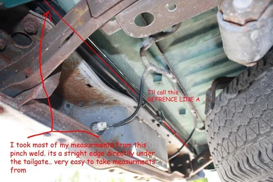

well i'll start by saying i know that there are several posts on various diffrent web sights about bobbing a bed.. and i relized that none of them really went into detail about the small stuff.. like measurments, were, how much, exc.. so i thought that i'd TRY and do a post with more details instead of the usual " this is my truck, this is my truck after cutting, this is it all welded back togther"
so here we go.. mind the typo's

actually after doing all the cutting .. i reccomend measuring at liest 1" to 1-1/2" from the spot weld A location because the cut was right on the cross member. and was kinda difficult to place a flush scrap under the bed to take up some of the gap made by using a cut off wheel.. i had to use a cut off wheel because the spare tire cross member was only 1/2" below the bed floor
