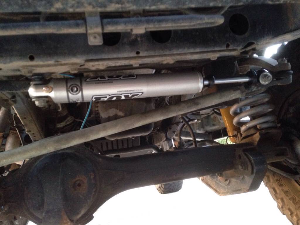

I bought a FOX stabilizer, thinking i could bolt it in, but not so lucky in my 94 80 series.
steering stabilizer part # 985-24-063
Fox 2.0 Performance Series Smooth Body IFP Stabilizer
the new one has an eye diameter I.D> of .5" and the Stock bolt that was holding on my OME one is .625" dia.
also, the rubber bushing is about a 1/4 wider overall than the OME.
Now I need to find new bolts to replace the stock ones. smaller in dia. and longer on sleeve side.
Anyone?

I ordered a set of poly bushings from Kartek that Fox sells.
Parts are .625 x 1.3" part # 014-11-003-A
Swapped them in and it seems to work. Will give it a better go this weekend.
it works good. But I think it's too short.
When I compared the OME one to this one, the lengths were different by about 2".
It feels like I don't get that last 30 degrees of steering wheel rotation...it stops short.
so for those few times you really crank it onto the stops at full lock, it's bumping on the rubber gaskets on the shaft, and not hitting the lock out bolt on the front hub. it's probably safer on the shock, but that 1/2" I could really use.
i mean, who couldn't use an extra 1/2 "
Hey OOHHH!!!
the OME has a 9.25" length from full compression to full extension. overall length is 16.5" comp, to 25.75" ext. ( me measuring my old one on the bench in the garage)
this FOX model I got says (per their website) it's an 8" length. Full comp at 15.85" (.65" more compression) and 23.9" full ext. (1.85" less) shorter than the old OME.
they make a 10" one, but the compressed lengths aren't near the OME, so I'm not sure it'll work perfect either.

I have a custom mount on the drag link using the OME bolt and used the other OME bolt that is mounted to the plate that bolts to the front crossmember. I just bolted my Fox stabilizer straight on. The only drawback is that the bolts are a tiny bit too short.
I did research and measured the distance traveled by my OME stabilizer before I took it off and although I don't remember exactly, it was around 7" so the 8" Fox stbilizer doesn't limit my steering at all. But my steering is full custom and I had to give up a little lock to lock with the Hellfire knuckles and no coil overs. FWIW

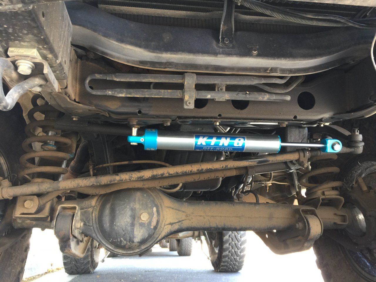

what bump stops are you using?
got a KING part #?
did it come with the bolt for the chassis mount too?
uhh, yeah..300 bones for that? ouch.
7 hundy for bump stops?
will need to pick up a paper route and wait for the group buy at christmas...
