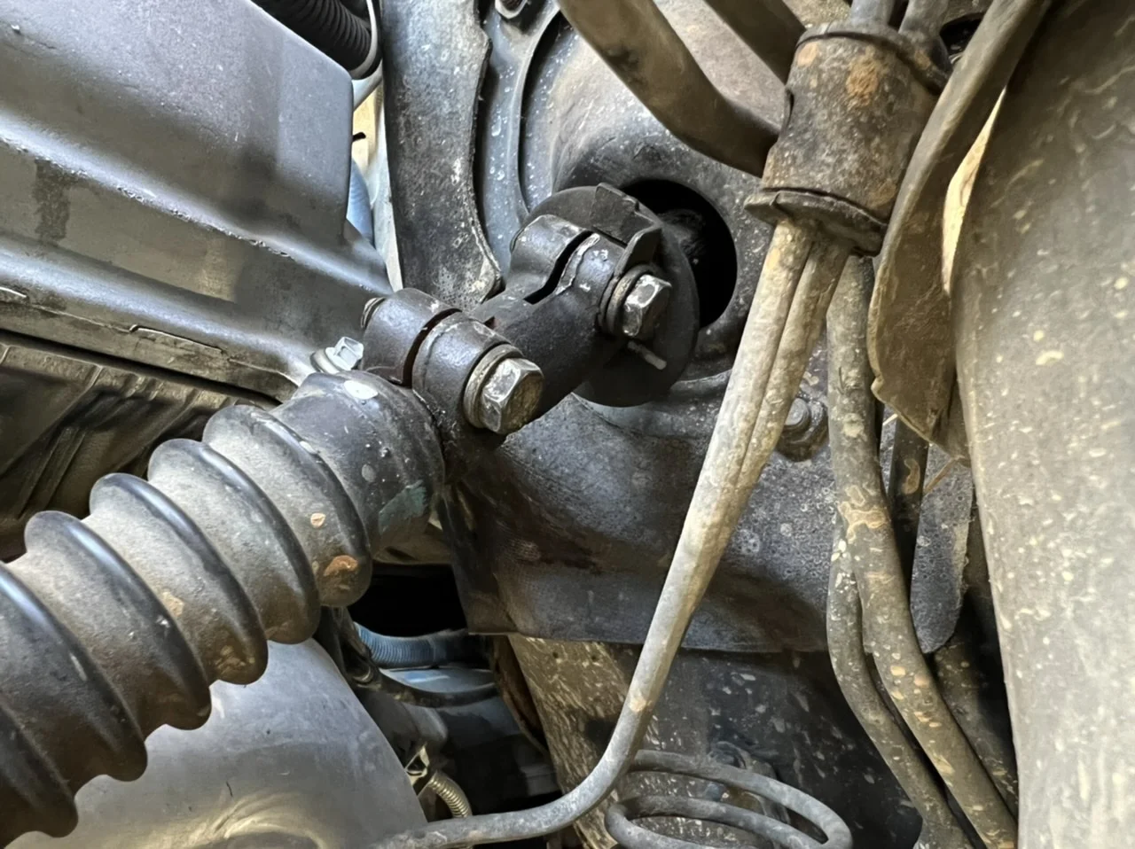

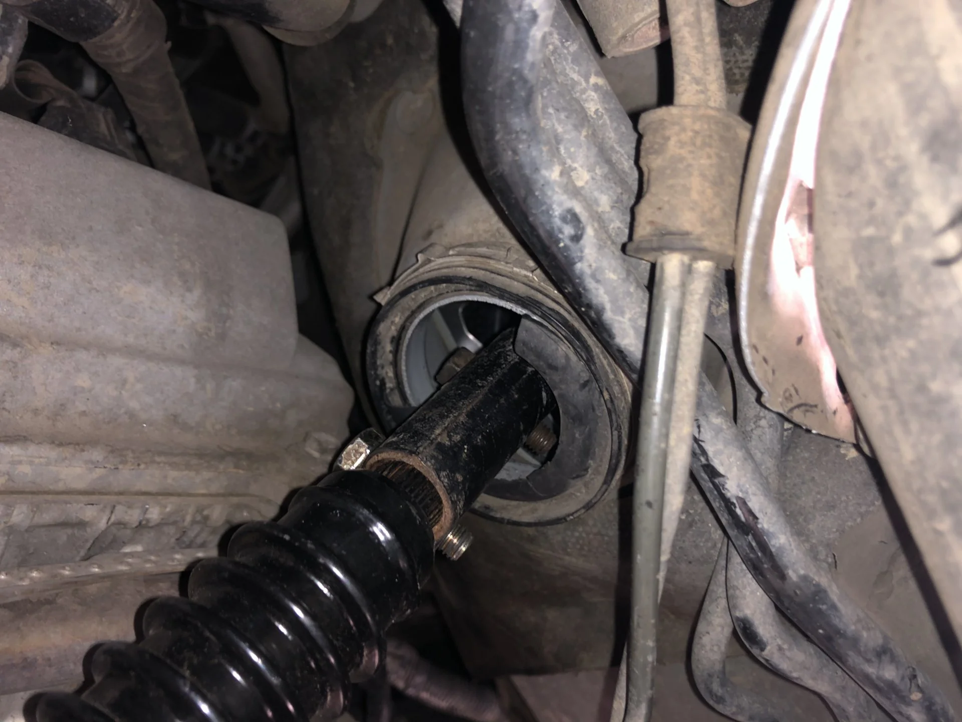

Hey guys, just recently swapped my 06 LX steering shafts over to the LC equivalent while changing steering rack. Did this to get rid of the pesky VGRS system, as the ECU has presumably been bad for years and I have had a tilty steering wheel. Mechanically everything bolts up and I have a straight steering wheel now. But I'm having a small issue. The connector between the upper and intermediate shaft did have to be slid upwards in space (towards steering wheel) as the relative lengths of the two shafts are different between VGRS and non-VGRS. The upper shaft is shorter and lower one is longer now. The upper bolt on the connector is making a little bit of contact on the firewall tube in certain positions and I can see the intermediate shaft moving a little bit when I turn the wheel. Not possible to slide the connector more than a few mm.
Am I missing some sort of centering sleeve or support? Any advice here?

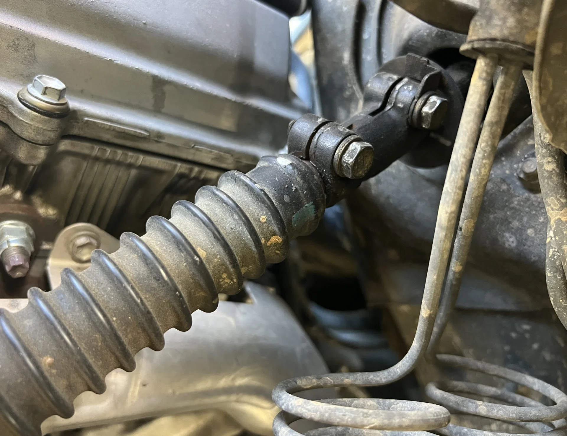

Can anyone with a LC take this same photo for me please?
I’ll have my cruiser on a lift tomorrow and will try to remember to take a picture.
The intermediate shaft when all the nuts are loosened should be able to towards the steering rack or towards the steering wheel. It looks like you have it as far towards the steering wheel as possible.

Sorry didn’t get around to getting on the lift yesterday. Here is the view from side. Let me know if you need any other views.

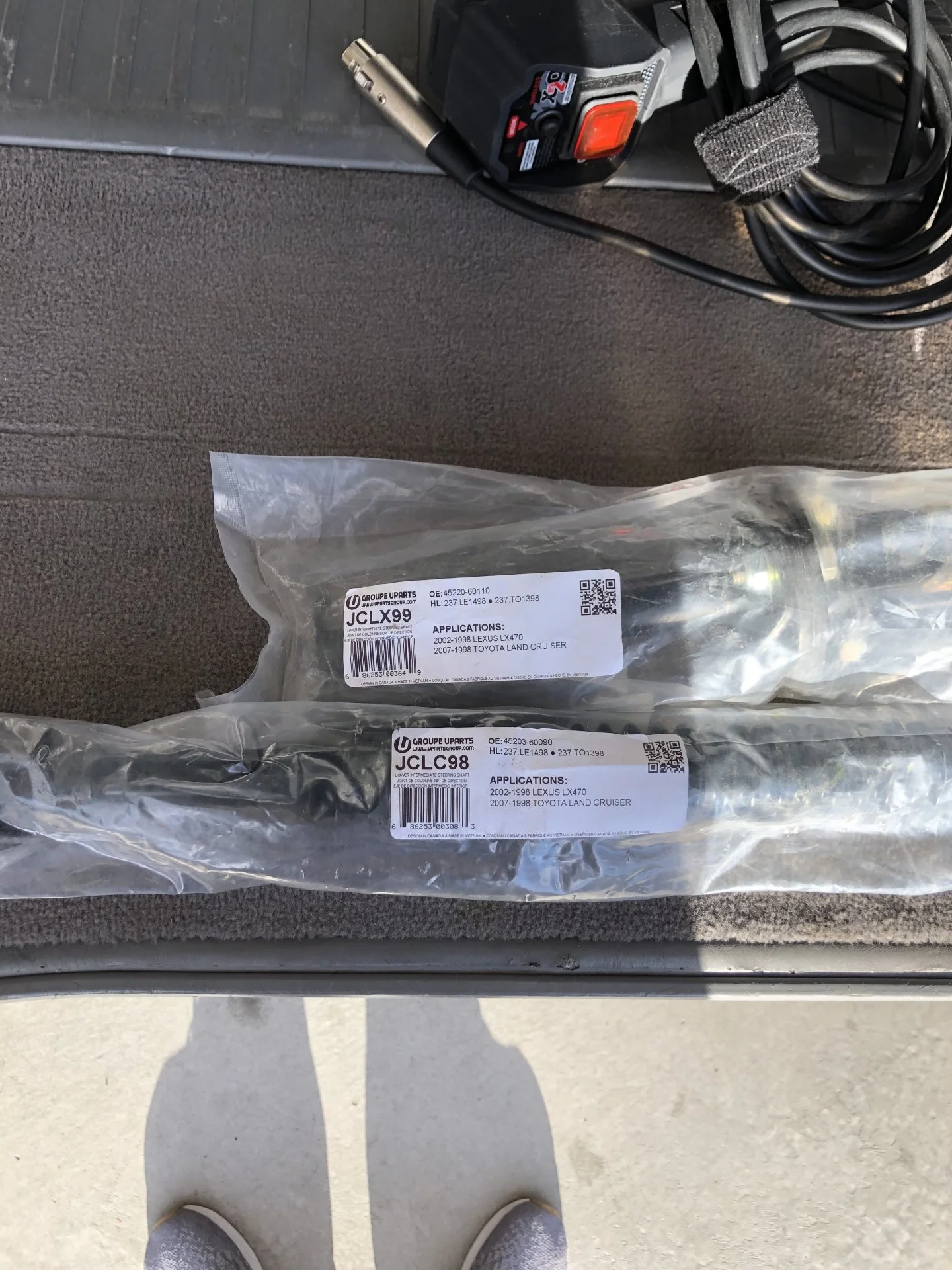

Do you still have the part numbers handy for this?? I'm interested in deleting my VGRS as well as it's time for a new rack soon.

Have time set aside this Thursday to check it out. I don't think the connector will slide and still be able to clamp onto both shafts. Either the opening in the firewall will need to be enlarged, or maybe weld the connector onto the upper shaft and remove the bolt.
