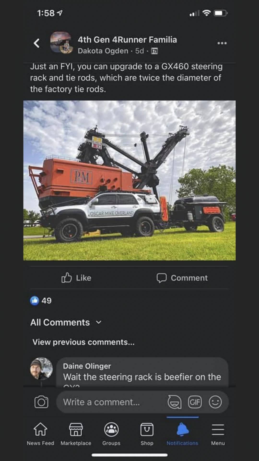

Doing a little more research and found this
edit: did a little more homework and looks like the lc200 is the better uograde
150 series rack will bolt up mechanically. It's the stability control that nobody knows for sure yet.
200 series rack will only fit RCLT equipped vehicle or at least other long travel suspension. Nobody found a regular tie rod that will fit for the much narrower stock suspension yet.
