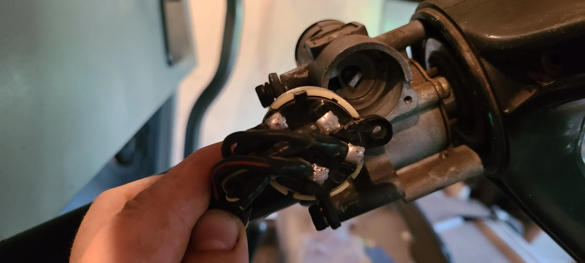

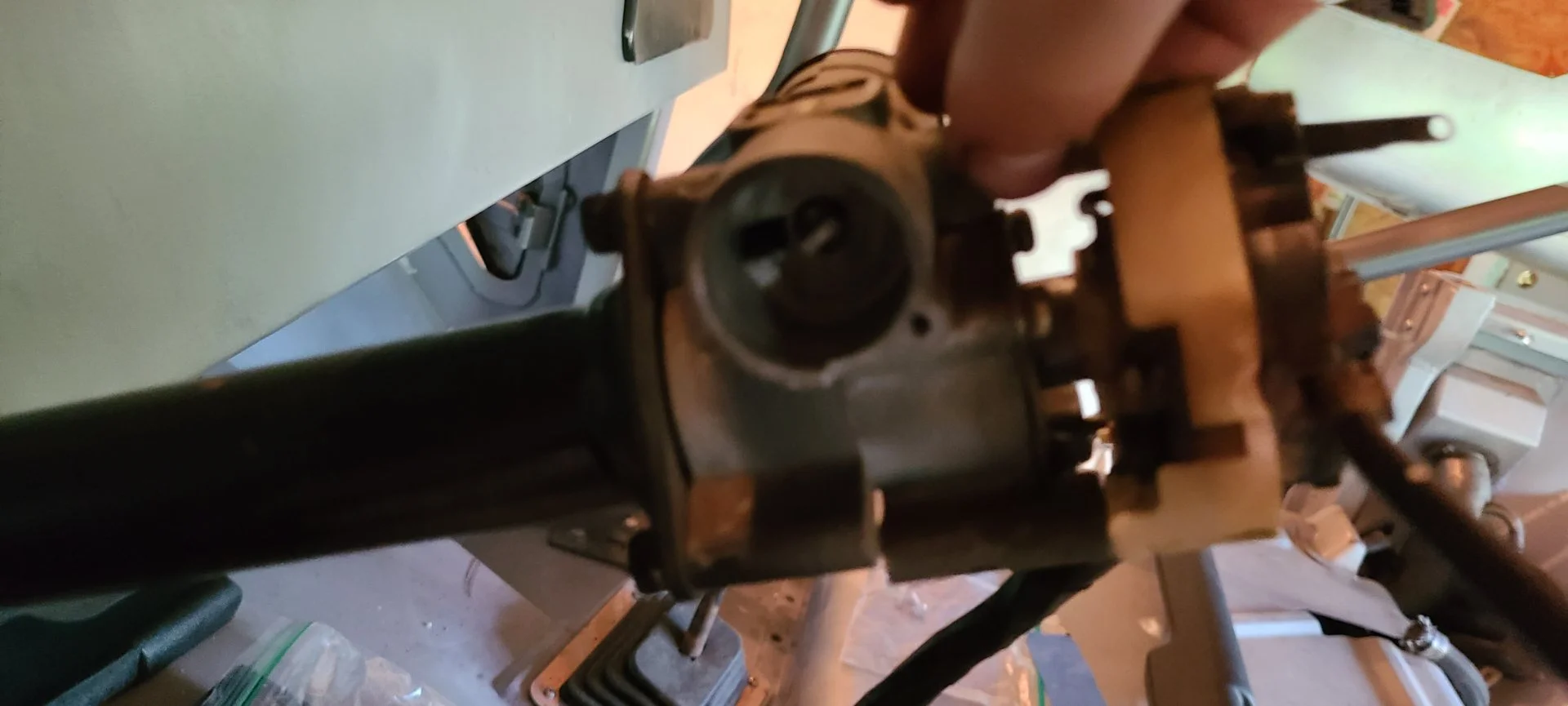

Trying to put together the fj40, finally managed to gather parts strewn across garage for last 15 years, some literally hanging from the rafters...
For the steering column, the ignition switch in the picture looks like it should fit into the cylindrical opening but doesn't -- what am I missing here?
For the turn signal apparatus, looks like it should slide in before adding steering wheel?
Funny, I took pictures way back when but obviously not of the right stuff.
Thanks
Is it not sliding in because the key is in the wrong position? You might try rotating the key while trying to install the electrical.
