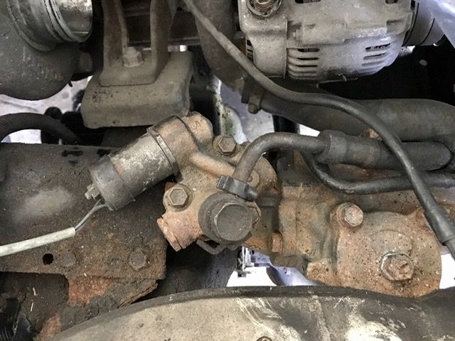

Can anyone educate me on what this is on my JDM HDJ80 Steering Box? It’s definitely not on my FZJ80.
It is a 1990 JDM RHD and the PO replaces the steering box fairly recently. He claimed to have had a helluva time finding one. I would have ventured a guess that the wiring to it was factory. Most of the add-on wiring was done by a drunk 12yr old and is very obvious.
In case anyone stumbles across this later: After some digging I found it to be factory variable assist solenoid that was standard on all European VXs. Apparently. Interesting. Now I'm vaguely curious about whether it would bolt on to a LHD box... Probably best to just leave it reliably simple.
Variable assist power steering
Now I gotta know :bounce:
I have mentioned the variable assist before but it was poo poo'd and apparently did not exist, (of course there was some jealousy driving these comments) anyway yes the HDJ80 steering is feather light at idle and gets heavier when on the move. Occasionally the solenoid can stick, it just wants a change of fluid and job done.
regards
Dave
Now that's interesting. The picture looks to have a solenoid. That would give it two settings as the above post mentioned. I wonder how its controlled. On some GM and Ford vehicles you had something similar. Full power at idle then half at freeway speeds. These were controlled by vehicle speed. I know Ford controlled it in the pump, cant remember how GM did it. I vaguely remember one model of Vett having 3 different power settings. Over 45mph, you had manual steer to give it a good road feel.
OH, as the above post mentions, solenoid sticking and needing a fluid change, yeah. Two fluids most people never change are Brake and Power Steering.
That's progressive power steering (PPS) that 80's came with in some markets.
The solenoid changes the valving on the steering box so that the steering is stiffer on the highway and easier to turn at slow speeds.
