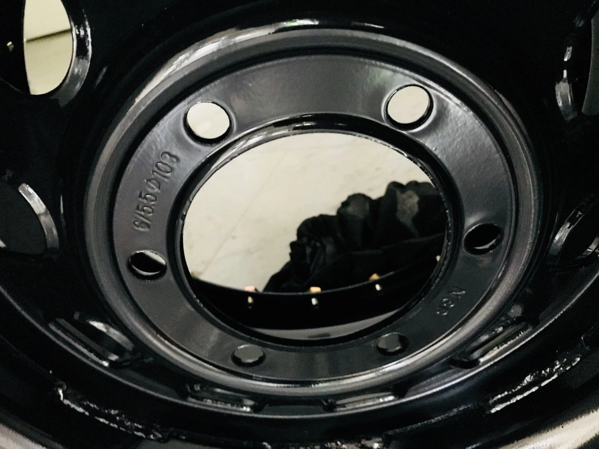

I picked up a set of 16x10 Pro Comp steels and took some shots of the hub mating surface for reference. It's definitely a flat mating surface, but does have these two lips in the inner and outer. I can feel with the tips of my fingers that the holes accept a typical 60 degree acorn lug nut for a lug-centric fit.
I'm hoping to do a test fit unless someone already knows that Pro Comp steelies match the FZJ80 hub. I've seen them run many times, but a confirmation would be nice. The model is 252 series, 6 x 5.5, 108mm, -38 offset.
X3 on the lug nuts.. you can't use shank style on steel wheels and I believe the to is 100 instead of the 88 for the aluminum.

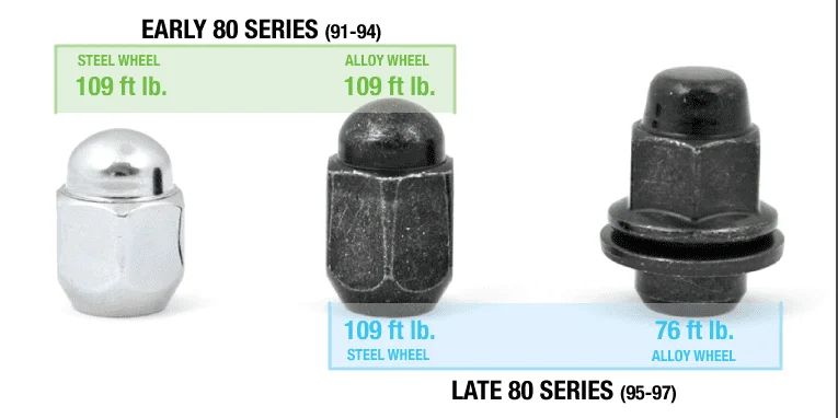

Does anyone know the torque spec for steel wheels on a an FZJ80? 100 ft lbs?

Just wanted to say thank you for posting this. I had typically tightened lug nuts by “feel,” since I didn’t have a proper torque wrench over 100 ft lbs. I thought I was really close. Maybe even over-tightening. But I decided to go ahead and invest in a high quality Snap-On 1/2” torque wrench. I was way off!!! At least half a rotation on every lug nut. Safety first.
