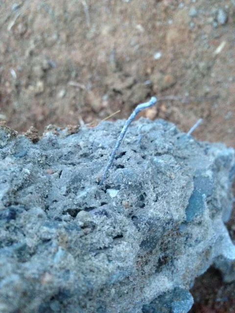

Anybody hear of concrete with stainless steel clips mixed in it, instead of using rerod or fiberglass? My concrete guy says it is the best stuff!?!
It is concrete fibers. If they put enough in to the mix it does take the place of the rebar.
Most of the concrete guys like it because it is less work for them. You pay for it in the cost of the concrete.
Since you have such little frost there the fibers would be a good way to go.
No, not fiberglass, this is actually stainless steel clips, the concrete guy said, like paper clips that lock together in the mix. I have not see it yet, but will post a pic. when they pour.
Pic shows the stainless wire in the concrete mix. There was some thin concrete they skimmed off the floor, when you picked it up it broke, but the wire held it together surprisingly good!

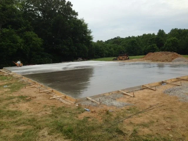

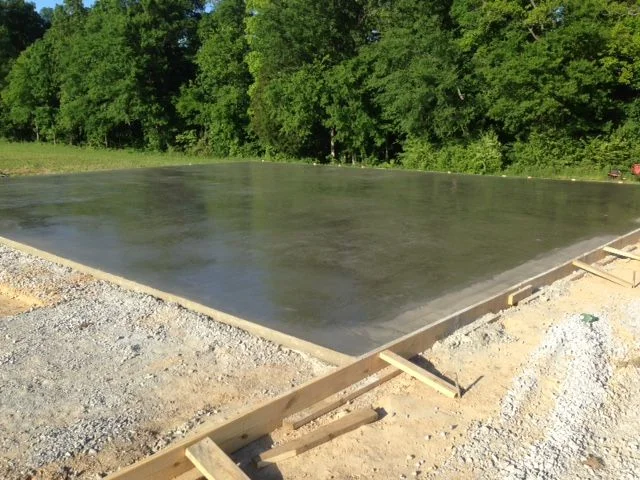

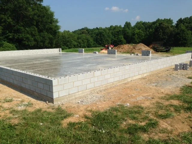

Pics of the left and right side concrete pours and the block after it was laid.
