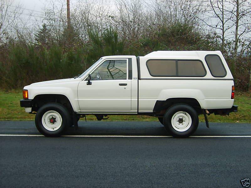

I always thought the base-model mini truck wheels would look awesome. They are skinny 15's and would work well with 31x10.5s, not sure about the offset though.
I agree. I think those would look great, especially on a white 80. Wonder about offset, and how hard they are to find...
