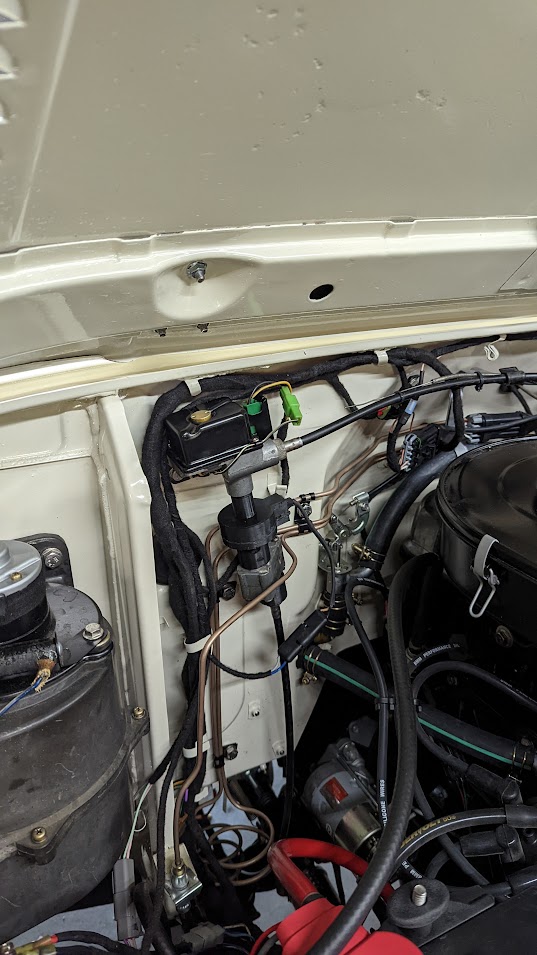

As I had already cut over to the Sniper, the old vacuum emissions controller was no longer on that driver's fender, which was a really good spot for the control box. Also conveniently, I was able to tie into that OEM harness there A green plug that comes out there goes through the firewall to the driver footwell (where the former "brain" lived). There's three wires as well as a 12v switched feed, which is exactly what you need (three for the switches inside, and 12v switched for the brain). From there, you can make a small harness from the plug in the cabin for the switchery on the dash.
I had to make a second harness to cut across to the passenger side, which was the feed for the VSS, the tach signal, and the brake light feed - all are nicely organized as you come across. (I tied in to where the feed runs to the rear for the brake light, vs fumbling under the dash by the pedals). There were existing holes that worked in the fender...and cranked out a TEQ/ND decal just for giggles to make it look a bit more "OEM":
