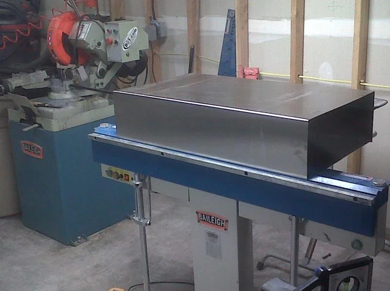

Just thought I would post some progress photos of the stainless steel water tank for my home-built trailer. I need to weld in the baffle and the ends to complete the tank.
I might just have to hook up a 12 volt shurflo pump and go for full automation.

This tank comes in right at 25 gallons, planning on a 15 gallon square tank for the top of a safari rack. I think the 25 gallons would be perfect for the normal family for a weekend of camping. I baffled the middle with a 8x8 section of stainless. My thoughts are that if the total height is 20 inches; that by the time the trailer is moved atleast 10-15 gallons would be consumed and the water will not move around as much. hopefully the one baffle is enough.

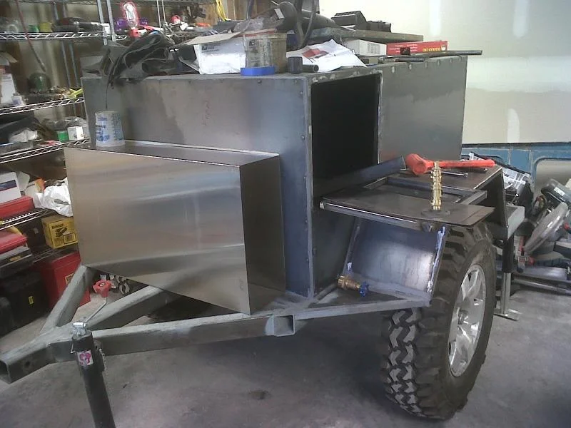

Just the 20 gallon tank on the trailer and thinking about making one for the troopie. I'm trying to see if I can make these and eventually sell some of them. I can cut two 20 gallon tanks out of a 4X10 sheet and hopefully 3 smaller 15 gallon tanks. I hate leaving water in a plastic tank for more then a week in the summer because of the taste, hopefully the 304 food grade stainless will result in better tasting water over a longer time frame.

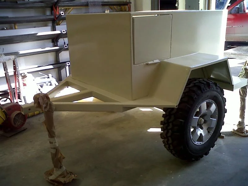

Primed and painted trailer. I epoxy primed the entire trailer and then shoot everything with two coats of Acrylic Enamel Toyota Creme (tan) 83-88 year for a landcruiser. Too bad the trailer has bigger tires then the troopie!
Peter
