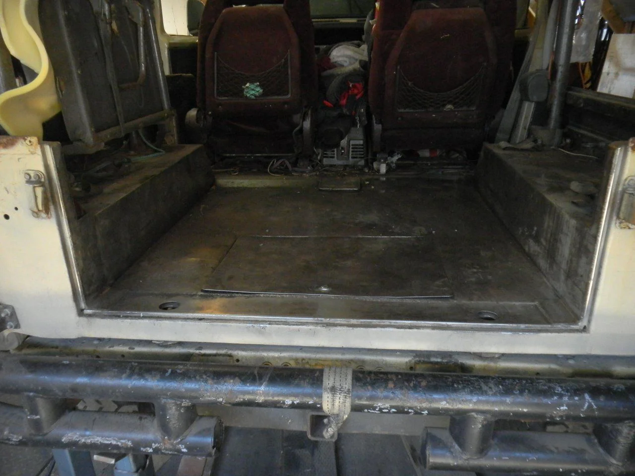

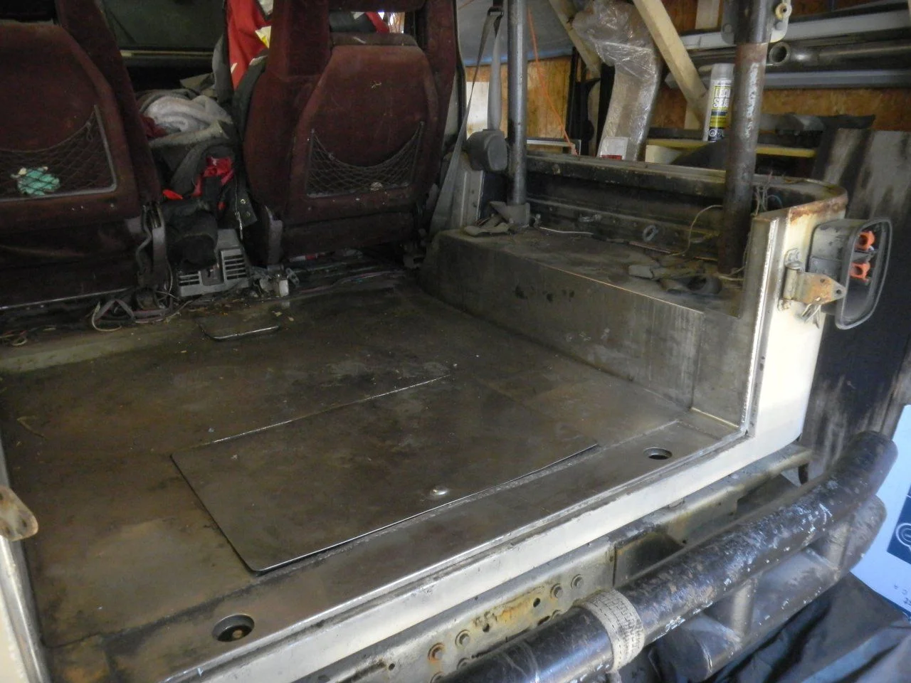

  2. If anyone is wondering how stainless will hold up after 21 years ! well here you go !
    Granted she needs a good wash and as you can see the original metal is not doing good but the stainless is fine !
    What will stay the same is the flat sheet, no ribs in the metal unless I can come up with something or I find someone who can stamp it !
    This is the first gen tub I've done so Obviously I have some revisions and improvements for the next one !
    - like the long weld from ds.to ps. will be eliminated as it will be one sheet.
    - more sturdy trunk lid with proper locking latch.
    - more underbed supports to keep things straight.
    comments welcome

    In the above picture the 1/4 panels are enlarged to accomodate running bigger tires, Rocker is stainless as is the 3'' nerf bar.
