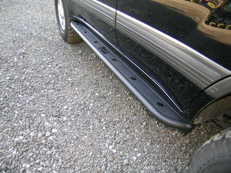

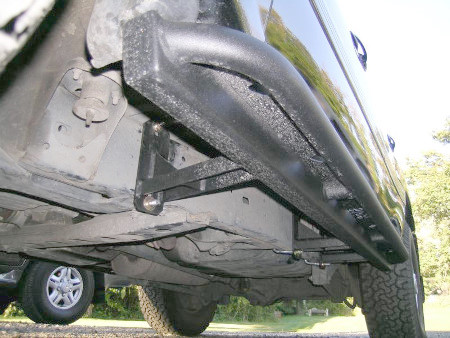

I don't think you can beat the Slee StepSliders for form or function.
They combine a rectangular tube inboard with a round tube outboard and a step plate welded between them.
No connection but these are the ones that will go on my truck.

Yes, I also think Slee's Slidersteps are just perfect. That's what I would install if it was possible, but it would be too expensive to ship them to Spain. If I were going to fabricate them myself, tthat's the design I would clone :)
