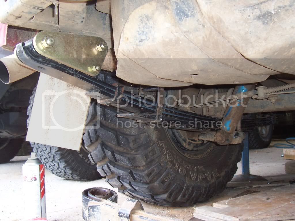

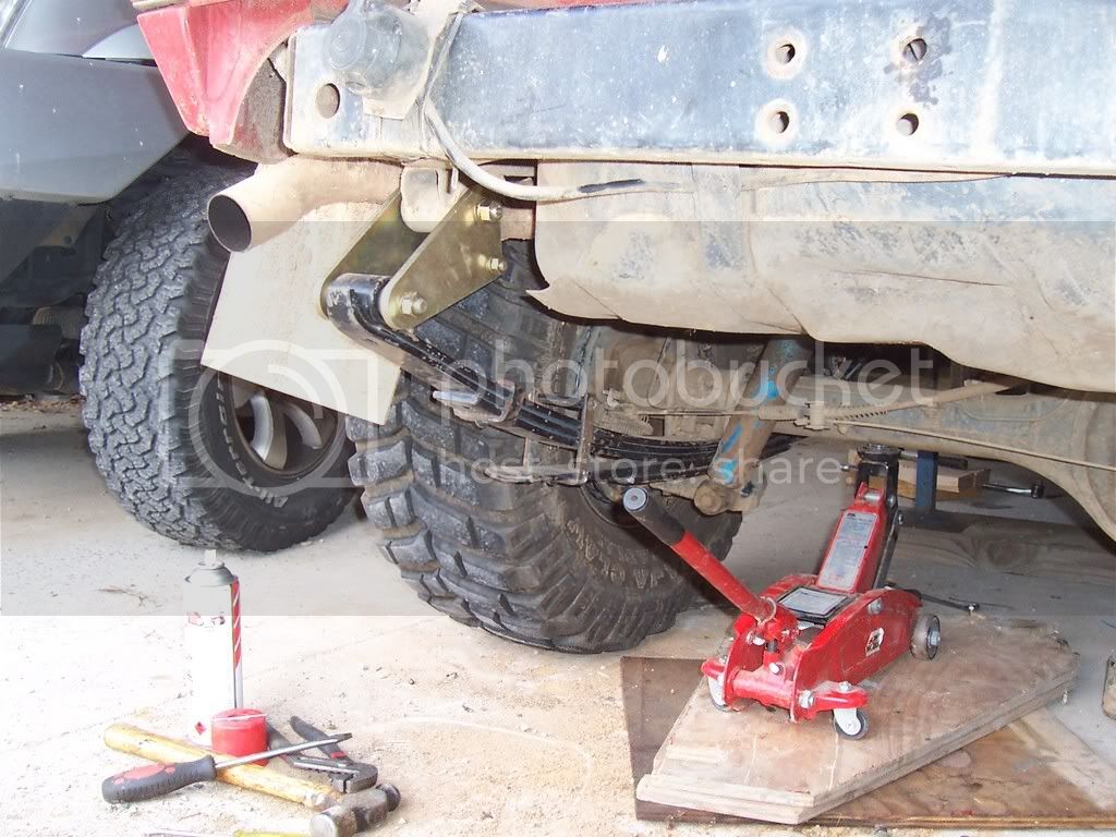

IFS Hilux leaves are within ~5mm of being the same length as 73 rears from the fixed end to the pin and about 70mm longer from the pin to the shackle, with these you will need to run a 3-4'' longer shackle than stock, one problem being hilux springs are ~10mm narrower than cruiser leaves.
See the attached photos from when I trialled them, in the next few days I hope to finish off my RUF and 75 rears into my middy
This is with rear springs up front (60/73 rears)
