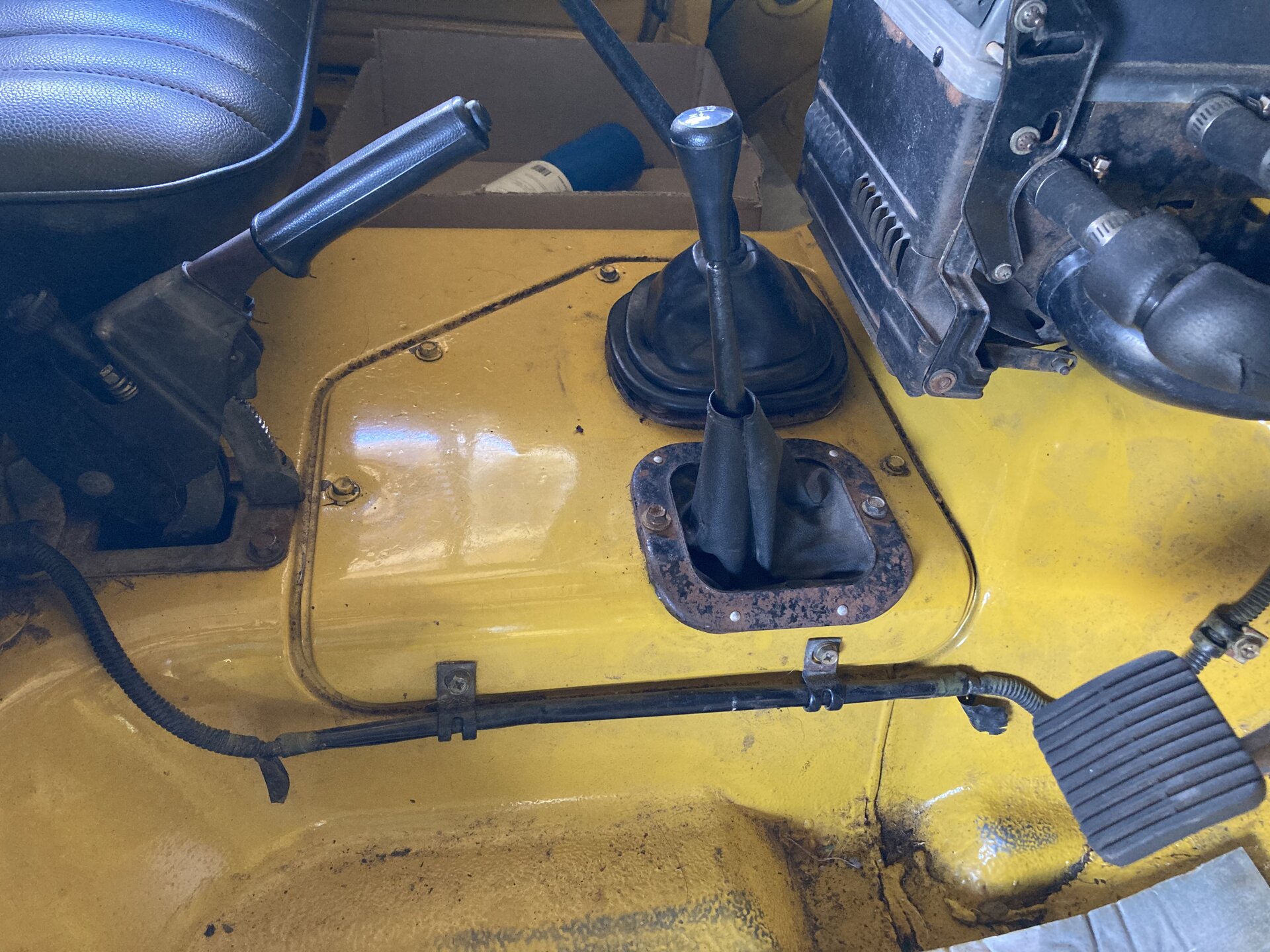

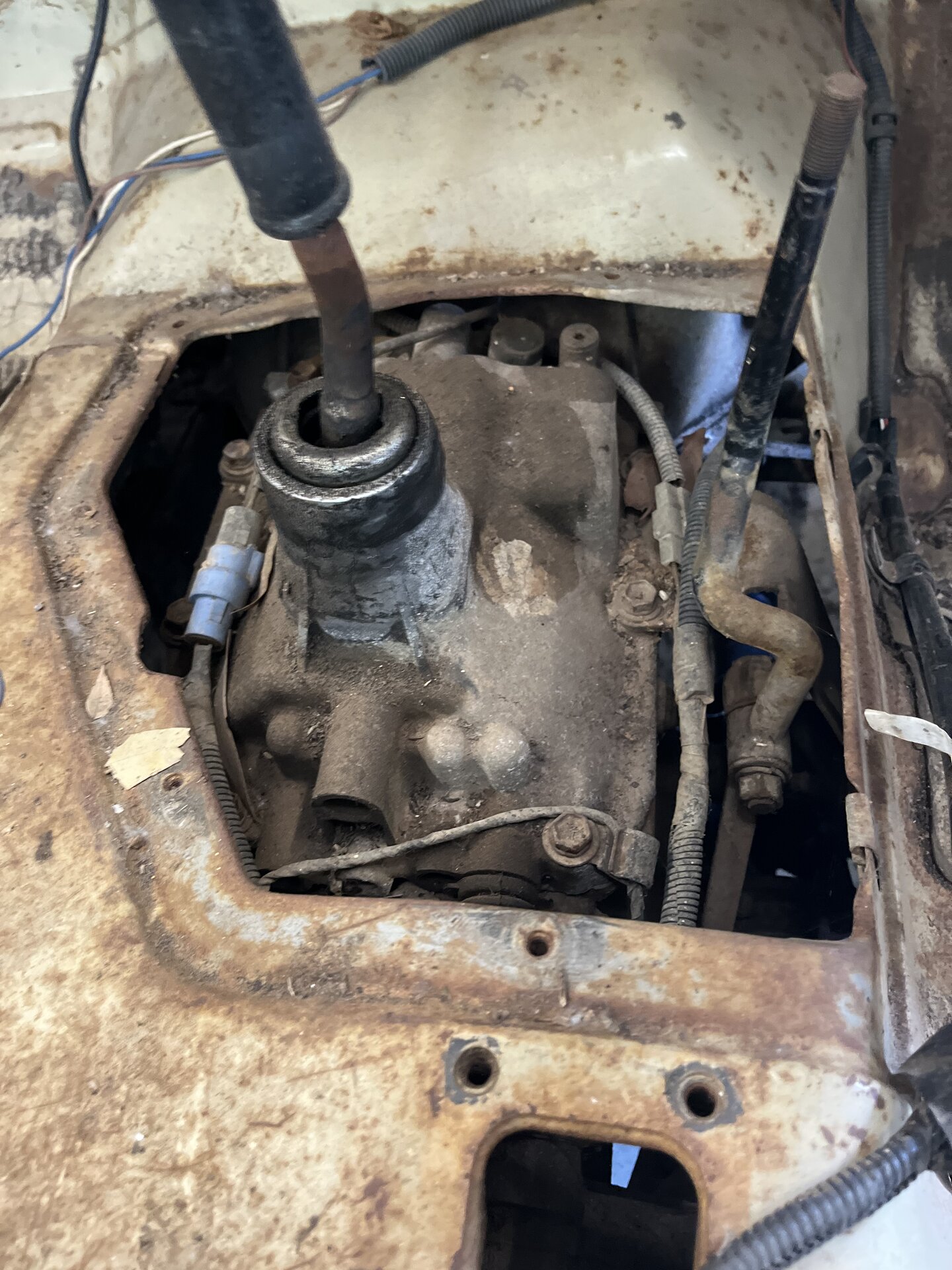

I have just upgraded my BJ40 to split case transfer and matching four speed. Mine was a 4/80 model so have changed to 8/80 onwards.
My transfer shifter is fouling the transmission cover in the H4 and L4 positions.
As far as I know the transmission covers did not change from 79 onwards.

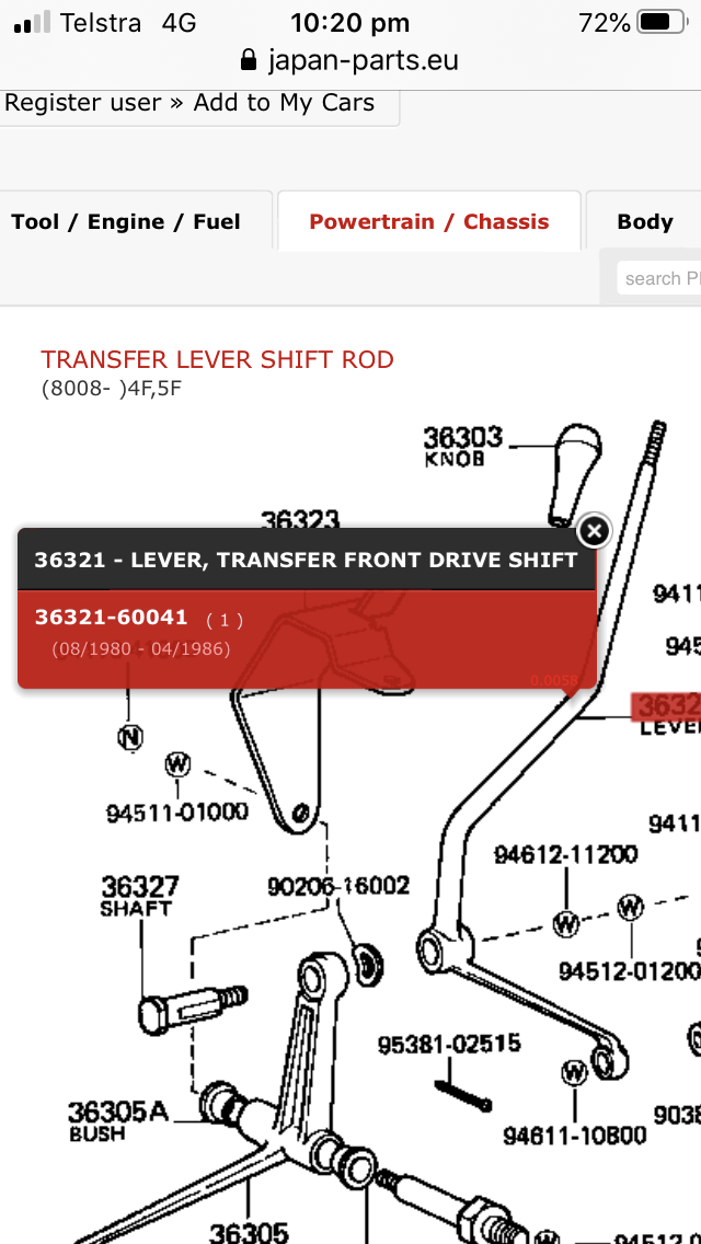

It’s possible I have mismatched the linkages/shifter between the two. Did these change when the split case came in 8/80?
