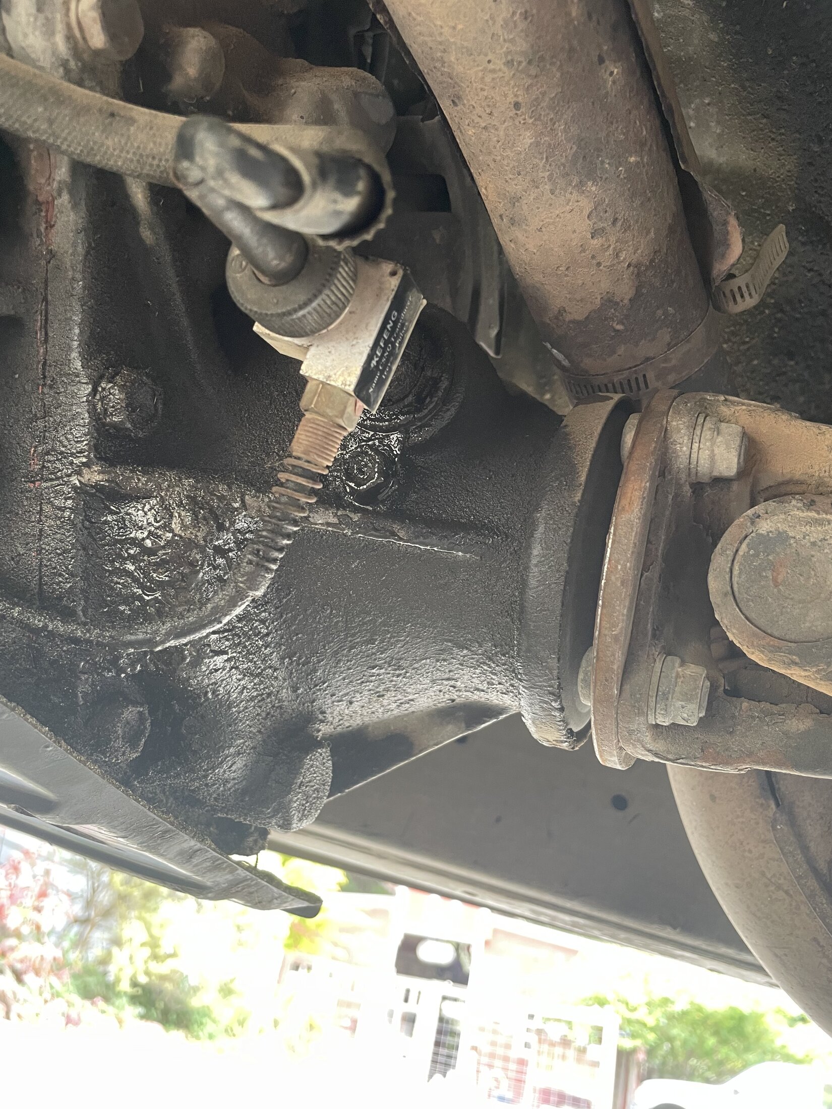

So maybe hard to see but its weeping and thats the assembly that i can wiggle around
If the speedometer started wagging, then went really high, you probably broke your Speedo cable because it needed to be lubricated. Typically lubed with white lithium grease.
Change the o-ring on the speedo gear so it stops leaking gear oil.
