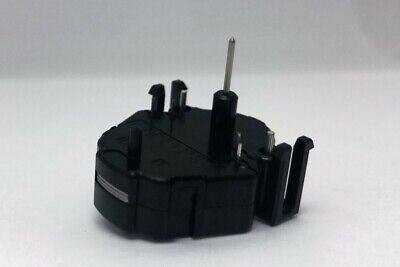

The speedo and tach usually are because worn stepper motor. You could get rebuild service for $300 - 400 or buy the stepper and solder it yourself.
