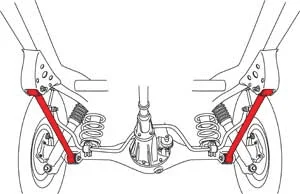

What are the advantages of the SPC Rear Lower Control Arms? I understand it's thicker tubing and less likely to get bent on the trail, but I'm wondering if there's any other added functionality.
For example: Do they offer greater off-road flexibility/droop/articulation? Are the bushings and joints lower maintenance and offer added longevity versus stock? Does it improve road and trail manners/handling after a lift? Are they useful for alignment (on a solid rear axle...)?
The description says "for superior flexibility off road" but I'm not exactly sure how or how much. It also mentions special bushings to isolate axle noise, but I'm not sure if that's an improvement over stock either.

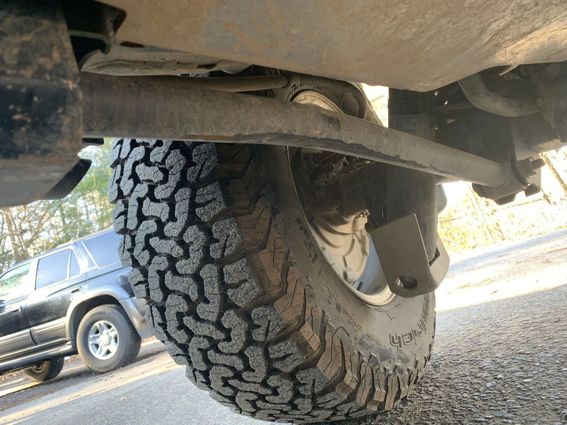

I’ve never heard these referee to as “RLCA” I think they are normally called “lower links”. You can also replace the upper links and panhard bar. I’ve replaced them on my 4Runner after turning mine into boomerangs after a nasty line at Uwharrie. They tend to push the rear axle into a more neutral position after lifting and can help with fitting larger tires. Adjustable does mean additional maintenance (and an additional failure point) and I would opt for a fixed length.
