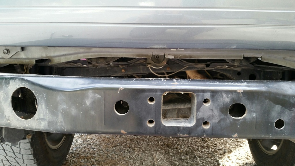

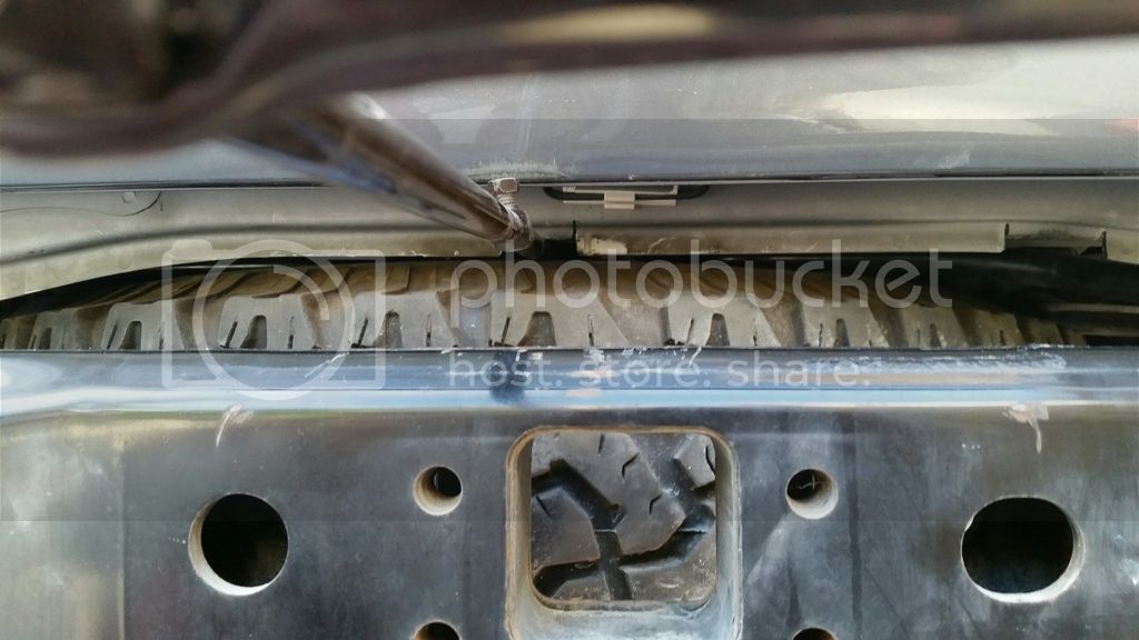

The frame has large holes directly across from where I need to drill the holes. Very easy access to get behind there with a nut. No need to weld a nut on from the exterior. I decided to notch the body where the bar gets really close to ensure I don't smash the bar up into the body. I also notched the body where the winch bar goes through since the winch for the spare tire is now 1.5" higher, I needed the extra clearance. Also allows me to get the tire even tighter to the body at the outer edge of the frame. I will get pics of it all installed in just a bit. Here's what it looks like now.
Here's a pic with the bar installed and finally with the tire installed. It's as snug as I can get the tire. Everything is super secure and the tight. Now I may have one final issue. The BIOR bumper may hit the tire. It will be super close. If so, I will just shim the bar with washers until it clears. I don't think it will be an issue. The bumper will go on tomorrow.
